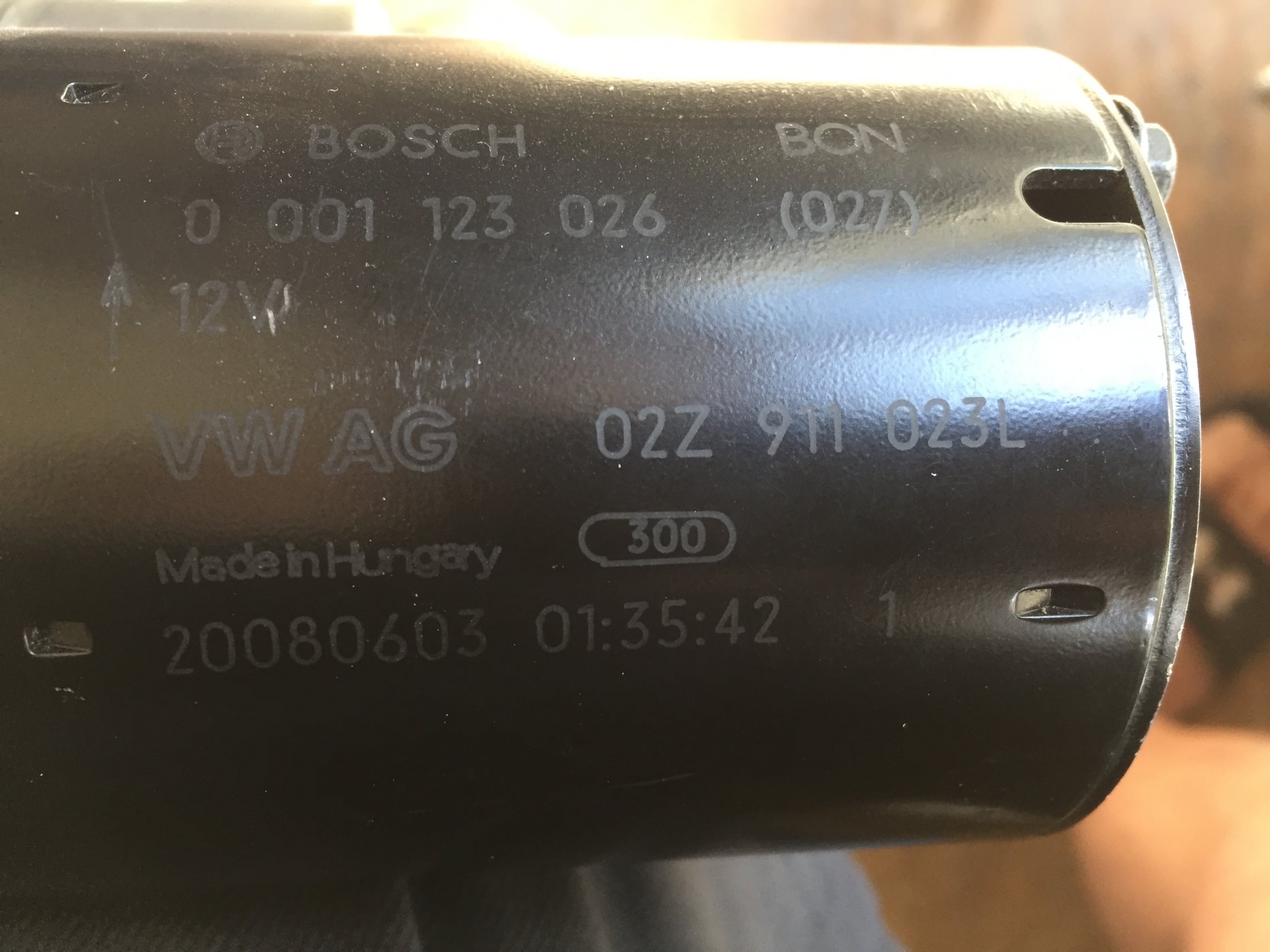

Here is a picture of my OEM Audi R8 starter for comparison. looks similar to yours Dan.

On this subject but not the starter power wire.. I replaced my battery cut off switch with a super HD one for commercial vehicles (3000amp start/500amp cont) and the problem seems to be fixed. I did also replace the starter as i smoked a winding on it trying to start it with "the issue"
for ref I am running the amazon bosch starter, and 1gauge + 1/0 gauge from to back (in parallel, because the 1 gauge was already there and I added the 1/0)
