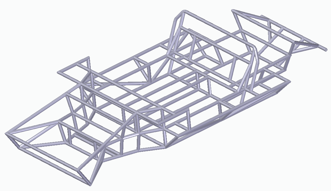

I would run an FEA simulation to understand torsional stiffness as compared to the Prova/Lorico chassis I am using. Here some more info:
Long time since i did some FEA work and never tried this approach;
Are you able to determine the required torque to twist the chassis 1 degree?
Leave one of the springmounts floating, ground one and constrain the last two against vertical movement.

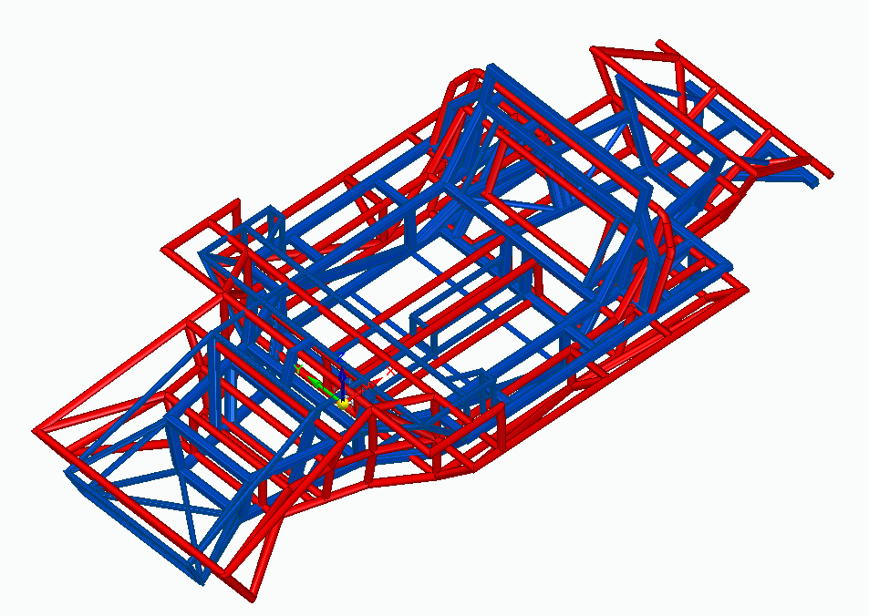

This is made from 40x40 mostly, quite similar to the Prova/Lorico frame I am working on. Unfortunately, I have no CAD assembly of this frame here.
Does anyone have a CAD assembly?
I do have a second design in CAD that is made from round tubing:
If anyone has more information, please let us know

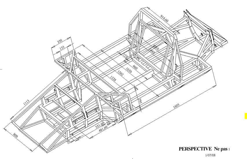

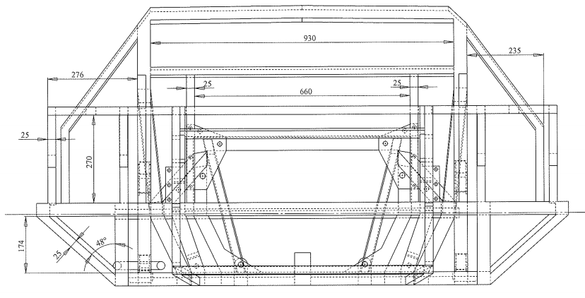

Thanks for sending this to me.
those images coming from this build on this forum ...... from France
Thanks for the link.
So far, I have two different GT40 frames in CAD. They are quite different from each other. Unsure if the red one (all round tubing) "is real".
