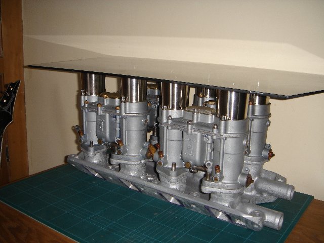

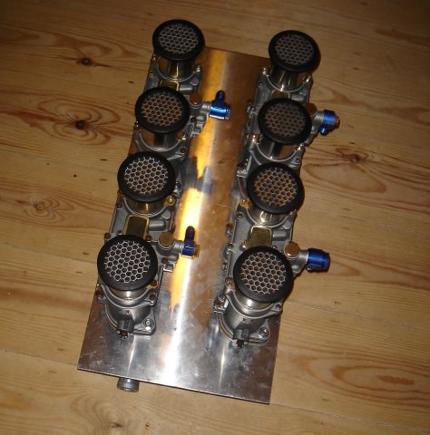

Finally got some lumps of metal which are being used to make my coffee table. I want it to be as original as possible to the ones I've seen in that car that won Le Mans 4 times in a row, although why someone would want to power a car with a perfectly good coffee table is beyond me........

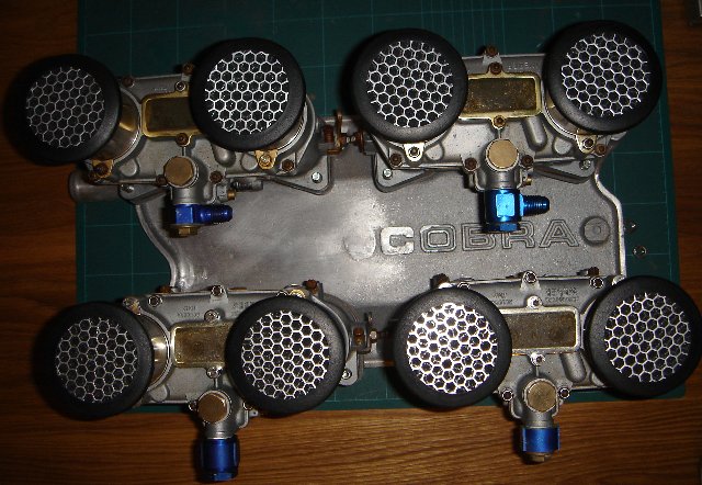

Just got the top end of it in the picture and also the bottom, just waiting for the middle bit and stand to arrive.

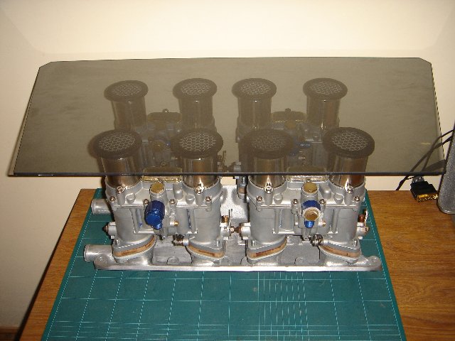

I've got a piece of smoked glass for the top but found that it slides to easily about so have ordered some rubber screens to rest the glass on (see pics) which should stop the glass sliding. Also think the table will sit a little low so have found some 'phenolic spacers' (whatever they are.... ;-) which will make the table a little higher, they should arrive soon.
Slowly replacing the nuts on those grey things with the stacks on them to stainless steel, including socket head SS for the gauze cover and stacks. That lump of aluminium they sit on is also going to get a polish.
Someone mentioned that it might be nice to have some words to read on the table as a conversation piece so found some lumps of metal which say 'Gurney Weslake' which will be put on the big lump of metal that will make up most of the table.
I also think that some nice shiny braided hose would look nice to join up all those weber things.......
Wadda u tink?

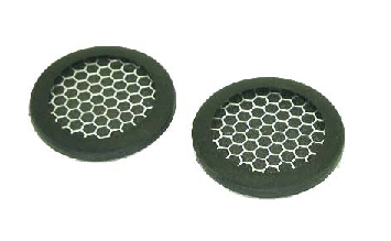

Just ordered these for the 'coffee' table......... should be with me in a week or so, had to call california for them..... wherever that is...lol
BTW have heard that the screen can cost a few HP as they restrict the air flow, my tuner man said its best to tune the engine without the screens and then put them back on after tuning, anybody chip in on this? I know that bare carbs are best for power but worst for engine wear and Im looking for about 300 HP so the screens should still alow this in a 289 engine with some (not much) but some protection from debris......

ingenius lightweight coasters. the silver stirrers have helixes to stir more efficiently and the other end for better grip.
the mesh keeps insects out of the cups during polite conversation and you have even provided a shaker for the powdered chocolate.

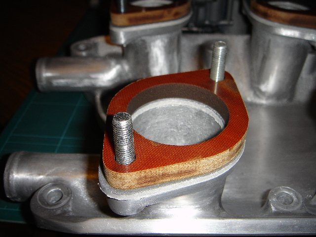

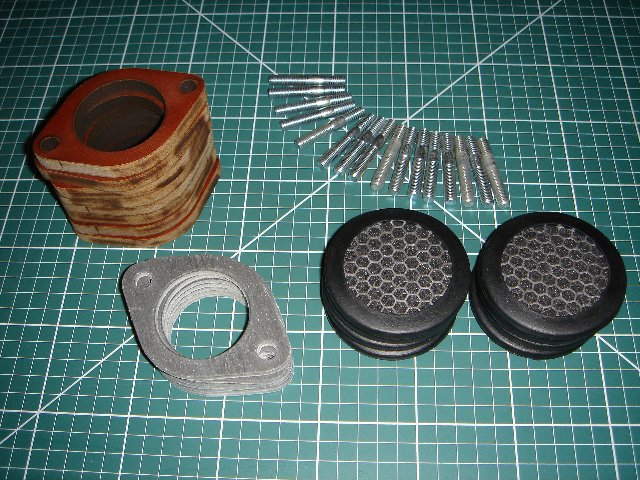

The first shot is the parts that arrived
8 x studs
8 x phenolic spacers
8 x paper gaskets
8 x stack screens

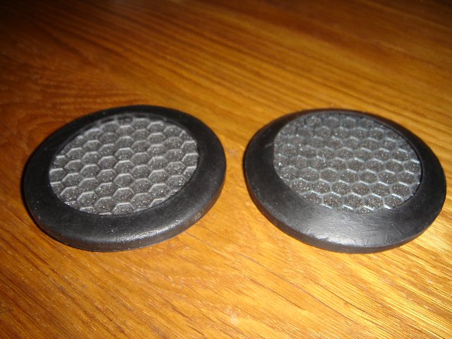

The second shot shows both sides of the stack screens... they need to be left in hot water for 30 mins before putting them onto the stacks.
The studs are shown in place on the inlet in the next shot and there is ample stud to allow a 3mm aluminium plate for the cold air box.

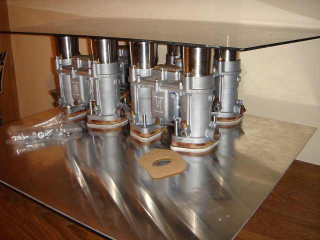

Finally shots of the completed article....
Looks like the idea about putting on those screens worked the glass dosent move around anymore and the phenolic spacers make the height of the table... just so..........
Next item is an aluminium plate for the bottom of the cold air box..... maybe I can keep ice in there?

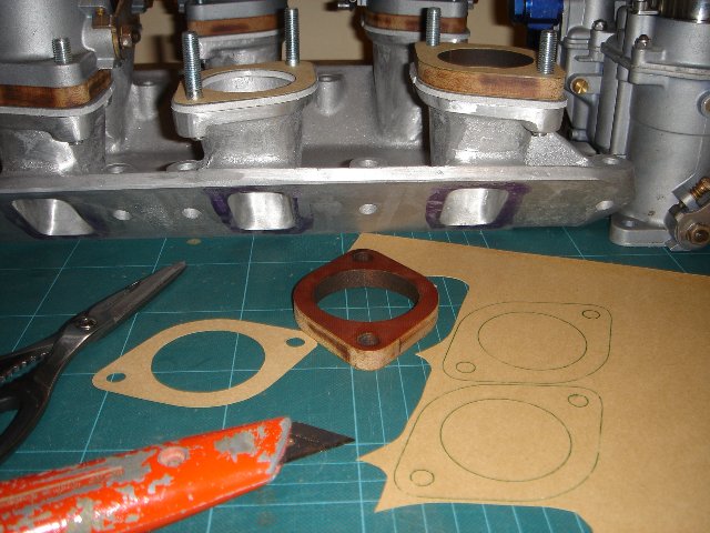

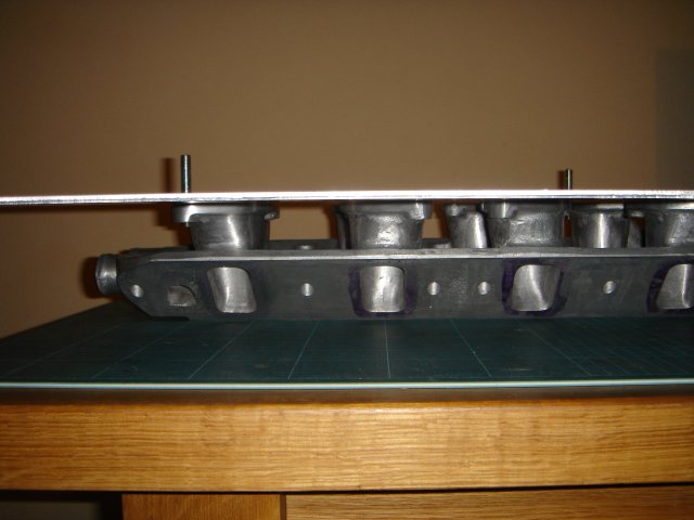

Cutting gaskets as the aluminium cold box plate also needs to be fit between the carbs and the inlet manifold. Gasket material is 0.4mm thick.
The phenolic spacers come supplied with 8 x 3mm thick gaskets so I am cutting another 16 from the paper to allow a gasket in the following order...
48 IDA base
0.4mm gasket
Phenolic spacer
3mm gasket
3mm aluminium 'cold box' base plate
0.4mm gasket
inlet manifold

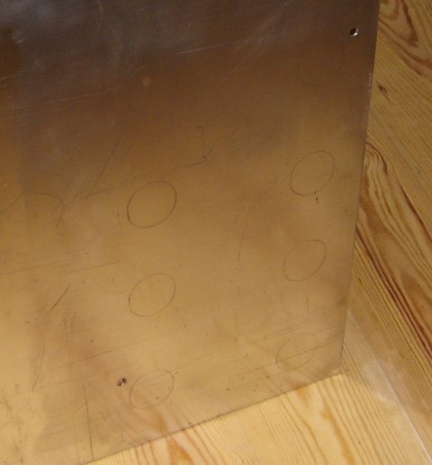

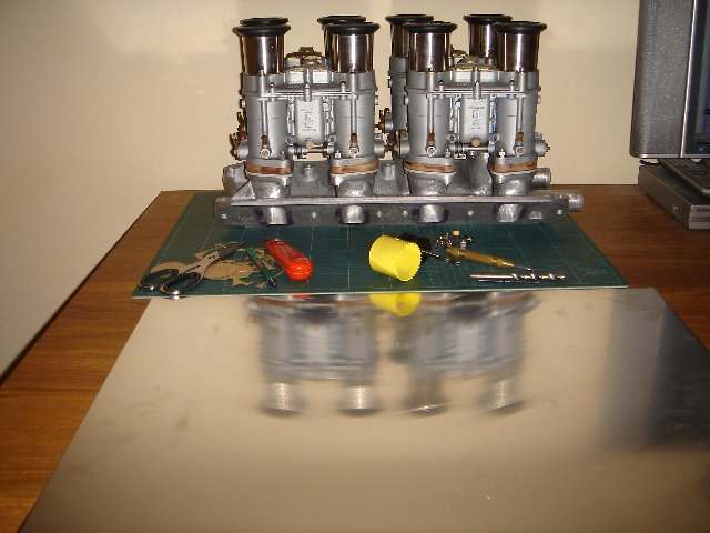

....went to a local metal supplier and got a piece of 1/8" thick aluminium for the cold air box bottom plate. Oh and also got some 5/16 UNF stainless steel washers and nuts to attach the carbs.
Also bought a 48mm hole saw and correct size clearance drills for the studs.
Now all I need to do is correctly mark the hole positions and drill the holes to match the inlet manifold.
(The edges will be left 'oversize' untill I get my hands on the short block and heads, then it will be 'trimmed' to the correct size including the recess for the dizzy.)
Could be a long evening...... wish me luck.....

May I recommend that you get those holes cut with a vertical mill and a fly cutter or a boring head. Accuracy ?
My motto is "less haste = less cash"
Doc Watson
The plate was £5 so I plan to try it in the next hour or so.... I do have a vertical pillar drill which is man enough for the task.... depends if I am!! its been a few years since I worked in a metal shop.

Doc Watson

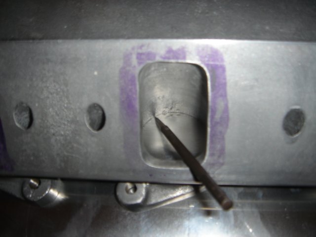

Two opposing holes first.... bolt the plate on.... scribe inlets.... checked scribed marks.... put back together and a new shelf for the table.
Next I need to find the centres of the carb inlets and try out the hole saw.
Andy

All stud holes are now drilled, just the 8 larger inlet holes to do.....also trimmed the plate using a jigsaw, I'm leaving the front and back oversize to be trimmed later. Now with the base plate and carbs secured I can look at the linkage system.
Andy

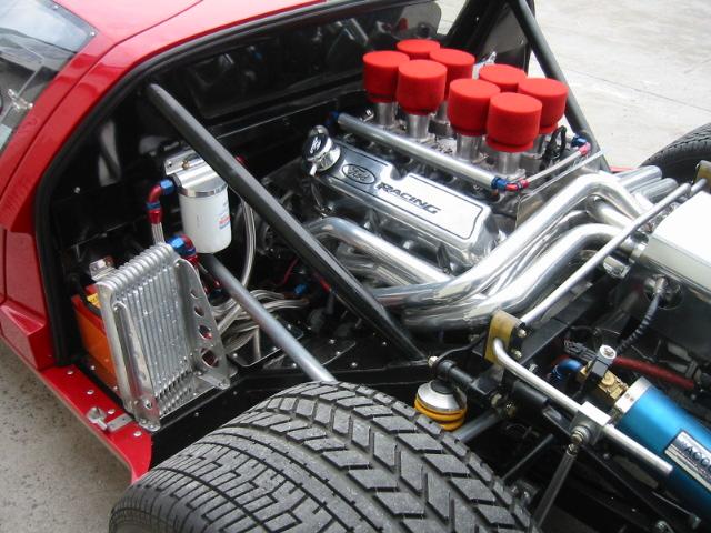

Doc, re the stack filters they do restrict HP but for normal (non track) driving I doubt you would notice the difference. I had them on my gt and the filter material in the centre of the mesh sandwich developed holes and was either sucked into my engine or blown into the air after about 200K.
I have resorted to the ugly socks pictured until I can find another solution.

Doc, like you & Pete, I first tried the Inglese filters. A total failure - my trumpet tops were 3mm smaller in dia than the filters were designed for, but after 20mins of driving, 3 of the rubber rings had split. Not only that, but a couple of coughs & spits destroyed the fine filter material on 3 of them.
They went in the bin !
I ended up running the socks like Pete for rego (to cut back on induction noise & spit-back H/C problems), then got a bit peeved about comments regarding my "red condoms" ! So for the moment, I am going "naked" & hoping to find something that keeps leaves / twigs / stones out, but still looks the part.
