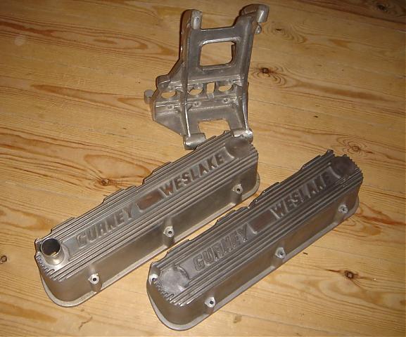

Doc Watson
I like aluminium......

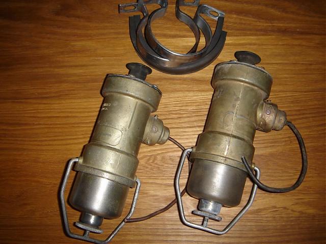

Doc Watson

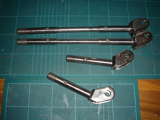

Got hold of two of these from a friend across the pond.....

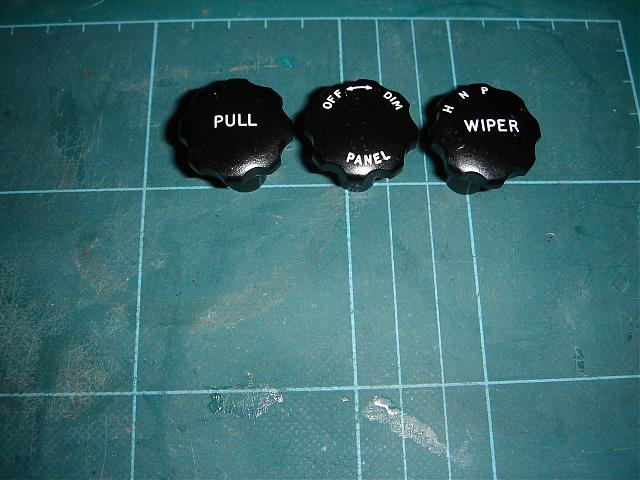

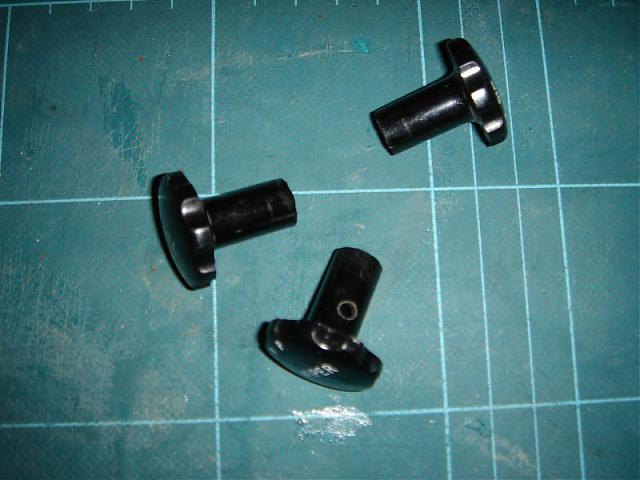

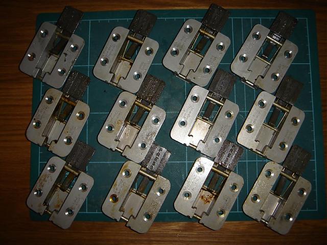

Moving on......
Hartwells and dash knobs..... and thats grease on the Hartwell latches and WD40 not rust.......I think I ordered to many ;-)
Engine was supposed to be delivered today but was delayed (AGAIN) so the coffee is on hold...... glacial progress.......
Andy

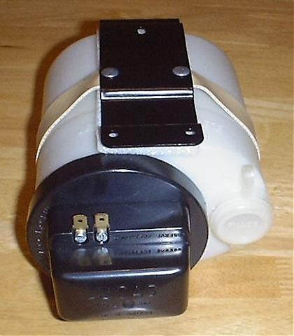

Doc,
I have the bottle pictured below that I might be persuaded to part with since originality is not huge driving factor with my car. It is mounted and in use at present, but contact me if you become desperate for one.
Lynn

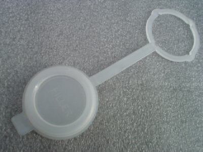

Found a new bottle top..... and located a correct motor but they are not cheap....
As always answer 1 question 3 more crop up.....
