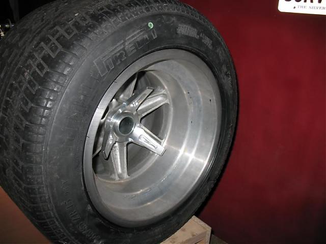

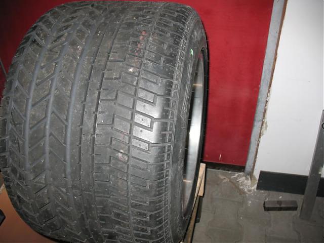

Anyone out there having experience with them on a racetrack ( not strip). How do this purposemade tires hold up, as the compound seems to be very sticky ( soft) and is just 6/32" thick, my gues is the lifespan will be very short. The rear tire diameter is realy huge (a full inch larger than the already huge bluestreaks. If it fits, this dimension should make a very periodcorrect look. Also the price is great ( my pirellis cost more than double of that).

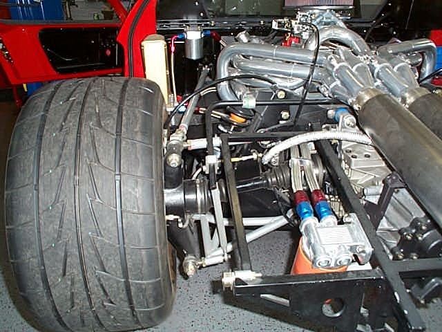

Here's how they looked on the Cobra. 325s in rear and 275s front.

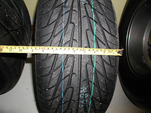

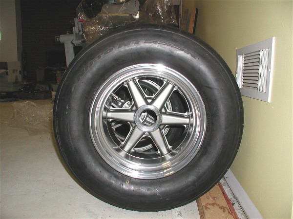

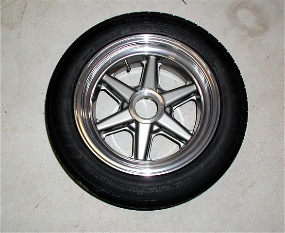

I just got mine the other day from Discount Tire. They get them out of Ohio or California. Takes a couple of days. They look great. My price was $695 including tax. That included mounting and static balance. The 555s are 13" wide on the 10" rim. the 225s are 9" on the 8" rim.

Bill, I think you were concerned that the tread patterns would be different, but they look very similar, don't they? Let's see a pic when you get them on the car.

they look great, will be interesting how they work. Do you plan to widen the rear rim, as i think the tirefit on a 12/13" rim would be much better and also help to reduce the sidewall flexing.
