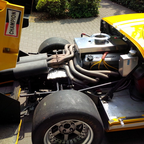

I’m leaning towards the Holinger MFT 6sp sequential. It’ll fit an SPF.
Older pic, but you can see it fits in a GT40 pretty well.

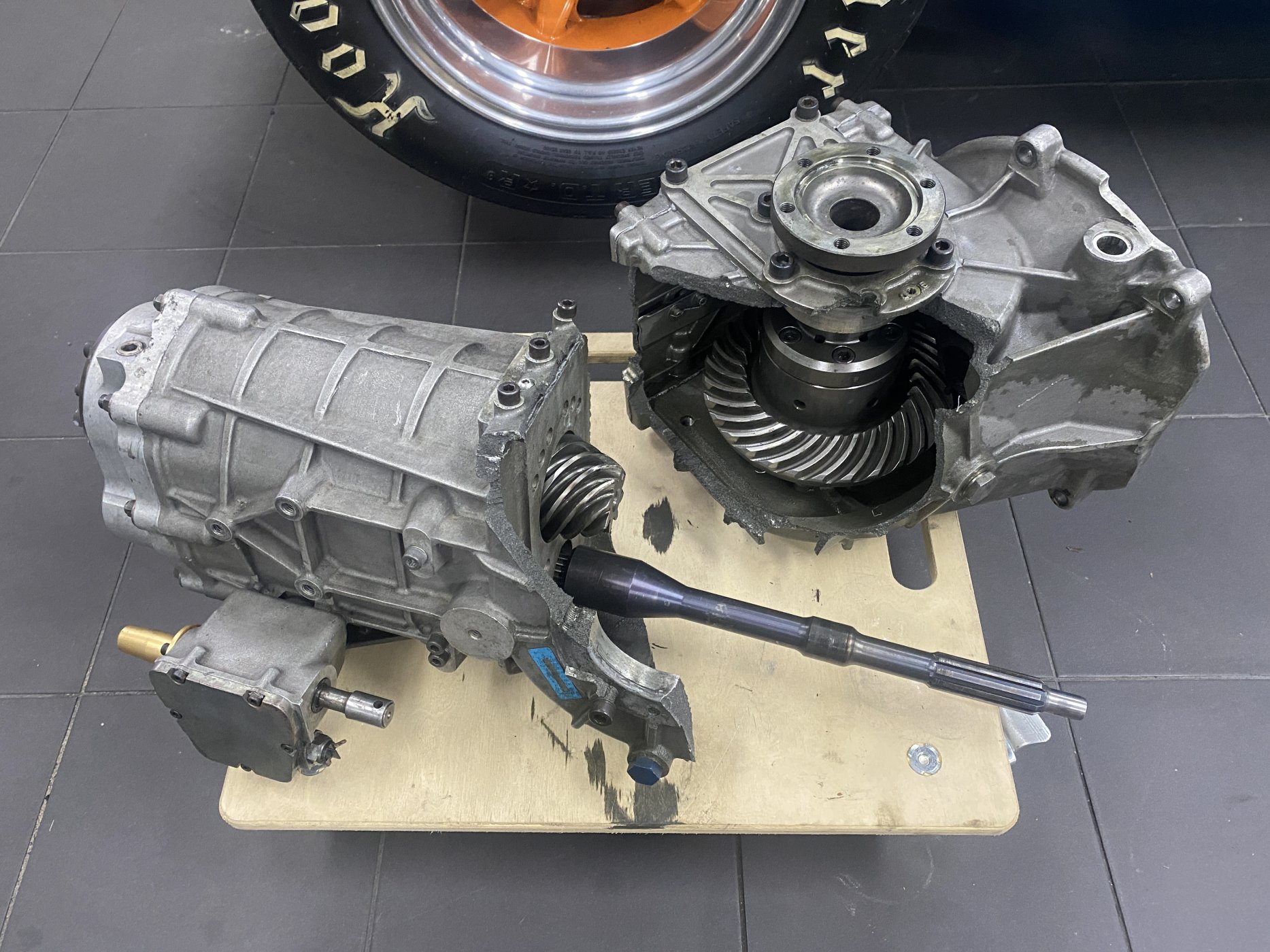

As there is no warranty from Quaife this can be sold off. All the internals are new so good for spares. The ZFQ isn’t strong enough for a track.

And a 2 piece case . Sorry I couldn’t resist. Hopefully you find a transaxle that will handle the abuse of racing and still fit within the confines of your car.
Regards Brian
Davidmgbv8
So I just finished putting in a Quaife one piece mainshaft in my UN1, so why would they not do that on their own design as I would think that would be stronger?
