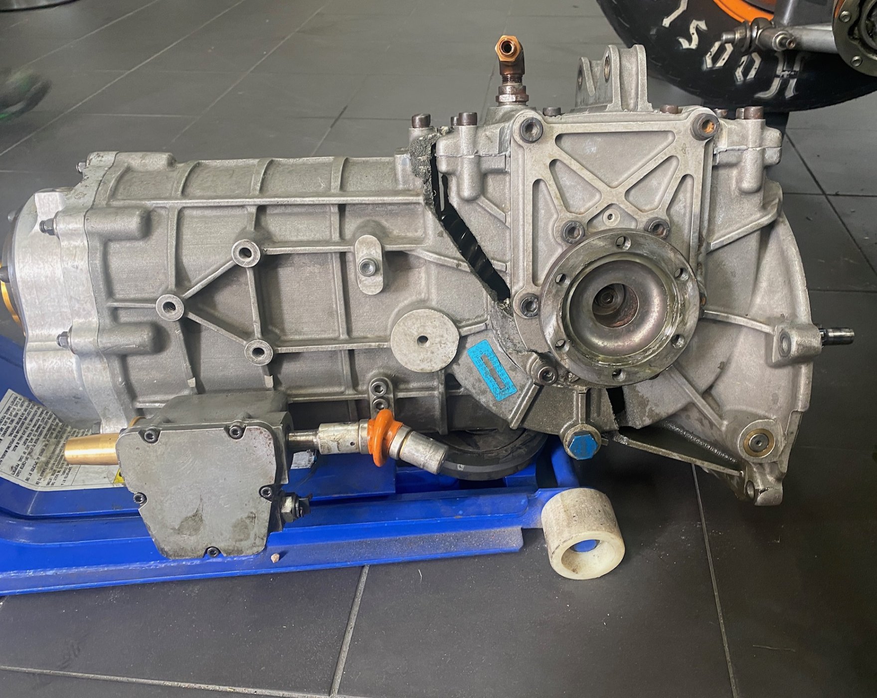

Can anyone have, or put in a SADEV SL90-20 trans for a GT40 car just for track? I believe some GT40's have the SADEV SL90-20. The ZFQ/RBT ZF has had too many failures on my car and like many other's, who have experienced the same fate from using the ZFQ/RBT ZF. My car has a 302 Windsor, Webers, with 495bhp, 420ft/lb. I did two laps before it broke, gearbox engineers have told me a ZF will last only two laps, it's a common story. And always breaks on the upshift NOT the downshift. The car will go on the stands until I can find a decent trans.

The Quaife ZFQ box has had numerous refurbs over the past 10 years, the recent refurb was done for the gears, mostly synchros and 4th gear. After having that done that at the next track day, the diff blew, when apparently a carrier bearing for the CV fell apart so the diff was completely rebuilt by a Quaife tech. So the ZFQ was pretty new on the insides, I only had a few laps at Eastern Creek to test it before I took it to Bathurst. Two laps in the case broke in half. I'm still waiting for an analysis of what happened. In the mean time I am looking for a better option.

Could the case have been damaged when the diff blew previously? I feel your anguish over repeated failures. I gave up track days after twice breaking 4th gear on my RBT. I'm not familiar with SADEV, but going to a non synchro box with straight cut gears should be more reliable.
