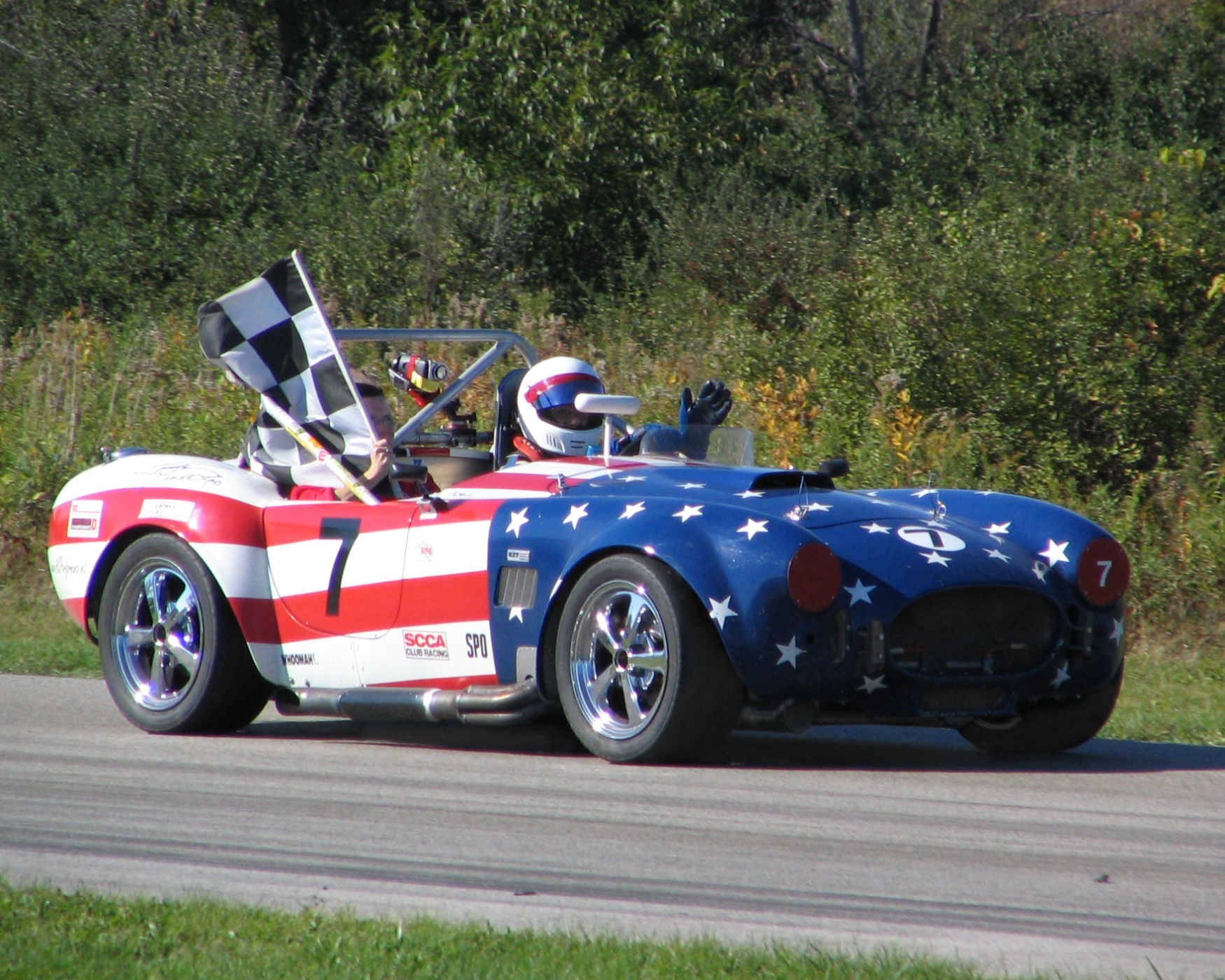

My own personal opinions follow -

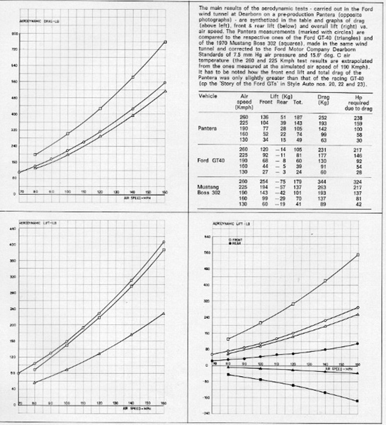

Power to weight ratios were a lot closer than you think. Aero plays a large role even on a short track. You get an aero car like the GT up to 100mph, that downforce sticks that car much harder than the Cobra. The Cobra windshield created downforce at a tremendous aero drag - hence the Lemans fastback versions and then the later “stretched” Daytona Coupe..
I have not raced a GT40, but have raced a Cobra (replica) with a speedster windshield.
