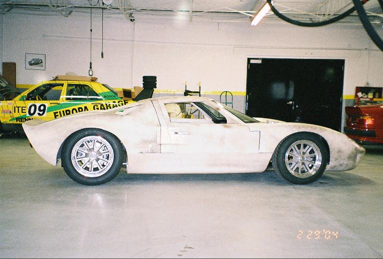

and will attempt to post one of the car wearing a set of Team 3 16inch wheels.
pic ...ooops try again
Alain, How do you like the Team 3 wheels? Did you buy the center cover with the wheels and, if so, how does that look?
Did you buy the wheels direct from Team 3 or one of the distributors?
thanks
dave harris
I ordered them through Richard Oben at North Racecars.
Richard buys quite a few wheels from Team 3, and it only took a little over a week to get them.
The pic doesn't show it very well. (I don't have a digital camera),,,but they do have the bolt covers and they look great.
I used to have PS engineering wheels on my cobra, and the Team 3's have a much nicer finish on them.
fronts are 16x8 with sumitomo htrz 205/55,,,
and rears are 16x9 with 255/50s.
I thought about it for quite a while and am very happy with deciding to use 16 inch wheels.
I just don't like the low profile look that the 17s have. They look "out of place" on a 1960s period car in my opinion,,,,,
and since trhere is no decent Z rated street tire available in 15 inch,
I decided to use 16s and give up a little rear width (the widest I found was 255), but keep a decent looking sidewall height.
The tires were pretty reasonably priced too.
