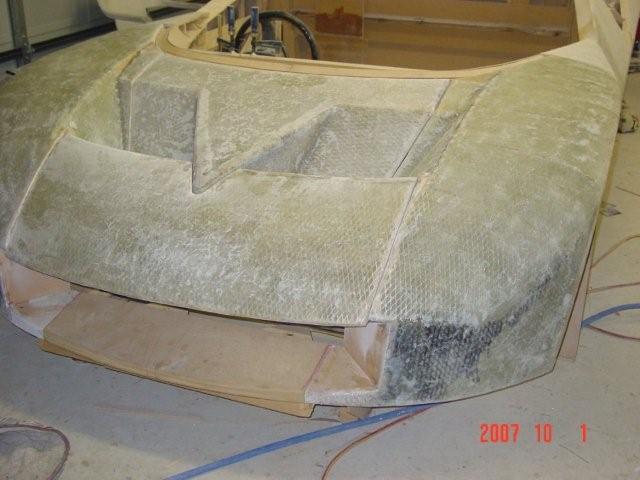

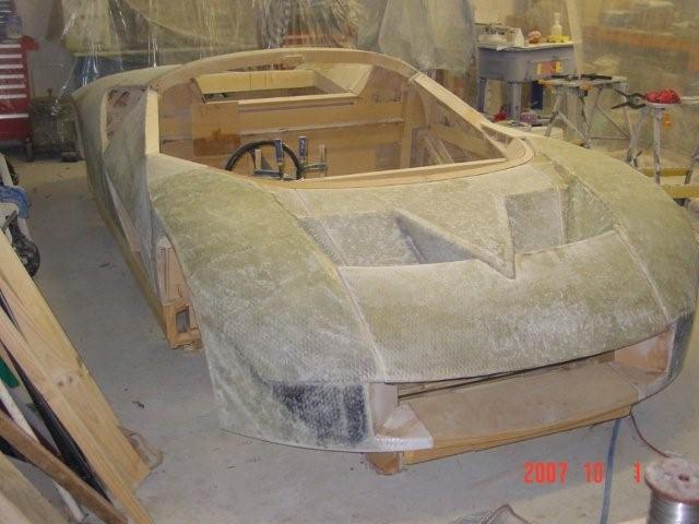

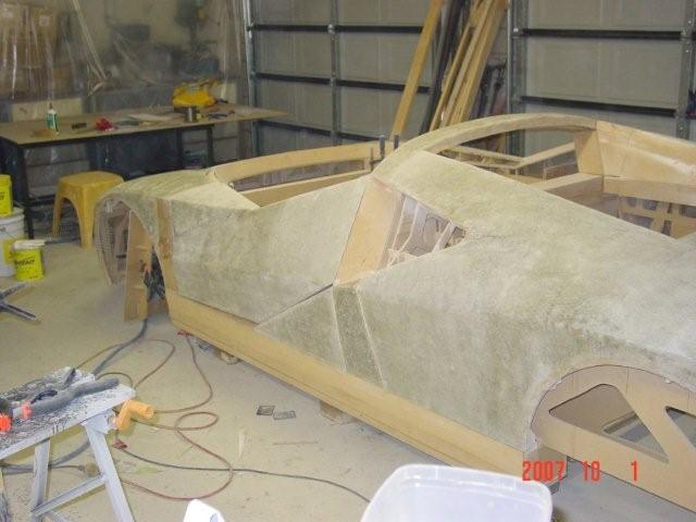

It's expanded aluminium that has been rolled flat.
Sorry no new pics yet, been "snowed under" with my main business.
Front guards and sides of arch now skinned and rough sanded
Had to change one of the "lines" from wheel arch top to indicator light before skinning, I was not happy with how it flowed.
Black is one of those "seemed like a good idea at the time" things.
I had marked the lights and ducts on the mesh while doing the line change and did clean it off, resin subsequently dissolved and bled the black, oh well live and learn.......

neongtsr
sounds good, would have to kick the grandsons out first though....
mark
similar to moulding
basically - make a positive, take it to glass m/f and they create negative (mould - tooling) and then they heat shape the glass to the negative
this applies for screen, roof, door tops and engine cover
screen itself has to be laminated for rego here.
hth
