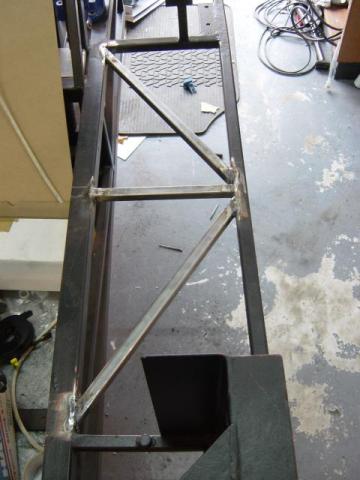

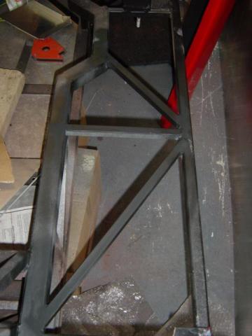

Dave,
I would be interested in seeing some pics when you get a chance. I have
been thinking the same thing WRT the sills and extra bracing. I also wonder
about any extra bracing for the floor pan? Anyone else consider this?
Here's my Roy Smart GTD chassis and the mods Roy and myself did to the sills.
