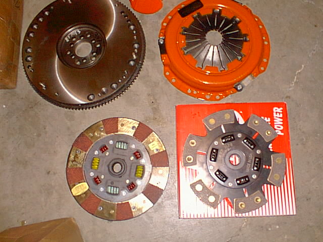

I have located a clutch Kit (with help from Howard Jones) that seem to be perfect fit for GTD original flywheels. I found out my original Lotus stuff that came with the kit were as good as GTD granada brakes. I think Lotus rates them for around 130 ft/lb of torque!!
To make long story short, here is the info. Centerforce DualFriction clutch for the Delorean is rated for 305 to 325 ft/lb of torque (quoted by Rick Mard at Centerforce). The clutch Diameter is 9 1/4" and it is 21T spline. The troque rating can be upgraded a bit more by using a 6 Paddle clutch disk from Clutch Net
http://www.clutchnet.com/
Clutch Net is recommended by Centerforce for off road racing.
No drilling or modifications were required on my original flywheel, it is a perfect fit!! I purchased mine from a place in LA, CA. They have indicated a $20 discount on kits sold to the Forum memebers (I was offered the $20 for my services, I declined /ubbthreads/images/graemlins/crazy.gif).
Below is a photo of all the stuff. The 8 button disk is what comes in the Centerforce kit. The 6 button/paddle is what you have to buy from clutch net If you realy are serious about braking your CVs /ubbthreads/images/graemlins/grin.gif
YES, I know AP is THE best, It is used for the Ferraries (wow). But here is a cheaper option that "may be" (dare I say) "ALMOST", " a notch below" AP kit. /ubbthreads/images/graemlins/shocked.gif

Out of curiosity, is the GTD flywheel a prorietary item? Why\Was there difficulty finding clutch kits to fit the flywheel?

Hey Tim, I have been told the flywheel is an English Ford V6 drilled to accept Lotus clutch bits. You can not fit anything beyond 9 1/2" clutch (maybe 10", although I have never heard of one).
