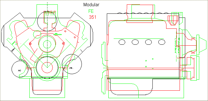

You might find the attached useful in that we know (I assume) that at least one these does fit; perhaps people can tell you where the bigger ones don't fit and hence uncover any issues with the V10 indirectly.
In the case of a Superformance GT40, the 351 and FE both fit, although the FE is at the limit in terms of length since the water pump pulley protrudes forward beyond the firewall. And the modular, I believe does not fit but I don't know where the collisions are.
