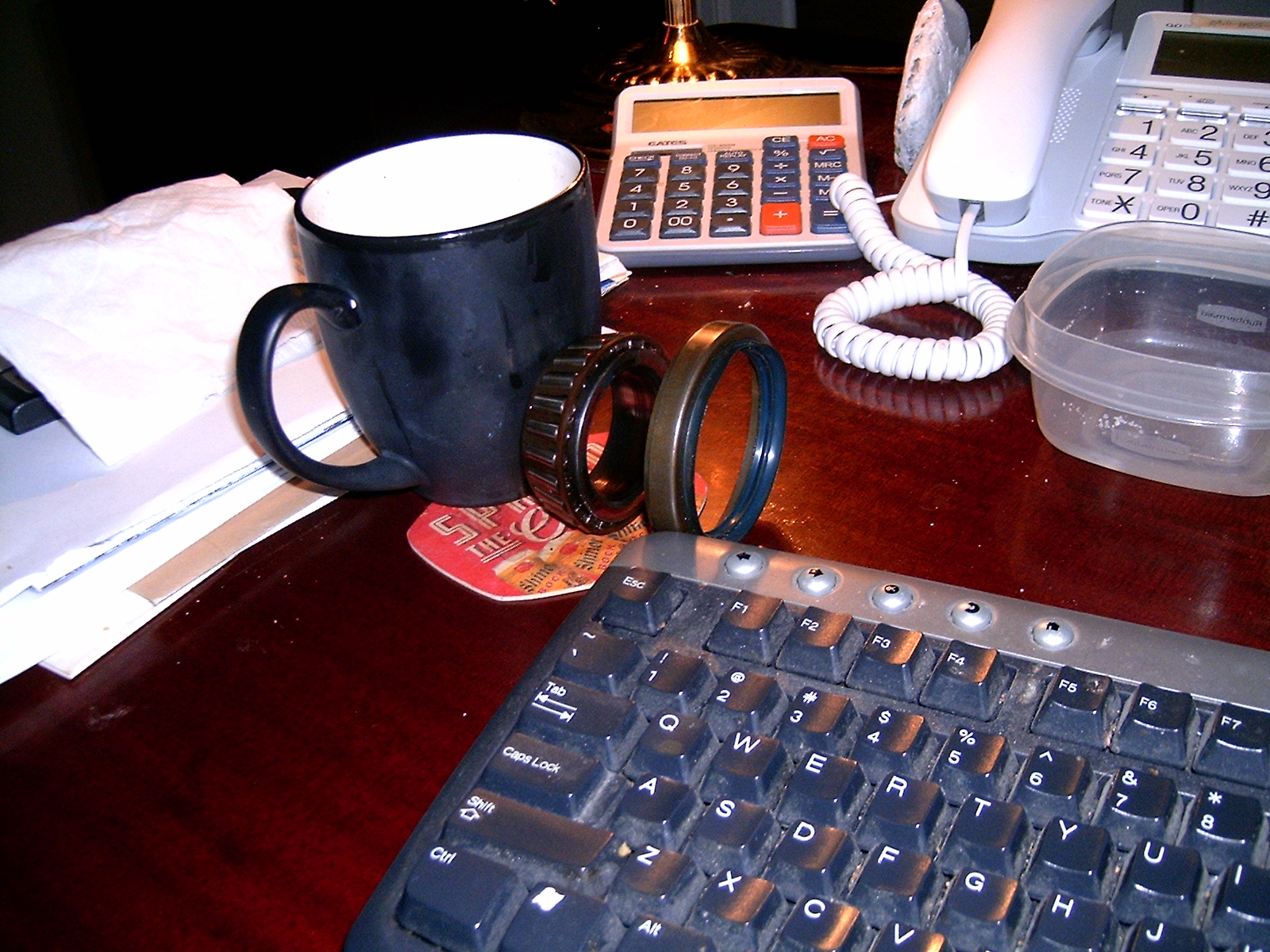

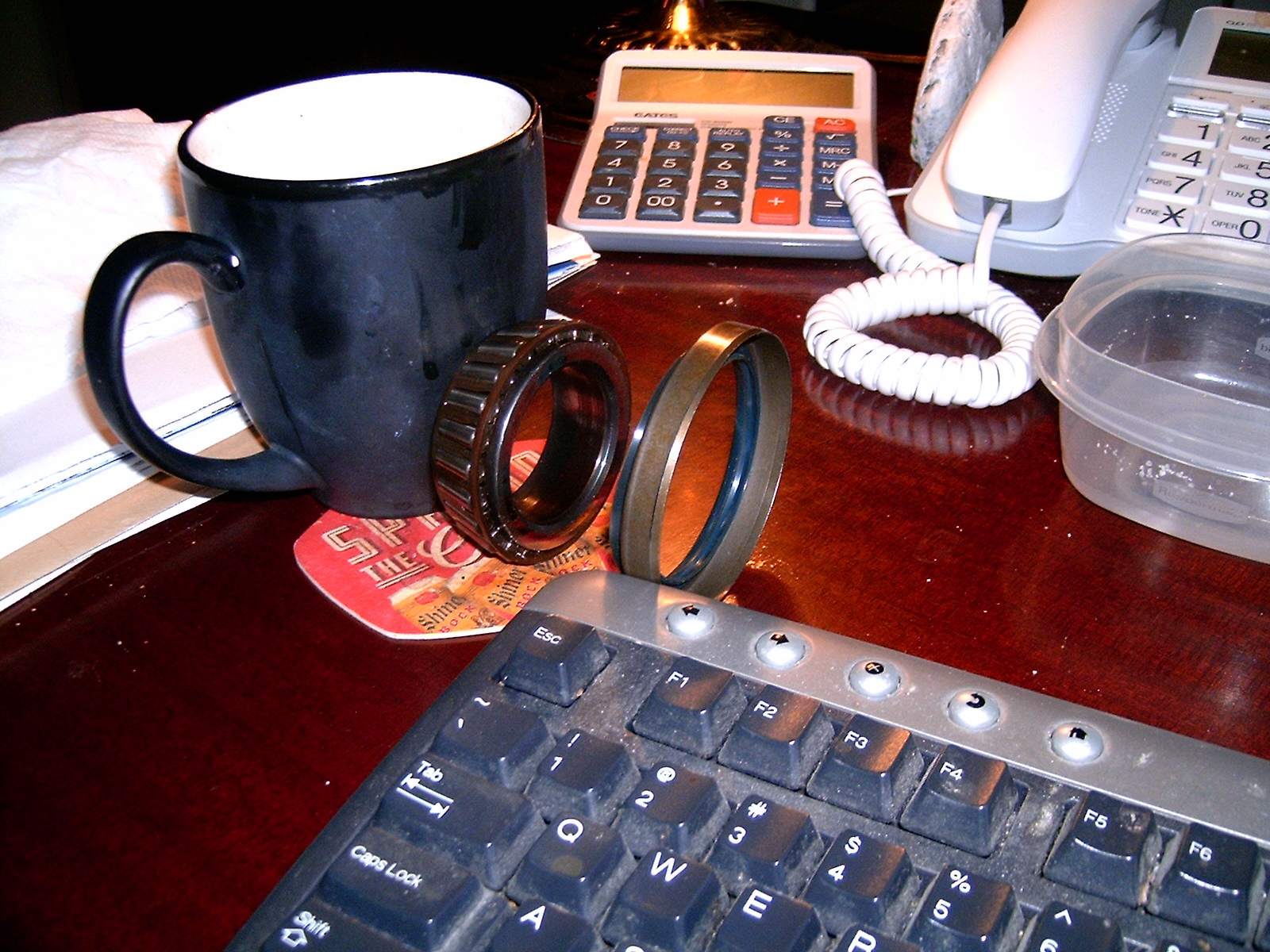

Ok. I got them all apart replaced the bearing races, reinstalled the bearings, and am ready to reinstall the seals. During the disassembly, I rendered the original seals unusable. On top of that, I can't remember which way around the seals came out. Ya, I should have taken a picture but...........I didn't. Should the open end of the seal be installed in the housing facing the bearing on each side. (Pic 2595) Or the other way around? Pic# 2594. What is the correct orientation?
Also, can anyone suggest the best seal installation driver to buy to do this with? I am having a hard time pressing the seals into the housing. Any good knowledge/advice on this? Is there a difference in seals as it relates to housings? I am trying to use SKF 22032 seal. The ones that came with the bearing were the wrong diameter. They were not from the Burton Power kit.
And.....how deep into the housing should the seal be installed?
Thanks in advance guys! Again!

Howard, the best advice is to check with the seal manufacturer. There may be applications info on-line from whoever made the seals. Usually the seal is seated in the housing. Unless there is a sealant coating on it already, I put a thin film of Hylomar in the housing bore to prevent leakage in that area. I know, seals are traditionally installed a certain way but there are goofy exceptions.

Ok to confirm and close out this thread, The Burton power Part # BRT 910 is the correct kit for the original GTD as supplied bearing housing. They are the correct bearings, the correct seals, and nuts as well. The seals go back, in the same way, they came out which is.....................wait for it............... Picture 2595 in post #9 above.
