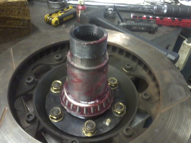

Markus thanks for the info for setting the bearing preload. Now that I have lathe and a surface grinder I can make my own spacers. However my question is how would you measure the space between the inner bearing races? I guess you could make something that you know would be to long, put it together and use a dial indicator to measure the movement of the outer bearing race to get a bit closer. Then shave a little at a time until you get it right, hoping you don't take to much. I think you would have to start from scratch on the other side.
Maybe if you could find shims the right size that would be the way to go.
I know how much torque it took to put the splines together has nothing to do with bearing preload I just thought it was strange it took some much to take it apart or back together. I broke the first The parts are hardened, files wouldn't touch them. I even tried some small stones but didn't have the 2 or 3 days it would have taken to fix the problem.
I made the spacers about 1/8'' longer than necessary. Assembled the wheel and tightened the nut tight. Measured the endplay (because the spacers were too long), disassembled and faced the spacer by about 50% of the endplay. Repeat. Repeat. Repeat. Repeat. Repeat. Finally was able to achieve the perfect amount of play (just a tiny rock of the wheel when tight) and no issues. Each spacer was different on each wheel. Remember, if you face too much off then you get the pleasure of starting over. I also chrome plated and ground my spindles on all 4 corners. They were too loose from the SPF Factory. Here are the final diameters I specified after grinding: Large bearing diameter 2.0000'' (+/- 0.0003''), small bearing diameter 1.8120'' (+/- 0.0003'').
Dave Hood
After having to adjust or replace my bearings every 8-12 months over the course of several years, Holman Moody measured and installed spacers back in 2014. The bearings have been fine since then although I've driven more than 21,000 miles. Unfortunately, these have to be manufactured based on the dimensions of each hub and can't be mass produced for all SPF cars. I don't know if Superformance has updated this design, but this is one of their biggest design flaws where a more modern approach could have been taken.

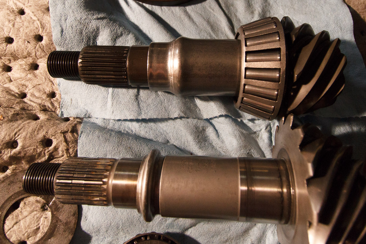

I’m somewhat surprised that they don’t set these up with a “crush” spacer/sleeve like those commonly used on pinion gears in differentials…
Two different ones shown here

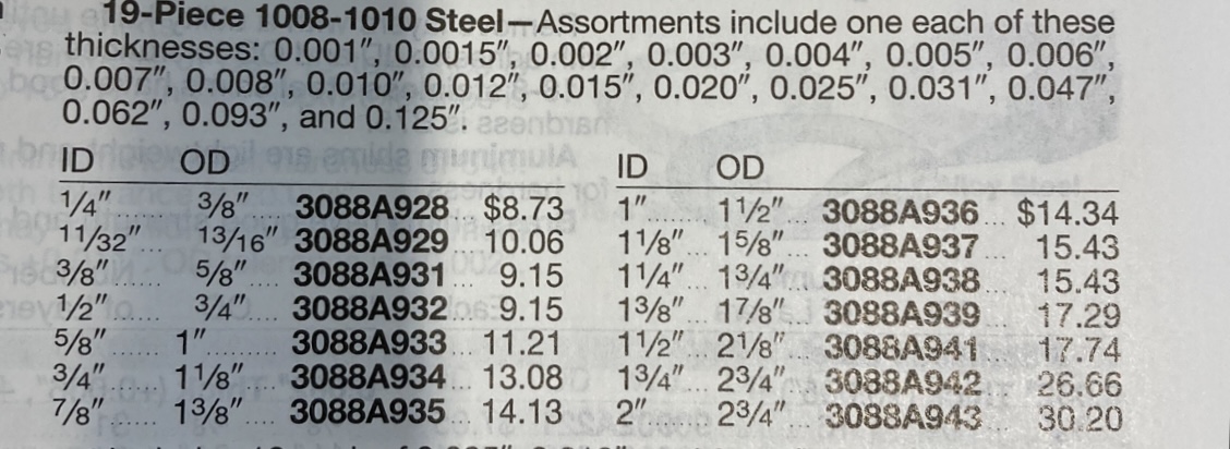

Hello Markus. If it would help for setup, McMaster Carr offers shims with a 2.000 diameter inner hole. They come in individual sizes .001-.010, .012, .015, .020, .025, .030, .048, .062, .090, and .125. They also offer a kit with one each of the above sizes. You could come up with a starter spacer and add shims to get the perfect setting and then take that dimension to make a solid spacer. If there is a issue with them not selling into Germany, I would be more than willing to order for you and send them to you . If this is something you are interested in, please PM me and we can work out the details.
Regards Brian

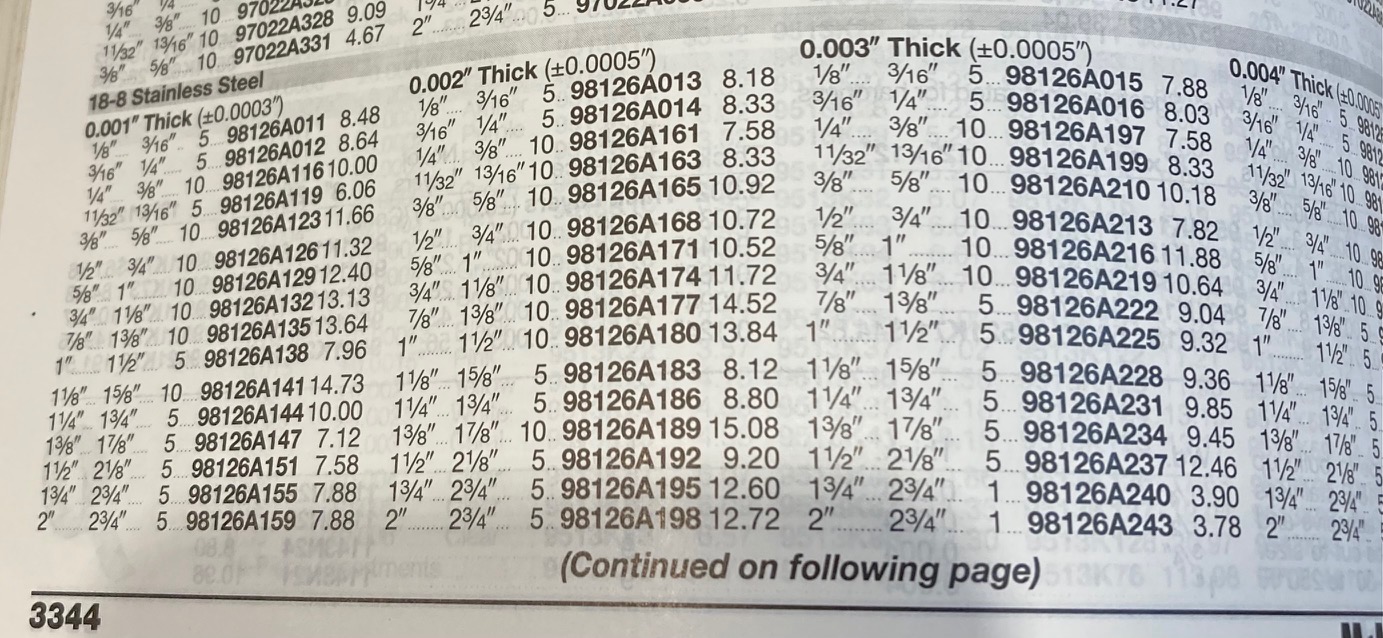

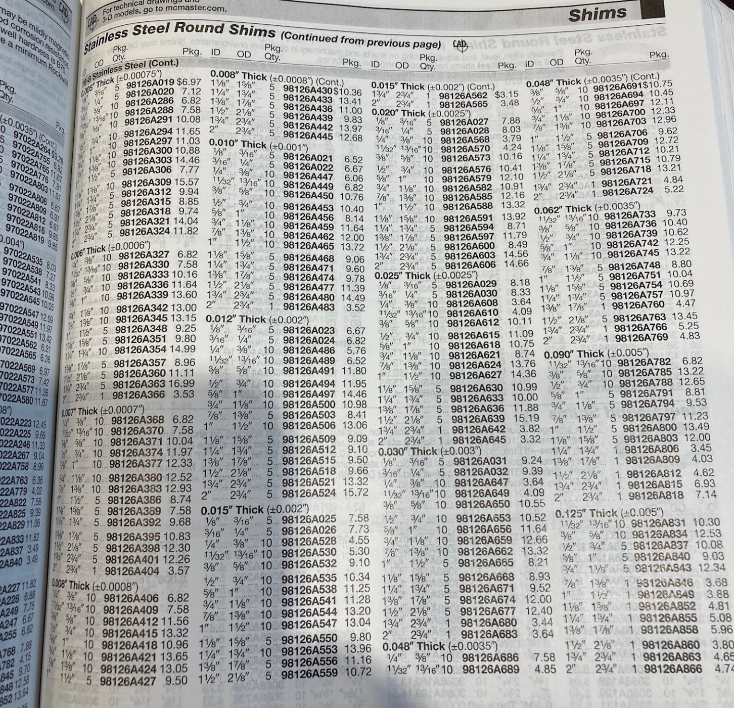

Markus, happy to help out anyway I can. I just noticed the individuals I have listed are stainless steel but are available in 1010 steel also.

Looking to your screenshots and McMaster website and the minimum order quantities of 5 / 10 I might as well opt for the 19 piece carbon steel ring shim set you also posted:
I will further investigate on the weekend and send you a PM.

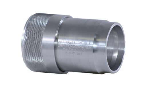

To bring up an old topic. Is this as clever as it looks? Markus posted this over on a Safir thread. Would this solve the SPF bearing problem?
In fact would these be suitable (18690/18790 bearings)?
