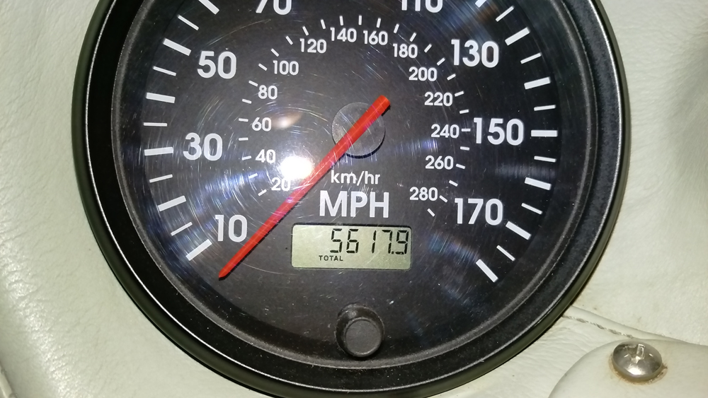

Hi Paul,
I presume that you have something similar to the attached, which is a Smiths branded gauge made by Caebont. They have a good technical help desk and should be able to point you in the right direction.
Caerbont Automotive Instruments | Homepage
Rgds,
Andy
