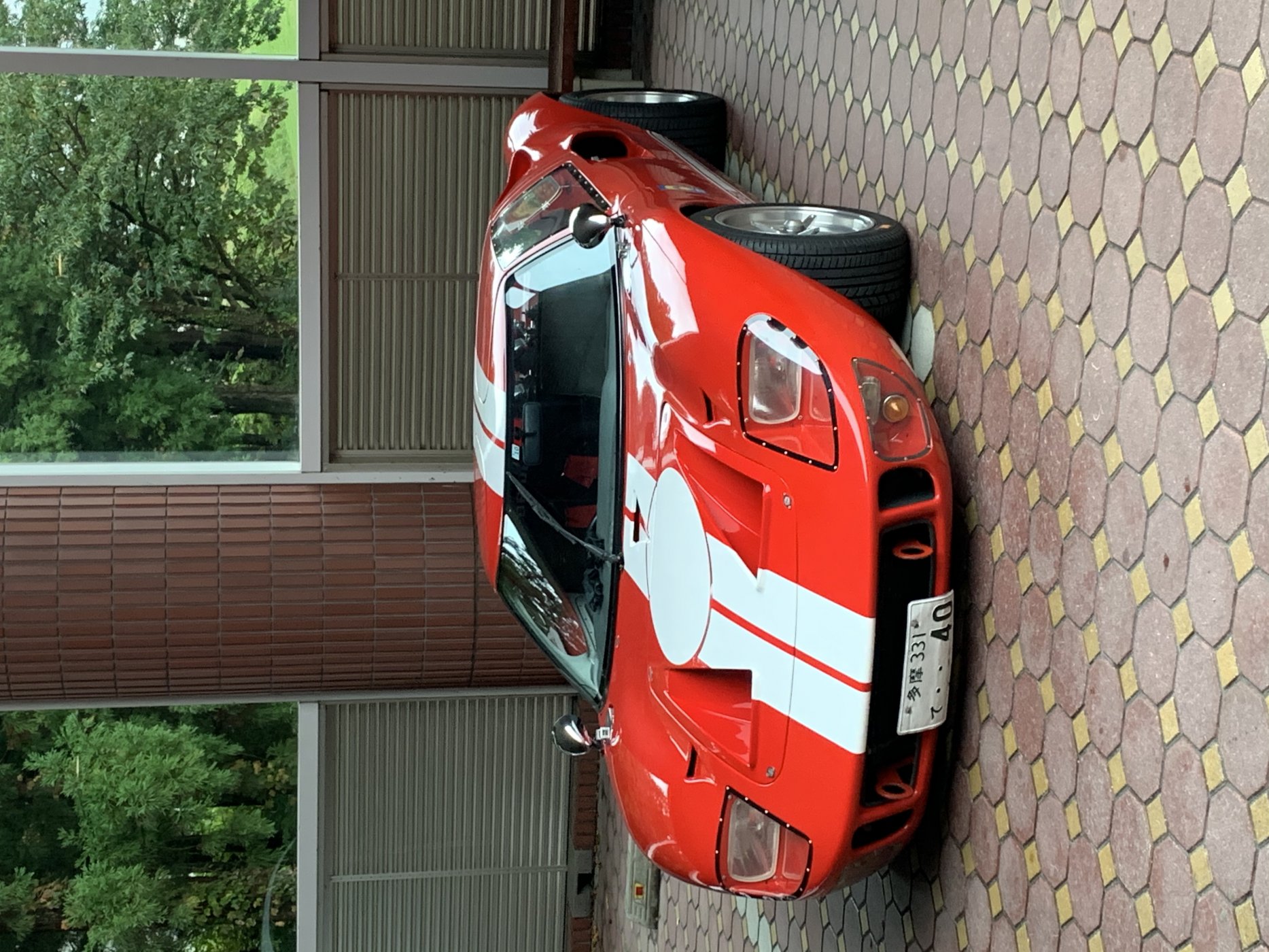

Hi, I’m looking for replacement parts of turn signal unit for my GTD as the unit seems warm out and can’t hold the light bulb well. It’ll be appreciated if you could let me know the part number of the unit or car model?
Yuji
Yuji
Ian, thanks for the info, but seems a bit different from mine?

Ed McClements

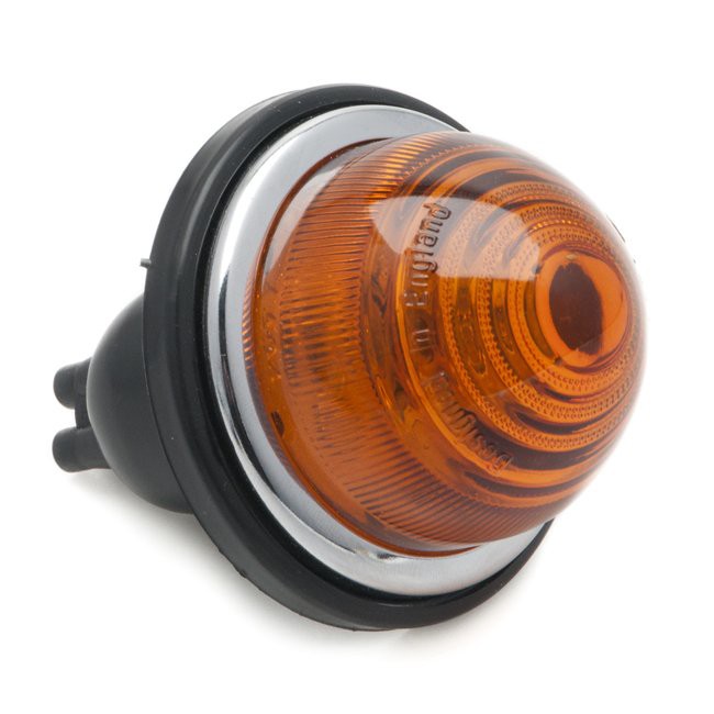

I think what you might have there is a Lucas L594 - used on lots of British cars for many years. Even my Dad's 1964 Slough-assembled Citroen ID19 Estate had Lucas electrics...some law about having to use a certain percentage of British parts to get around import duties on cars from "the rest of Europe". Plus ça change, plus c'est la même chose....
Yuji
Ian, thank you for follow up! Let me check with existing one and place my order if those might match!
Thanks and Regards
Yuji
Yuji
Found one at British car shop like Lotus and old Mini etc. in Japan and placed an order already!
Thanks for the help.

This looks a lot like the early '60s Ferrari front turn signal lights.
