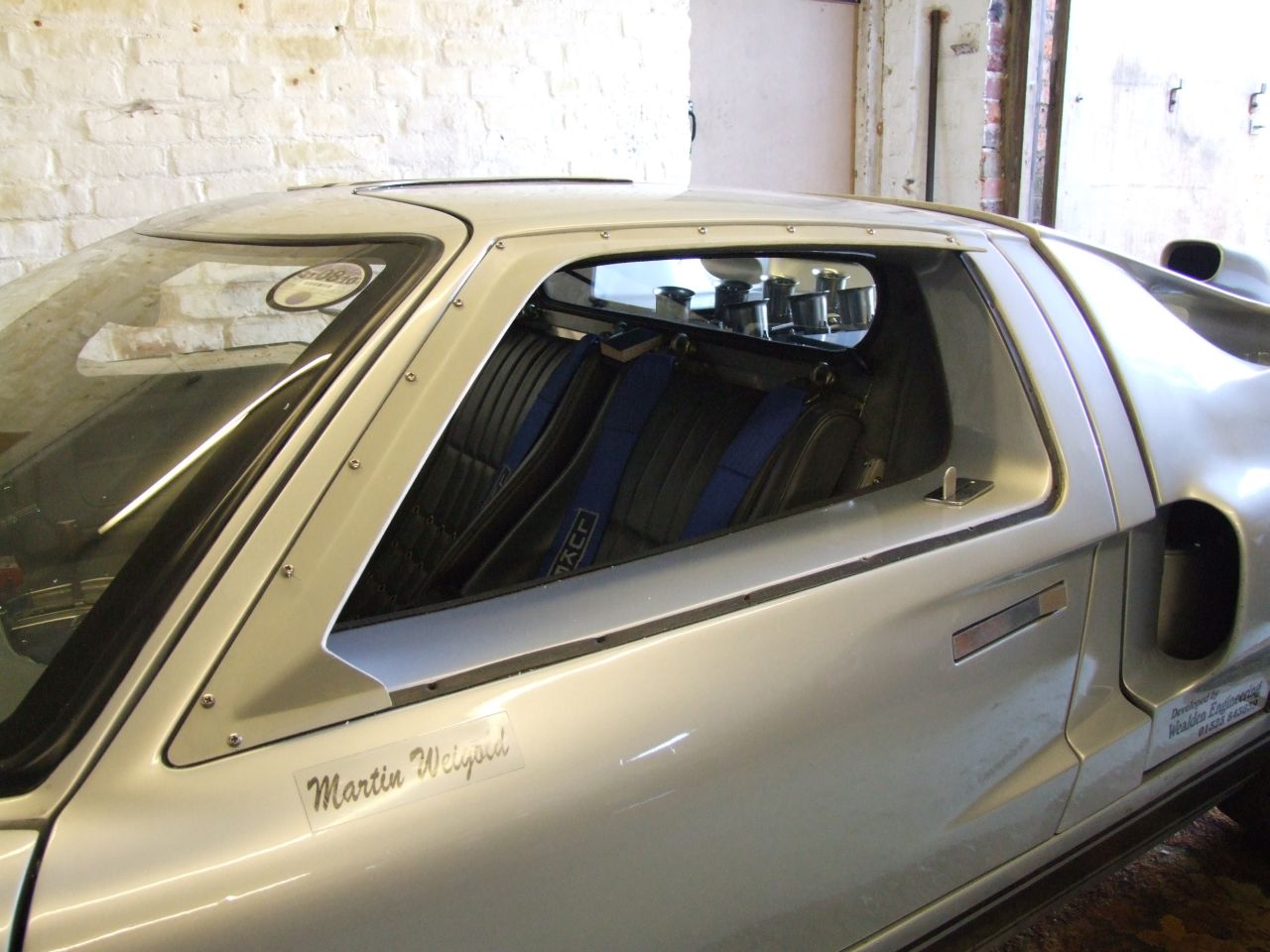

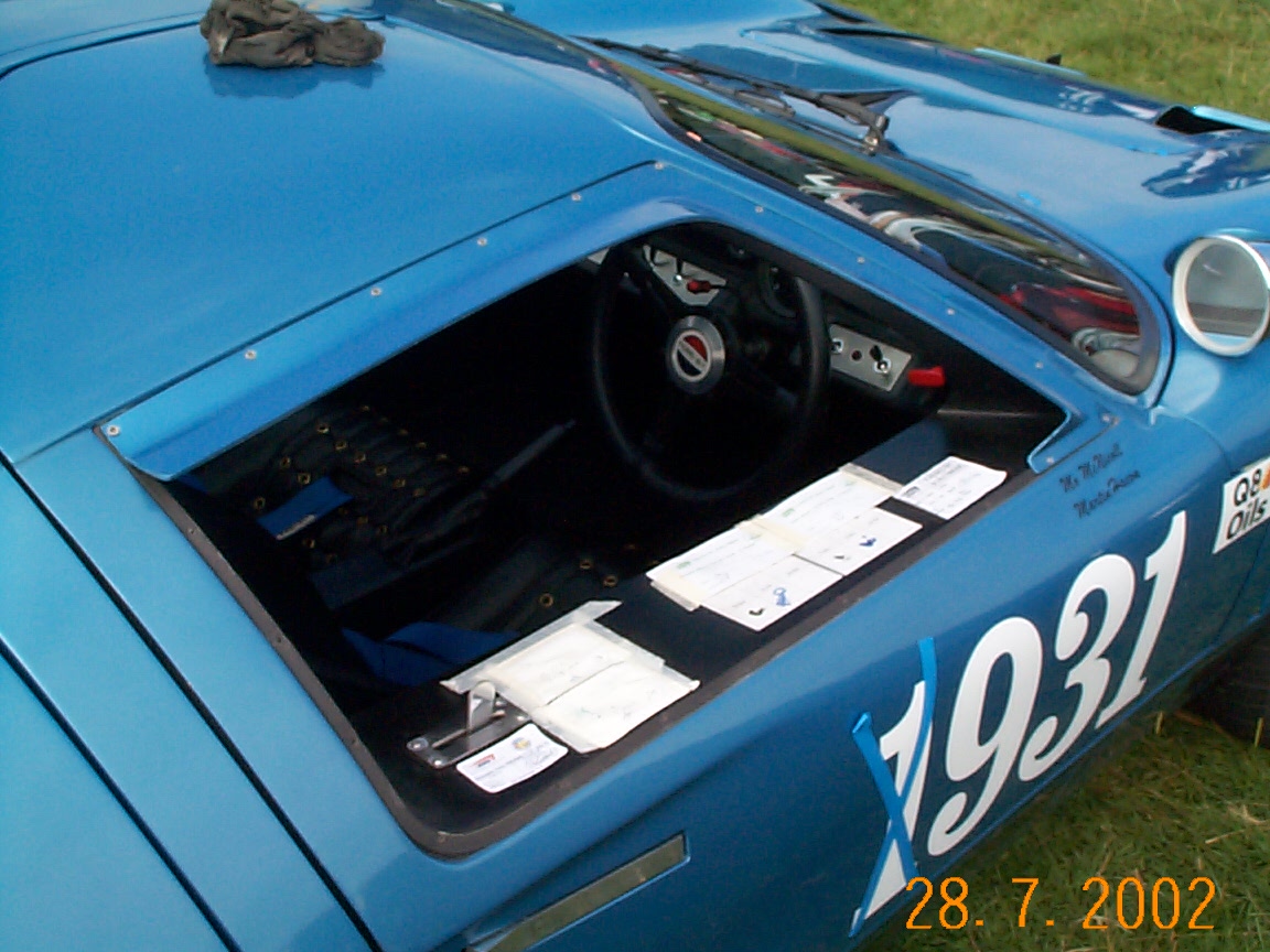

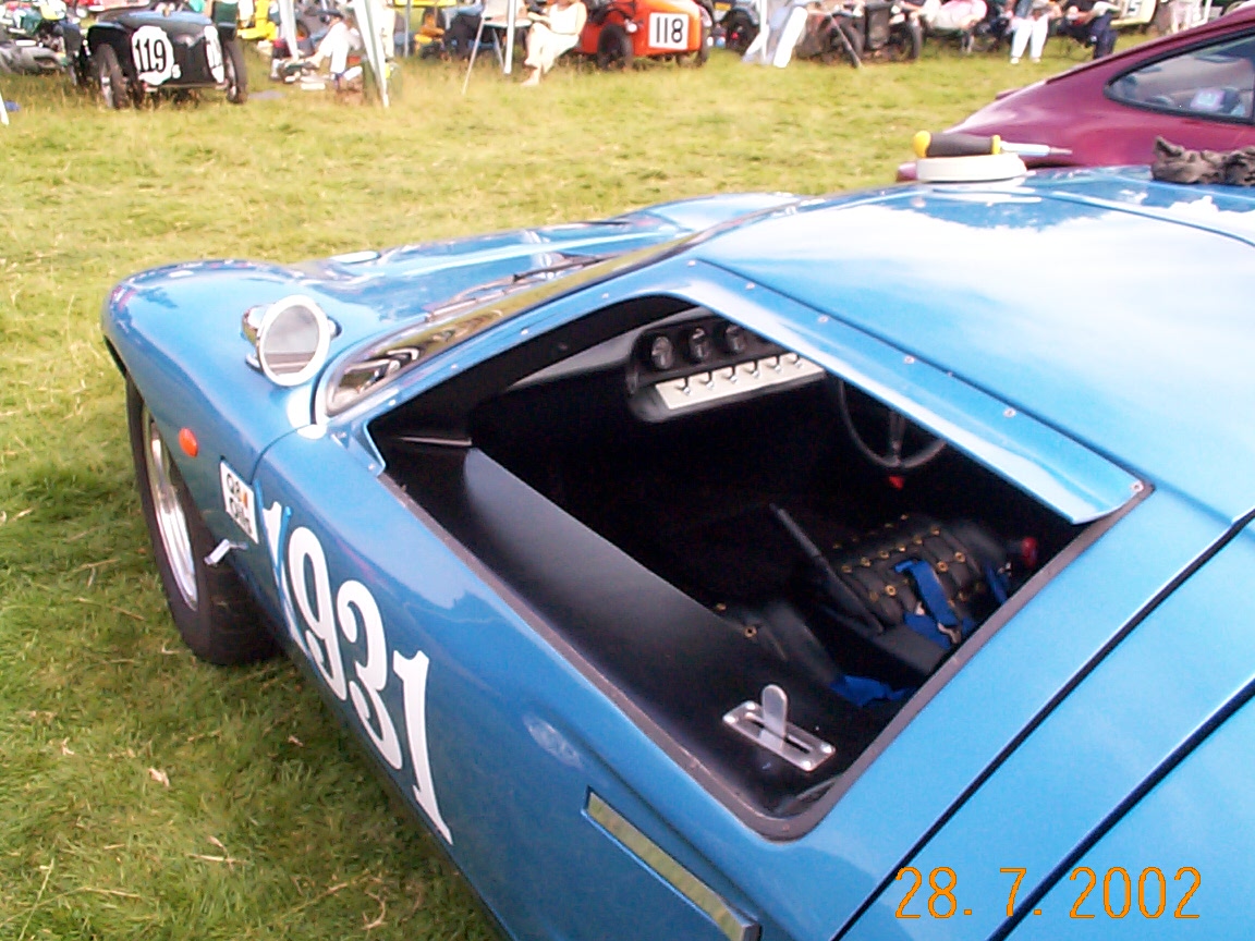

Pictures - second attempt. This is what the guys in high temperature areas use !

Yuji
Frank,
Thank you so much for the suggestion as usual!
Looks no window there!! Let me see.
