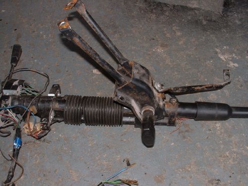

I was wondering, when I tighten the nut to lock the position (vertical movement of the steering wheel), it locks this movement but it doesn't lock the sliding movement of the steering column itself...I can still pull the steering wheel in and outwards. Unless I push it totally in, so getting smaller, it locks with a small notch...but there is no in between...
These pictures are from the Triumph forum.
The Triumph Dolomite Club - Discussion Forum • View topic - Steering Column

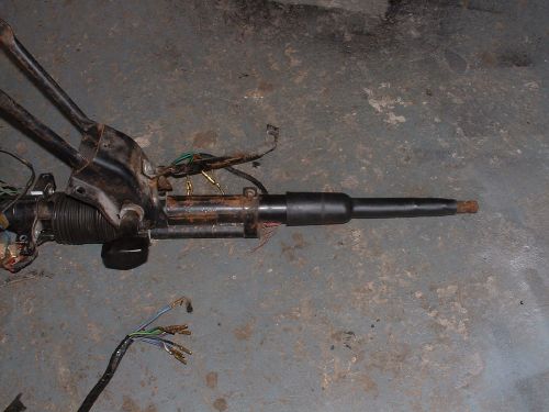

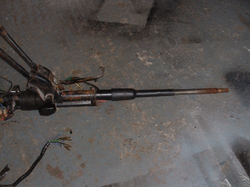

The locking mechanism
The long position
The short position
Is this normal and so only the "shortest" option can be used ?

I checked again few minutes ago, and when I loose the black plastic knob, the column can move up and down and back and forth.
Tightening back that knob, locks the column in its position, whichever it is...
However, in my particular car, only the shortest is of any use, any other position put the wheel too close from my chest... : I'm thinking about shortening the column a bit, to gain some more useful adjustment possibility
Hi Pierre,
When I tighten the nut, I see it squeezes the top section but there is plenty of room for the bottom and middle of the beam to keep sliding. Looks like it bottoms out at the top before the middle and lower sections tightens.
mhhh....good to know it should work in all positions, I need to dig into it further. While turning the steering wheel, I see the column wobbles a bit. Looks like it is bend a little bit. I am able to make 3.75 turns with the steering rack. Is that normal so much turns.
