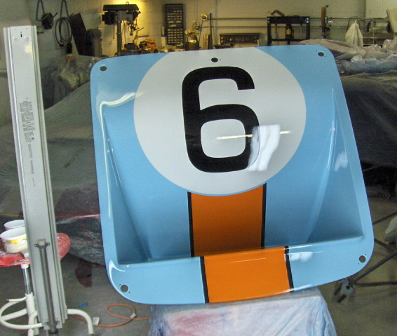

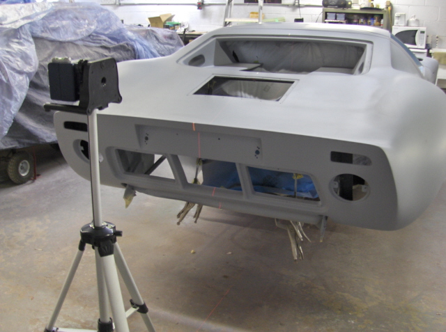

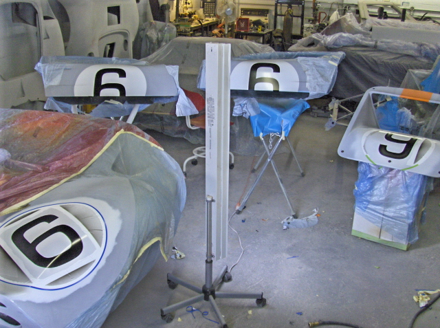

I can send you the paint codes in Dupont Premiere. We looked at PPG, Dupont, Glasurit, RM and went with Dupont based on quality and local support. I think all these paints are available through Carquest in Canada.
The PPG formulas do not cross over either so we had to do some scans of previous paint. Attached are pics of Angelos' Gulf 1075 CAV GT freshly painted hood panel and the laser setup to help layout the stripes. The stripes, roundels and numbers are all basecoat with Duponts 72600S Premiun Scratch Resistant Clear to topcoat.
