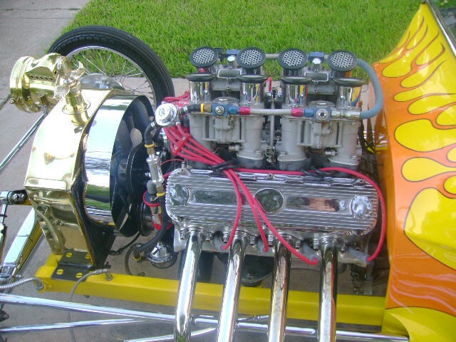

I recently acquired a 1923 model T as it was parked in a neighbors garage rotting away. He said the engine was a gurney Weslake 302. I haven't spent a lot of time on it yet because I would like to know what I have. The time I have spent tinkering with it the weber 48 Ida carbs were expensive and difficult for me (new to this)
I'm not sure what I want to do with this engine yet.... Can anyone help me out?
I'm willing to provide as much info as I can. Mostly just curious to what this is worth?

Yes those are GW mk4 heads. They are most likely to be the later AAR road version cast by A&M rather than the WM cast race version as fitted to GT40s (see differences here Gurney Weslake Homepage ). The Webers will be worth most if they are period Italian ones - check for numbers stamped on the cartouche at the base. As for the rest of the engine, check the block part number to identify if it is anything special - XE or Boss 302 say. The rest would require engine disassembly to determine. Value? $15k upwards - you still have to find someone to pay!

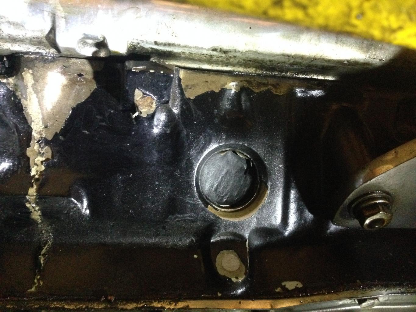

Ok so I couldn't find the casting numbers anywhere so I removed the starter and still found nothing. Could they be under the paint? I took a picture so if you know where to look I will remove the paint and find it. P.s. How should I remove the paint without scratching the numbers?

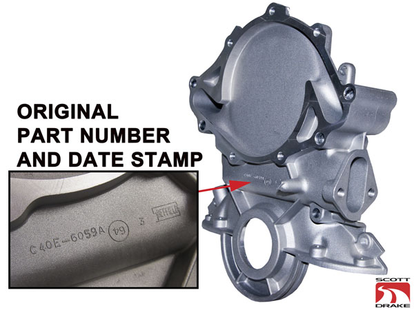

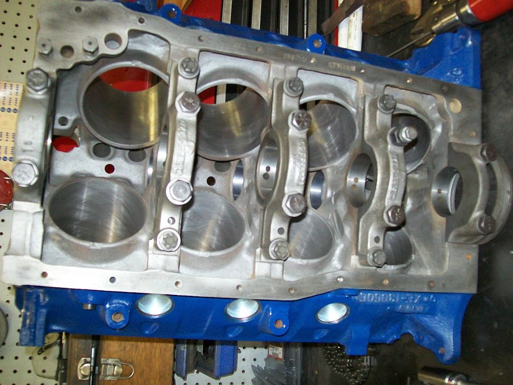

I found this picture on another thread. The casting numbers are clearly not on my engine block where these are... Any ideas?

If you strip the paint off that casting number pad you might be able to read the number 'shadow', but it looks like its been 'de-burred', next external clue would be size- width & dia- of crankshaft damper outer ring- if 289 hp it is very close to front of timing cover & extends further fwd than pulley bolt face ( 3 bolt pulley ). Freeze plugs in block suggest a 289 Hi-Po at best I think.... Mexico block had three cast bolt lugs facing forward at front of block, usually undrilled- one just in front of oil filter pad & two on the non pump-filter side. What trans is it running and how many bolts attaching bell housing to block- 5 or 6?

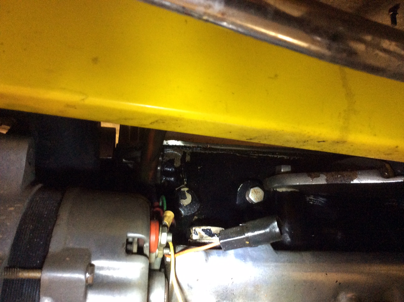

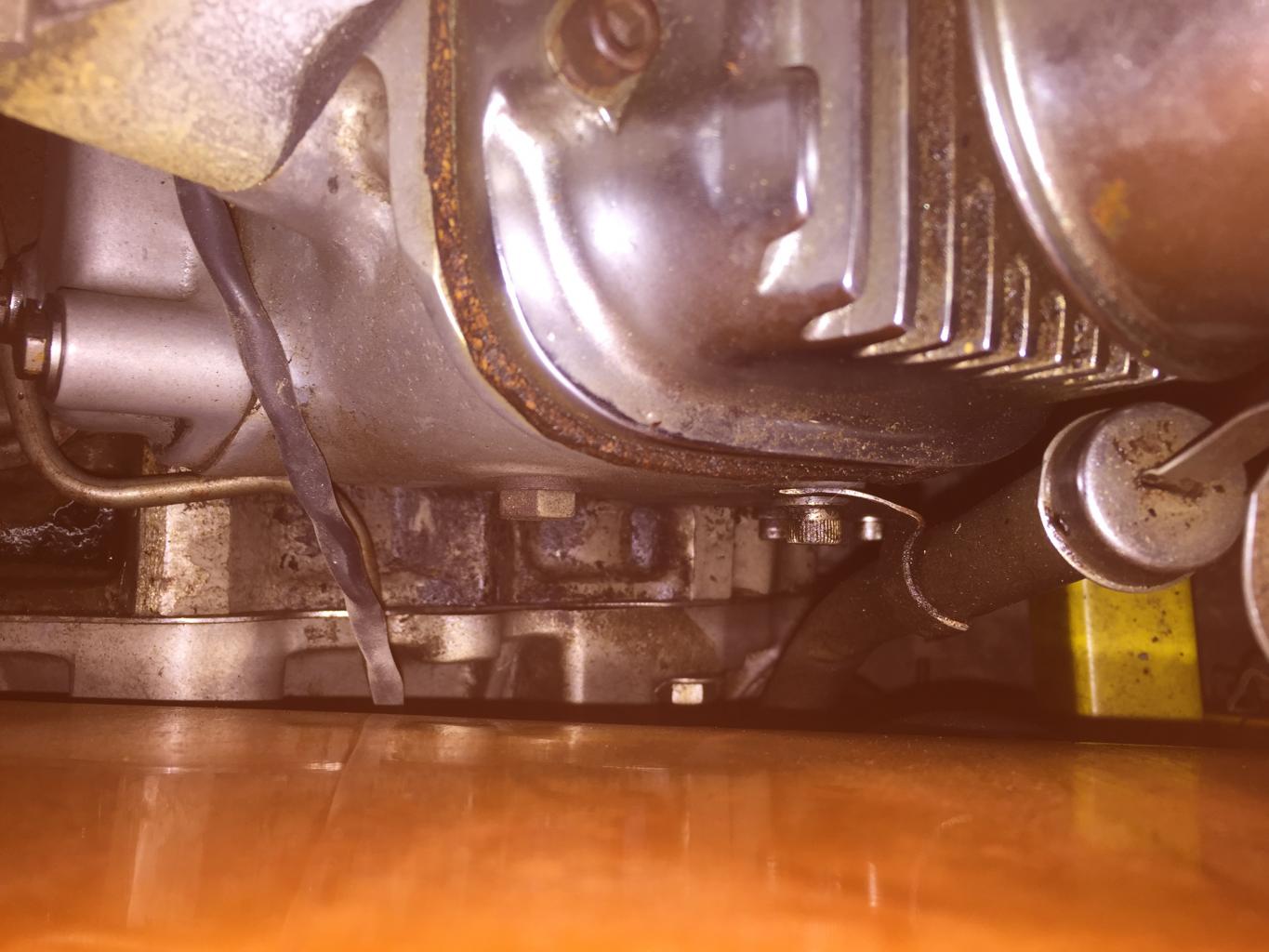

As for the 3 cast bolt lugs on both sides of the motor, I looked and found some flat spots but they do not face forward. I took Pictures but I'm guessing these are not what you are referring to. see pictures. (I apologize for giving the finger):laugh:

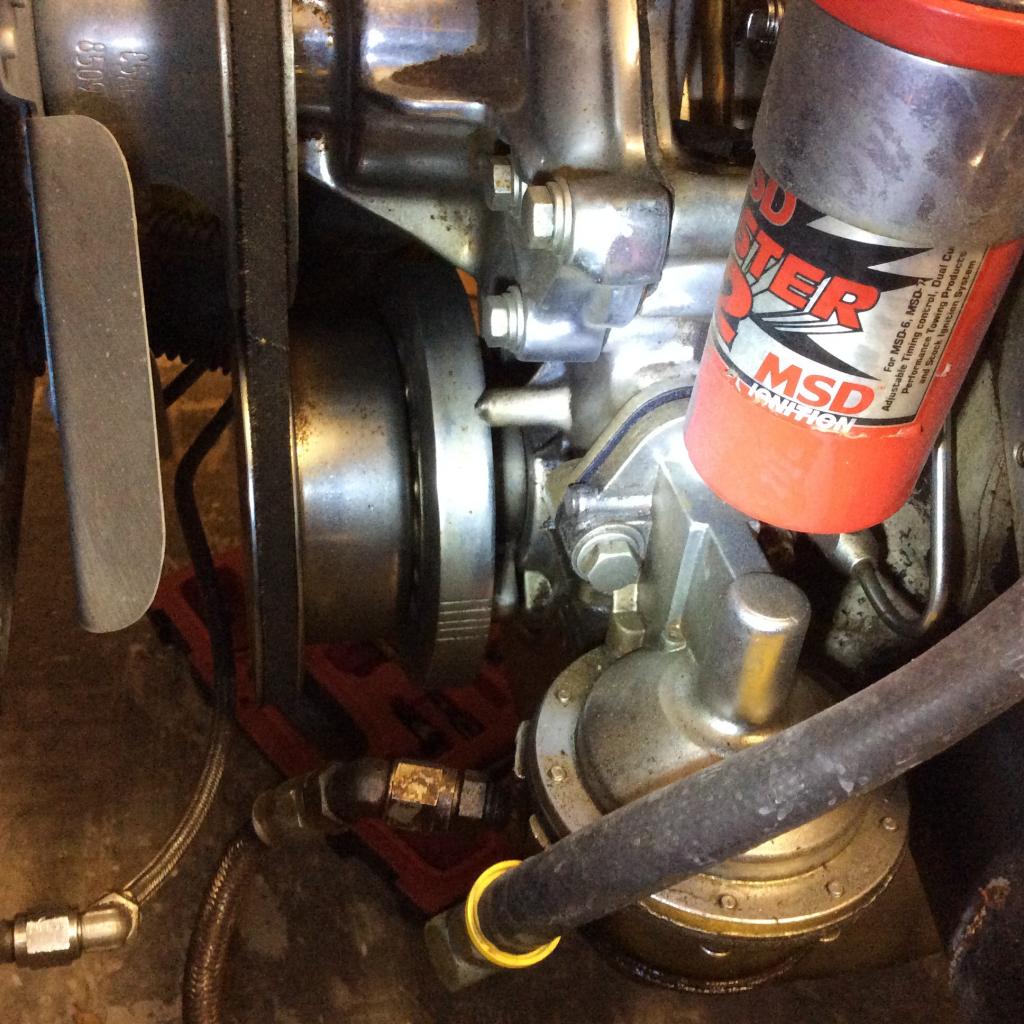

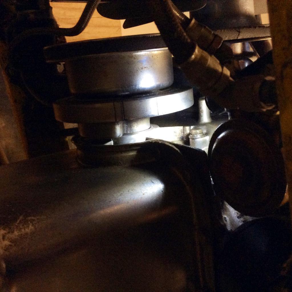

Try to take a close up of the crank dampner. Your larger lower crank pulley is bolted to it. A good look at that should let you know if its a K-code 289hp, or not.
The numbers you are looking for above the starter should be a stamped VIN#, not a casting #. Most of the k-code mustangs had the block stamped with the VIN#. At the end of the day, other than the VIN#, a hp block is nothing special. Its the bolt on parts that make it special. (ie: main caps, crank balancer, crank damper, etc)
Water pump pulley in post #11 has C5-- (1965)p/n plus damper & front cover 'look' like items from that era... which would suggest that its a plain jane 1965> 289 motor, nothing wrong with that, just is what it is!
When I bought the car the guy told me it was a 302 or a 305. Any chance it still could be or anything relatively simple I can do to really be sure?
Stroke is 3.00" for 302, 2.87" for 289, so you might be able to check that with piece of wire thru plug hole. 289 can have 302 crank fitted to make it a 302... 305 would be 302 + 0.020" or 0.030" rebore, only sure way would be pull pan and check/measure stroke or crank numbers- you could pull heads but cheaper to pull pan, video camera with probe would show piston crown & valve cutouts & possibly stamp for oversize bore to someone with weslake experience.
Looks like a 70's era timing cover to me. I can double check but thought the 60's covers had a bolt on timing pointer. Also, thats deffinately not a HiPo crank dampner.

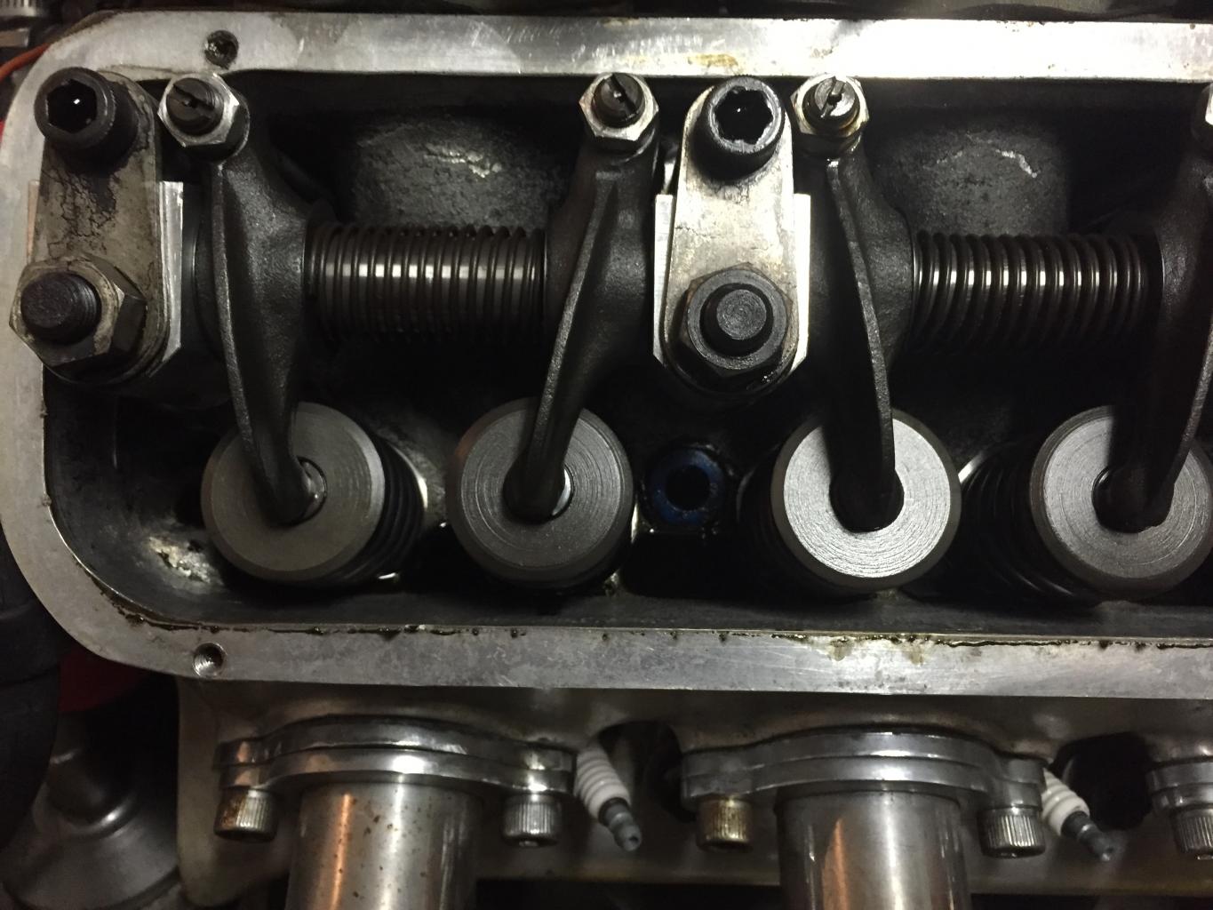

As of late, I'm trying to identify what heads I have. I believe them to be the road version.
This first picture is on the back side on passenger side of car. because of clearance it is difficult to get a good look. I may remove them this weekend.
All help is greatly appreciated.
