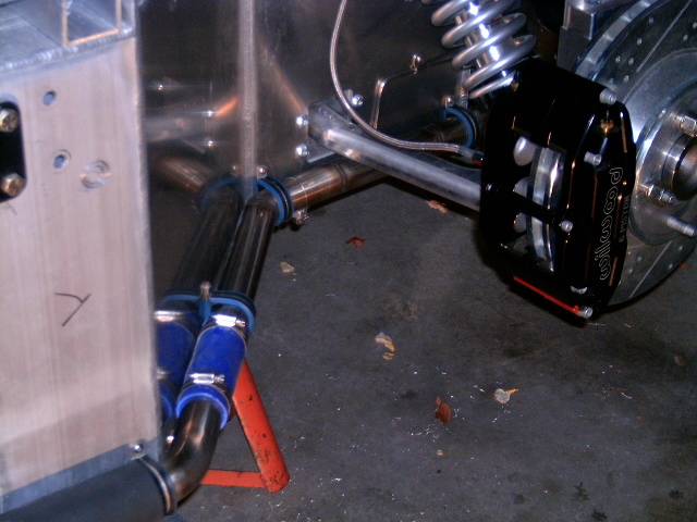

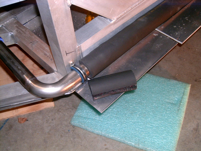

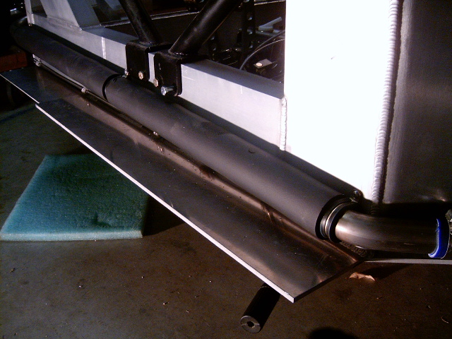

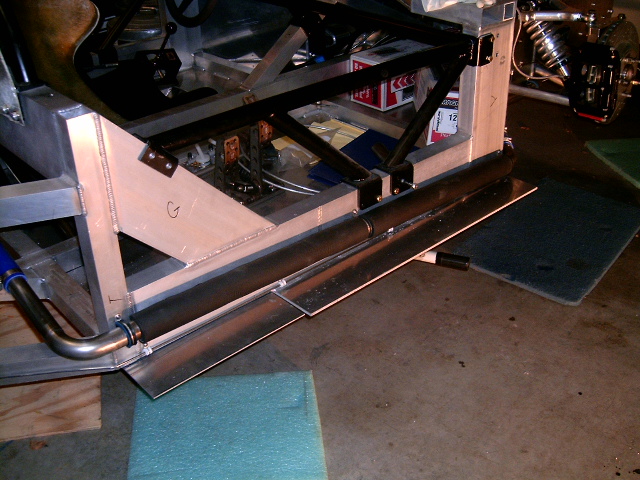

Here's how I did the side pipes. I intend to use thermal shielding on the firewall behind the radiator and on the cover that seals the sidepod at the bottom of the doors. I haven't gotten that far yet however.
Howard Jones
Ooop's pics.
