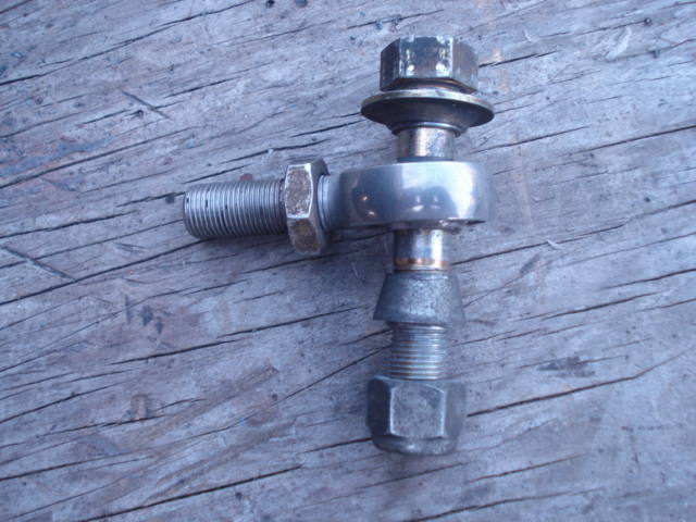

where can i find this type of heims joint?

I am pretty sure he knew that was a heim joint. That exact type shown is an aircraft version. Original gt40s used heavy duty high misalighnment and are prety close copy is sold by Lamb Componets in Ca. Original cars have a shank size 1 step bigger than the bolt that goes thru it.

yes i'm familiar with it being a heim joint. i'm looking for that particular joint with the top and bottom spacer for a custom a-arm.

You will only find that setup sold separately
Art Morrison in the US sells spacers and rod ends but not as good a selection of rod ends as Baker
spacers page 64
http://artmorrison.com/2006cat/2008catalog.pdf?Download+Catalog=Download+Catalog
