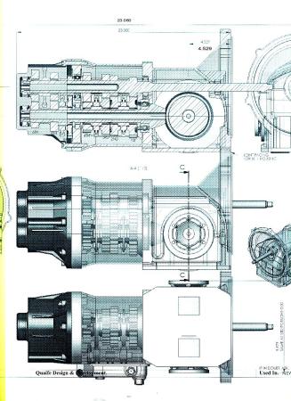

Pete,
A couple of years ago, everyone was in a hub-ub over the new Quaife transaxle (see pic below) that is available in sequential or H pattern. Dimensionally, I believe it works in a GT40, but you don't hear much about it anymore. I am not sure why that is; anyone want to chime in here? The new Xtrac that is posted in the powertrain section looks the bomb, but we don't have good info yet (although I sent an email to Brammo yesterday inviting them to join the forum and comment.) The issue with the GT40 and transaxles is finding one that isn't too long.
