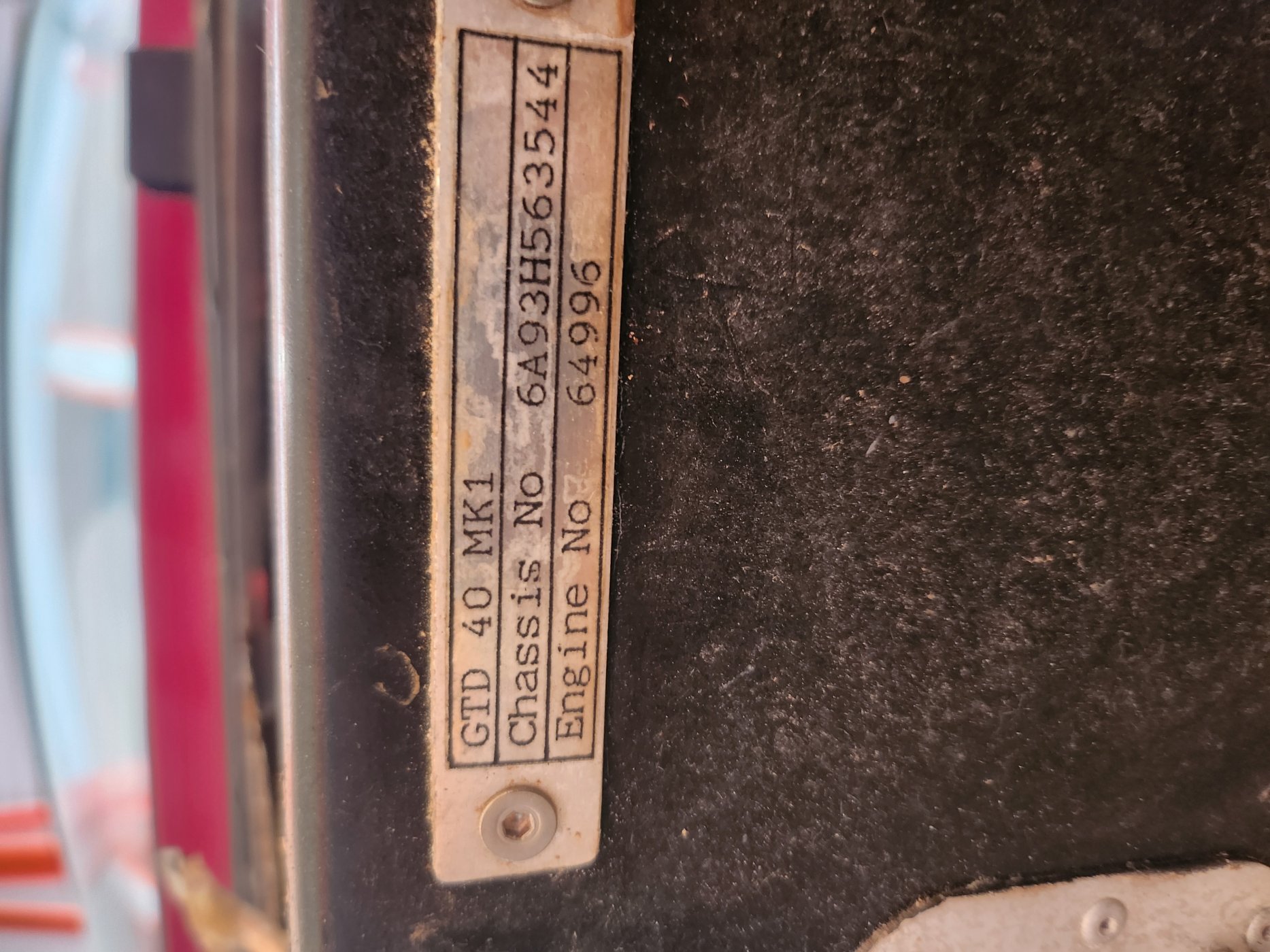

My question is relative to a car which had been traveling around the world, maybe >america >england>hong Kong>Thailand as far as i know the story.
We would be glad to share with you it's identification plate in order to know its origin and pedigree from you, dear Xperts....
we dont find any id number on engine itself but have only a plate as following:
GTD 40 MK1
Chassis No 6A93H563544
Engine No 64996
I guess 1964, but MK1 were so rare as far as i know...
could anyone tell me which model and year it is ? and what about the engine specs
Thanks by advance.

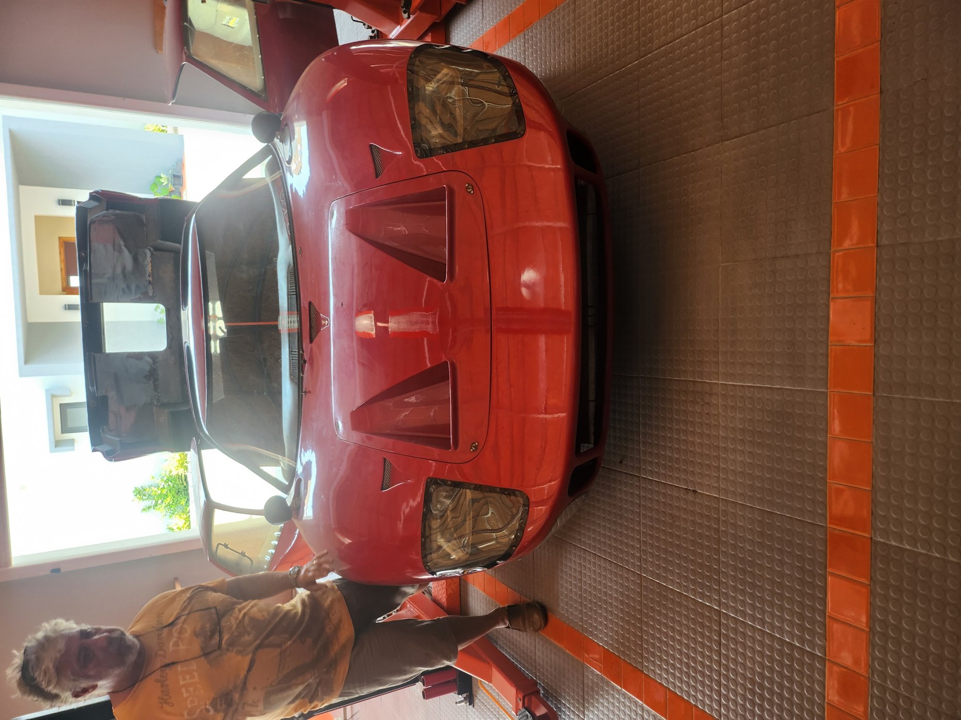

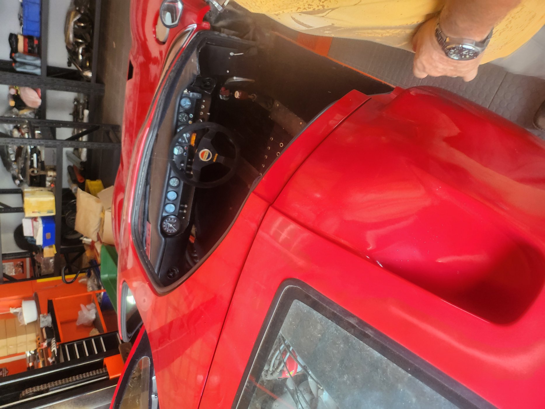

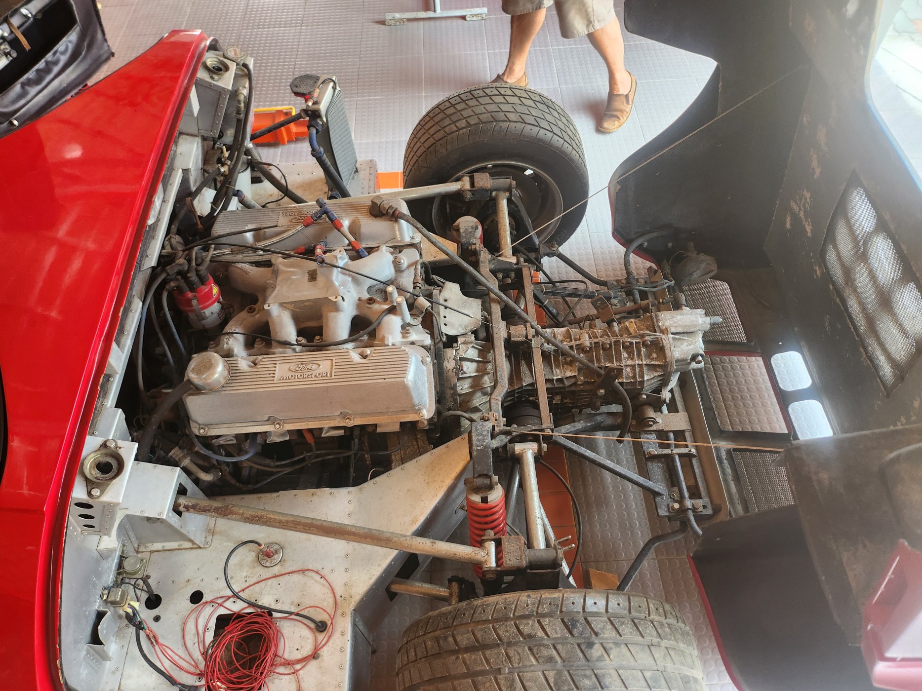

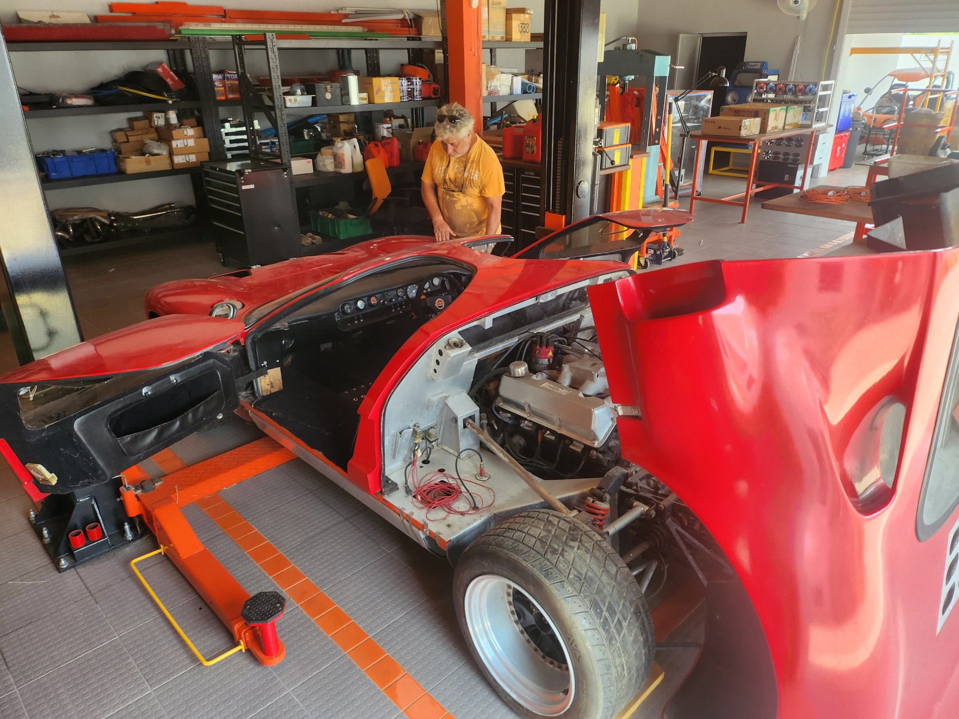

Hi Brian, thank you for your advice.
here and above are some pics of the car, before we took of the frame parts

Cross over chassis members above gearbox and the rear body and ARB mounts do not look like GTD to me. GTD chassis numbes are stamped directly into the chassis and not on a chassis plate. Some builders used a chassis plate to give their own chassis numbers for what ever reason.
Malcolm
looking at the condition of the odd chassis bits, it seems these could be customer modifications. Rear gearbox mounts look different too.

  3. CHASSIS : According to some of you, car isn't a real GTD so could be before year 90's

Engine 351 Cleveland with 2 barrel heads as you can see the number two on the corner of the casting outside the edge of valve cover. Two barrel heads still have 2.05 intake valves which are large compared to most but small verses the four barrel heads which have 2.19 intake valves. First glance thought Boss 302 but no water running through the intake. Should perform great. Good luck with your journey.
Howard Jones
The chassis (the stuff that doesn't unbolt as well as the rear uprights and suspension pieces) looks very much like my GTD. The center spider is a GTD. Some of the pieces that unbolt such as the horse collar crossbrace are homemade. I suspect that is because of the taller 351 deck height and a need to gain clearance for headers. I think the chassis number is trying to tell us that it was produced in 1993.
I see a good foundation for rebuilding what can be a nice car. You're going to end up making some parts but nothing that can't be done with a little persistence. Do you have the headers?
