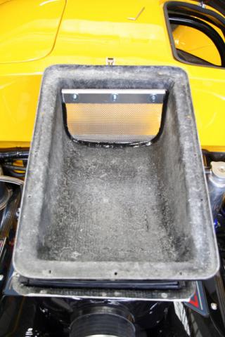

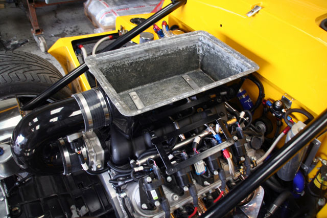

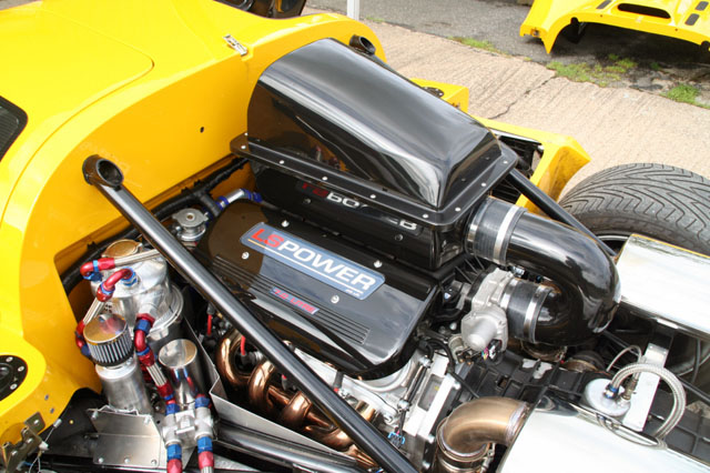

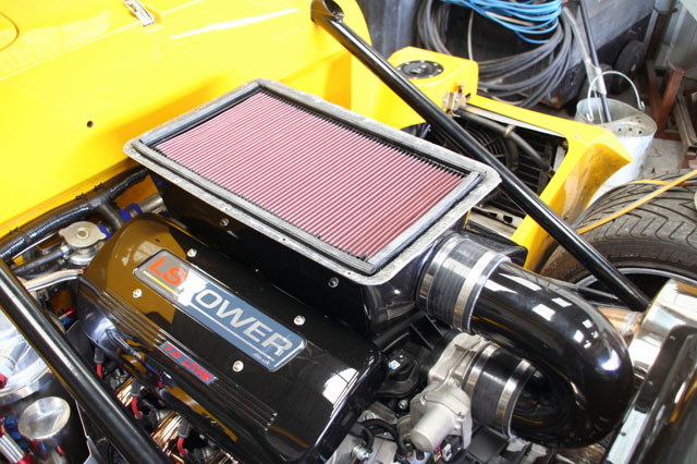

I've been intrigued with the Gardner-Douglas LS intake box for the Ultima GTR.

How much vertical clearance do you have from the top of the carb inlet flange to the closest point of the lexan rear window?
I have approximately 2 1/2'' from the forward most (towards the front) fuel bowl to the rear clip with a 4150 carb. If I go to a dominator that'll be closer to 1'', so not a whole heck of a lot!

2.5 inches will work as it will allow for the same area as the 5 inch diameter carb inlet area or aprox 16 sq inchs. If you look at my cardboard box you can see the inlet going forward towards the filter area is aprox 7 X 2.5 inchs. That gets you about 17 square inchs. My idea is to continue to increase the cross section of the box as it progresses towards the filter itself. This should prevent restriction to flow that would be in excess of the filter element itself. The filter was selected using the calulator on the K & N website.
1 inch will be very tight and I don't think it will work for you. On the other hand I don't see why you can't get enought HP from a 850 DP. That will allow you to work with a 4150 carb.
