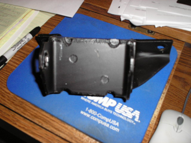

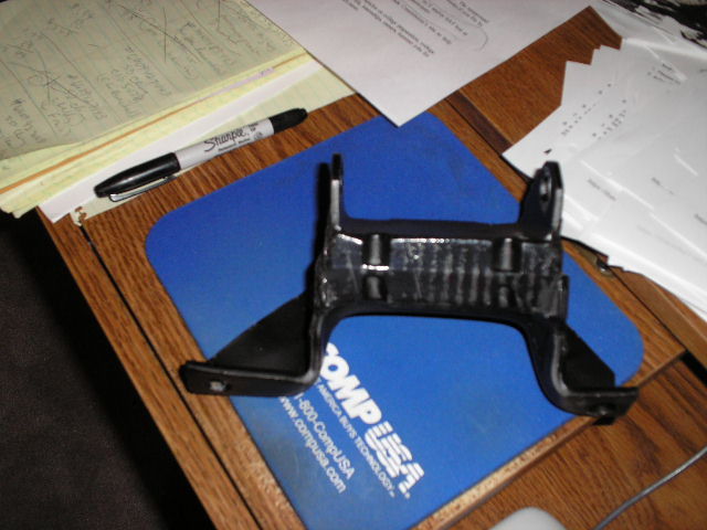

Dan the engine mounts donot have a part number on either, I just checked. They are 1 and 1/4 inches thick (tall) at the rubber bonded area. I would think you could look at moustang ones and see if they are the same ??
another, sorry the pics are not very good, these things just kinda shoot like a blob , LOL

The mounts, as I recall, are for a 67 Mustang, which is probably the same for many Mustangs in that era. I didn't have motor mounts and bought some at Autozone, fit like a champ. Look like the ones in the picture above. Just get some for a 67-68 302 and see if they work, I think they do. If not go for another year, but I bet they are all the same. Dan, I can send you mine - doesn't look like I'll be needing them!

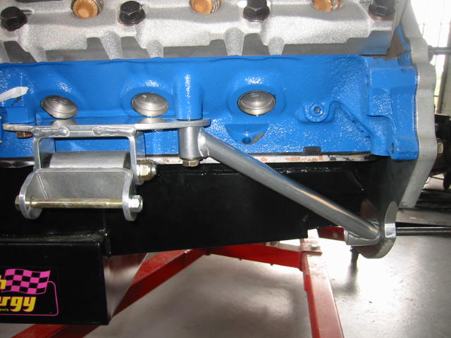

This is what is used at the DRB factory -- just fits in the same place the OEM ones do and much better for the GT40 IMHO

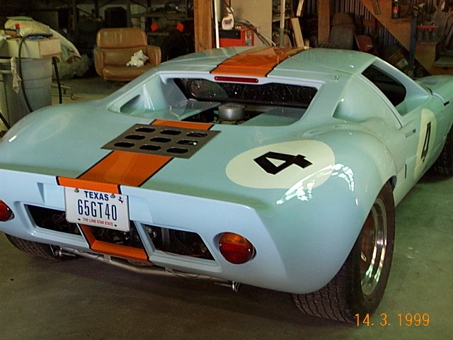

Very COOL 3rd Brake Light!
I want one!
Did you make it of buy it.I will be gladely to pay for another one to be made up.This is a very serious SAFTY matter being so low to the ground driving on the streets.
Oliver
That 3rd break light was 'standard' on the latest series of RF's. If you look on their website (while it's still up) you'll see it. Looks like it was integral to the rear clip; doesn't appear to be a 'bolt-on' accessory.

Jerry is out of town and i don't have a picture of the back end.. Ron do you know if 015 had one.
