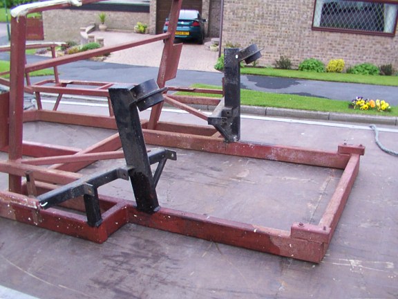

[/ QUOTE ] Yes it is, if you have the time, patience, this guy is/was/has done it http://www.gt40-kva.co.uk/construction.html
I have a KVA A1 chassis that I was going to modify, but have decided to use it for basic measurements and build a new chassis from scratch, it depends how much work you want to put into it /ubbthreads/images/graemlins/crazy.gif

The GT40 Enthusiasts Club has just appointed a Technical Secretary to the committee and he has plans for modifying your type of KVA chassis which he is sharing with other members.
If you join the club, you could get all of the info you need.

The picture you have posted look like how my rear chassis is set out. It is good to know that I could indeed modify my existing set up to the later C-type layout. Time is not a problem as I am in no rush to sort the car.
