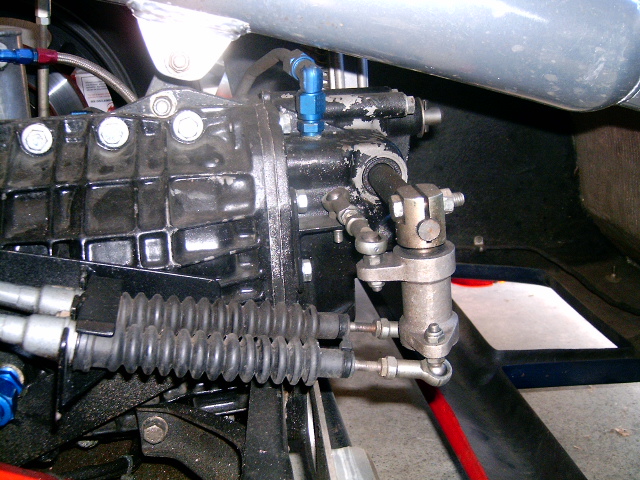

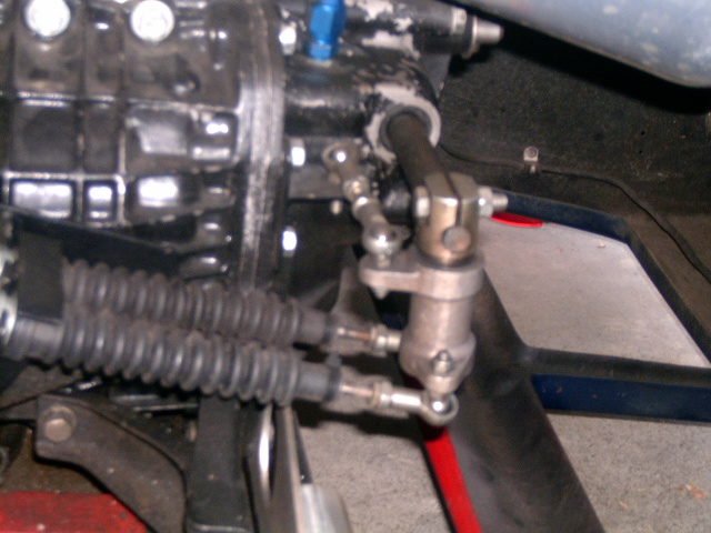

Steward. When you look at the translator, is it vertical. I mean, is it 90 degrees to the horzontal plane of the cables or said another way, 90 degrees to the centerline of the main shaft of the gearbox. I have found that if it is at too much of an angle, either leaning forward or backward, then the car is hard to shift.
The translator is the thing that the cables go to and is clamped onto the shaft comming out of the gearbox.
This really makes a big difference in how well my R21 shifts, check it. I would say that at 50-60 degress or 110-120 degrees I can barely get into 2nd gear on down shifts. At 90 degrees it shifts so well that I don't think about it.
No it's not at 90 degrees to the shaft. As it comes out of the box it's at 90 then it's been cut and welded to about 30 degrees different towards the front of the box, I will get a pic of it later.
I can't see how that would make a difference but will give it a try if I can, obviously me gear cables would have to move and I don't know if I have enough slack to move it that much.
I suppose I could go 90 90 so it moves forwards then drops straight down?

Here's a couple of pictures of what I am talking about. Not quite exactly 90 degress but you can see what works for me.
