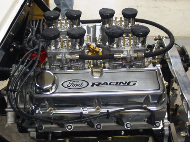

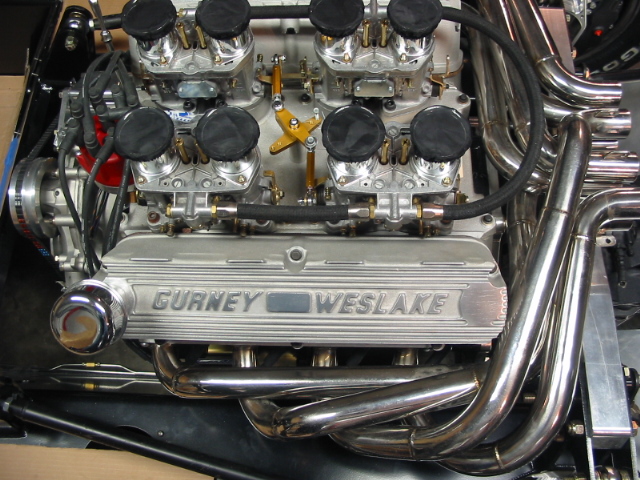

I also used T and L for my engine. They were promoting a 347 with Webers, but I wanted a true 302 with Webers. A bit less power, but hopefully more compatible with the Audi tranny. At 360 HP it is pretty close to the original. The car will be used primarily on the street with only a bit of track time. I talked to Lloyd at T and L several times and he was most accomodating. Took a bit longer to dyno and set the carbs, since T and L was not used to such 'small' engines. Here are some pics with the Ford Racing valve covers as shipped and the Weslake Guerny covers that replaced them. I have not yet fired it up, but sure do like the way it looks! If you want more details on the specs, let me know.

My apologies for the thread drift... that fuel line looks like it was pulled right out of the 60's, Chuck.
Excellent!!
T.
