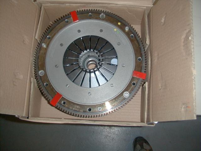

Can anyone tell me what the tooth count, O.D. and tooth thickness is for the Ricardo tranny starter ring gear? I obtained the clutch assy without the ring gear. I have contacted Ricardo, Stillen, AP racing, Ford, and others trying to source the ring gear but hit a brick wall. I think I can match something up with some modifications for less than buying the whole assy.

Thank you gentlemen. I need the number of teeth, thickness of teeth in the for/aft direction and the outside diametor. I seem to be getting conflicting information from one person who heard it from another.

Pete, The diameter is 11 21/32 inches or 296.068mm tooth front to rear is 5/8 inches or 15.875mm 140 teeth part#467V7B546BB
