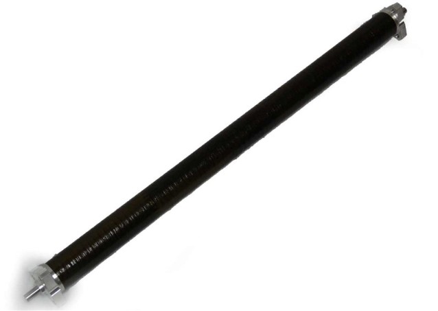

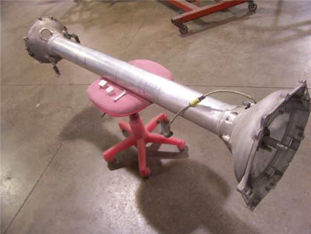

Torque Tube lenghtened 10 inches Carbon Fibre drive shaft.

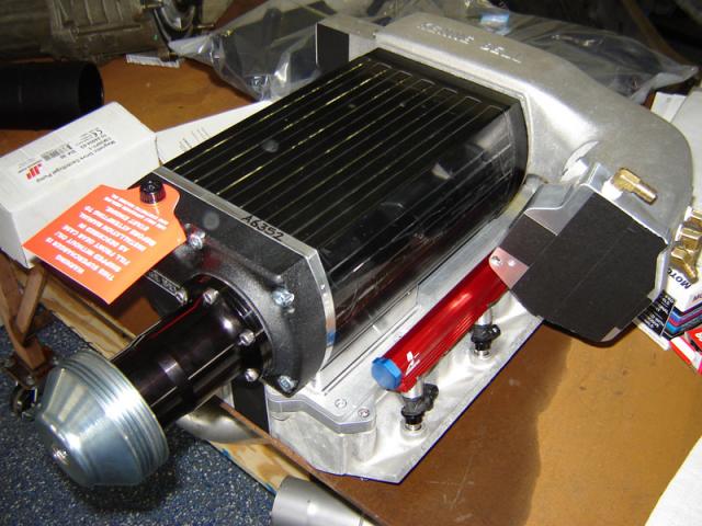

Kenne Bell Whipple Supercharger.

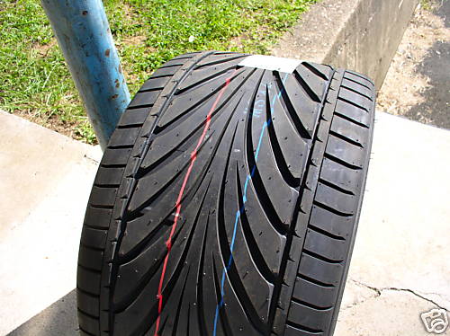

Toyo 345/25/20 245/35/20 tires

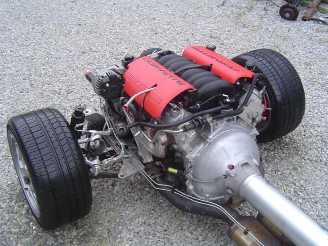

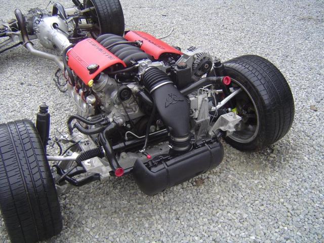

Heres some pic's of the parts

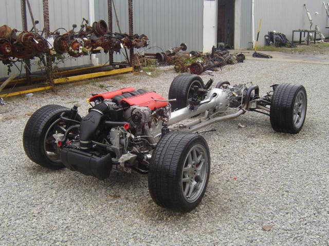

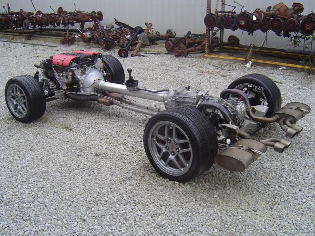

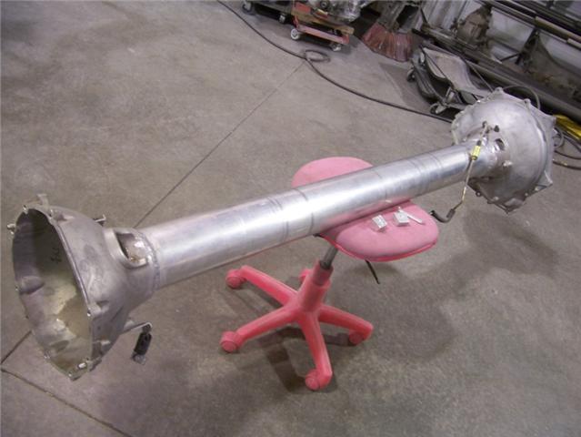

I got a rolling chassis from ebay, the car was a 2004 ZO6 with 31,000miles on it. The conversion is straight forward except for the torque tube which was legthened 10" to match the One tonners 114" wheelbase. The rear chassis rails are modified width wise, this allows the 13" wide rims to fit. The parts that where expensive are the driveshaft and the billet RHD Corvette steering rack.
Here is a video on the supercharger kit running numbers on the dyno.
It has over 600ft/lb torque from 2000rpm, hence the 345 tyres on the back
http://www.youtube.com/watch?v=gLBHsFYsIck

The best part about buying a rolling chassis is the parts that come with it. Steering coloum, brake booster, twin fuel tanks, exhaust, brake lines, full wiring harness, pedal assembly, radiator etc......
Pic of the lengthed torque tube, always wondered watching F1 when I would run a Carbon fiber parts in a road car.

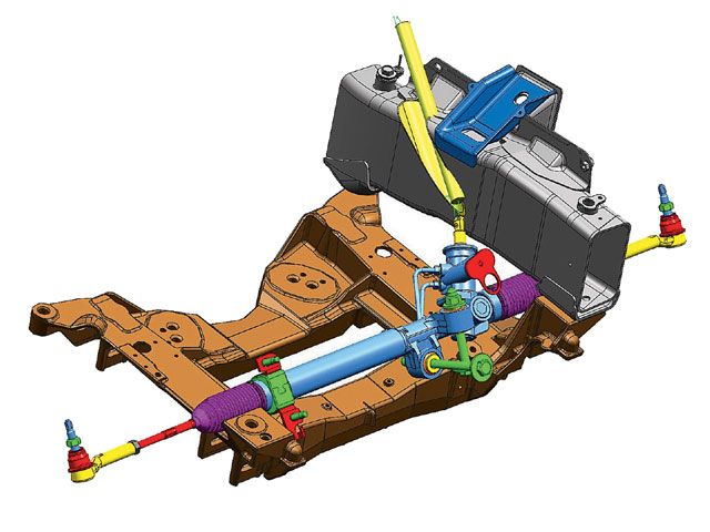

The corvette suspension cradle is easy to adapt to older style chassis.

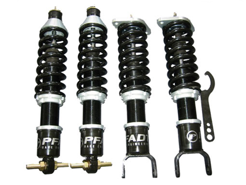

The corvette leafs are being replaced with coil overs, mind you the C5 can still pull 1.03G on the skid pad.

Billet RHD Corvette rack.

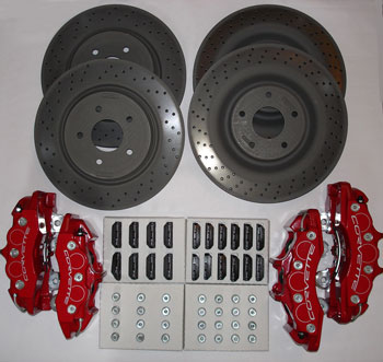

ZR1 Brembo brakes.
Cheers, sleeper yes until you see the arse end of this ute. If just order my brakes and rims, love GM.
ZR1 Brembo 6 spot 15.5 inch (390mm) Carbon ceramic rotor front
ZR1 Brembo 4 spot 15 inch (380mm) Carbon ceramic rotor rear

Tyres 285/35R-19 F 345/25R-20 R
