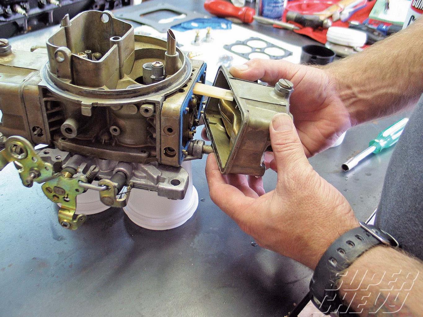

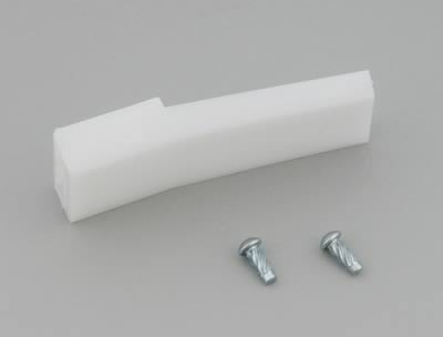

The main issue as has been said is fuel slosh under acceleration, braking and cornering. the biggest force comes with braking. Fitting the plastic box tubes called "whistles" in the fuel bowls can fix this to a large extent.

Hi guys thank you for the replies ... I have a performer intake .. I put the carb on same as you Mike because fuel and linkage fits better . So hopfully not a problem then ....
Thanks again guys John..
Mike Pass
I have a Performer RPM intake - dual plane. I have used both Holley 600 cfm vac secondary and 650cfm double pumper carbs which have been OK. I fit the whistles. I also use a 5 degree wedge plate under the carb to bring it level as I have a Renault box so the engine is tilted down at the front.
