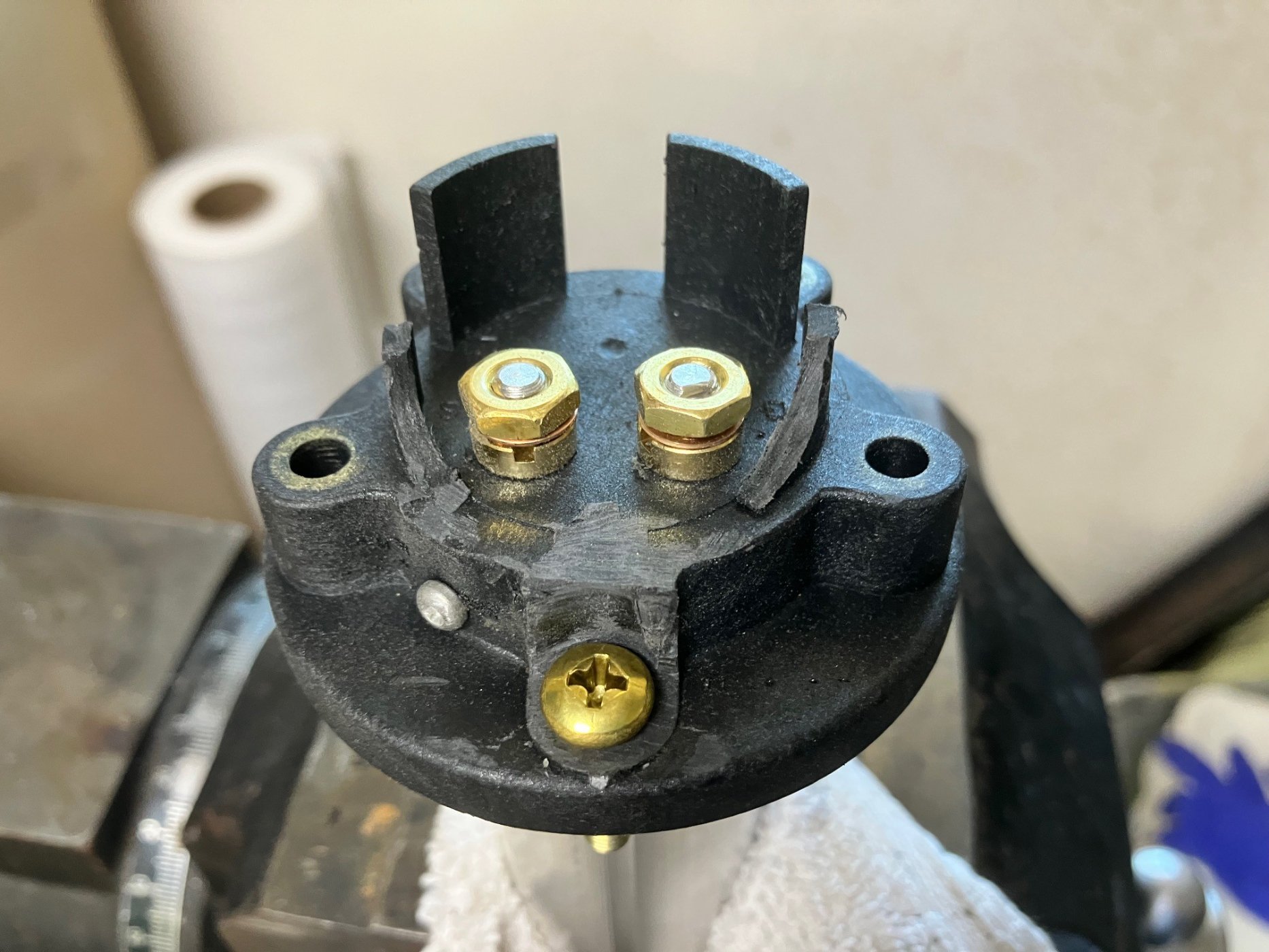

I received the new fuel sender from Fran which is a resistant style from Classic Instruments. Getting the Koso gauge programed to work with this sender was pretty straight forward but you have to use the custom resistance settings because the resistance is "0" ohm at empty and "90" ohms at full levels which is the opposite of what the Koso is preprogramed to look for. I needed to tweak the full level setting to 85 ohms because it would not register "full" at any value greater than 85 ohms. This sender is also easier in that it doesn't need to be programed or needs any switched power.
In the install the front screw mount and the tabs on the top of the gauge needed to be reduced in order for the closeout panel to fit over the sender. Hope this helps anyone else that may be coming up against this problem.
