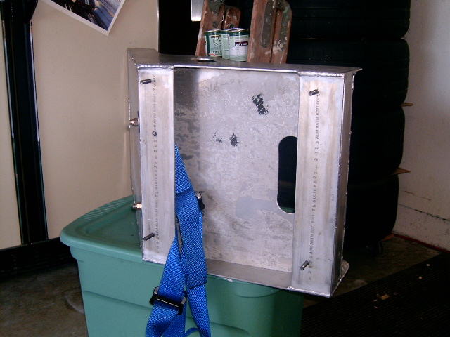

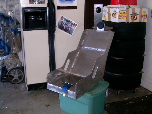

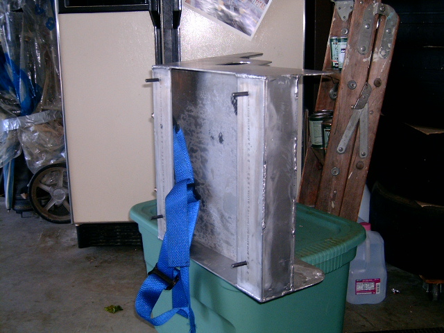

Here's how I did the crotch straps. I only use them with my track seat so they go with it when it comes out of the car. The seat itself isn't adjustable for and aft so the crotch straps remain correctly adjusted. The seat itself is very securely attached to the chassis with four 3/8 bolts
