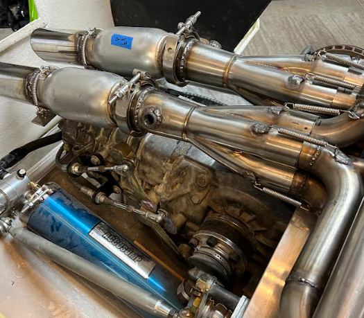

FEAST YOUR EYES ON THE FINIEST TIG WELDING TO EVER BE COMPLTETED IN THE NATION!!! I'll weld your exhaust as well for the measly sum of $1,000,000 a minute, (travel time is charged still). I just need to find time between the many trips I promised to SpaceX this year already to put my TIG welds on their rockets as well.

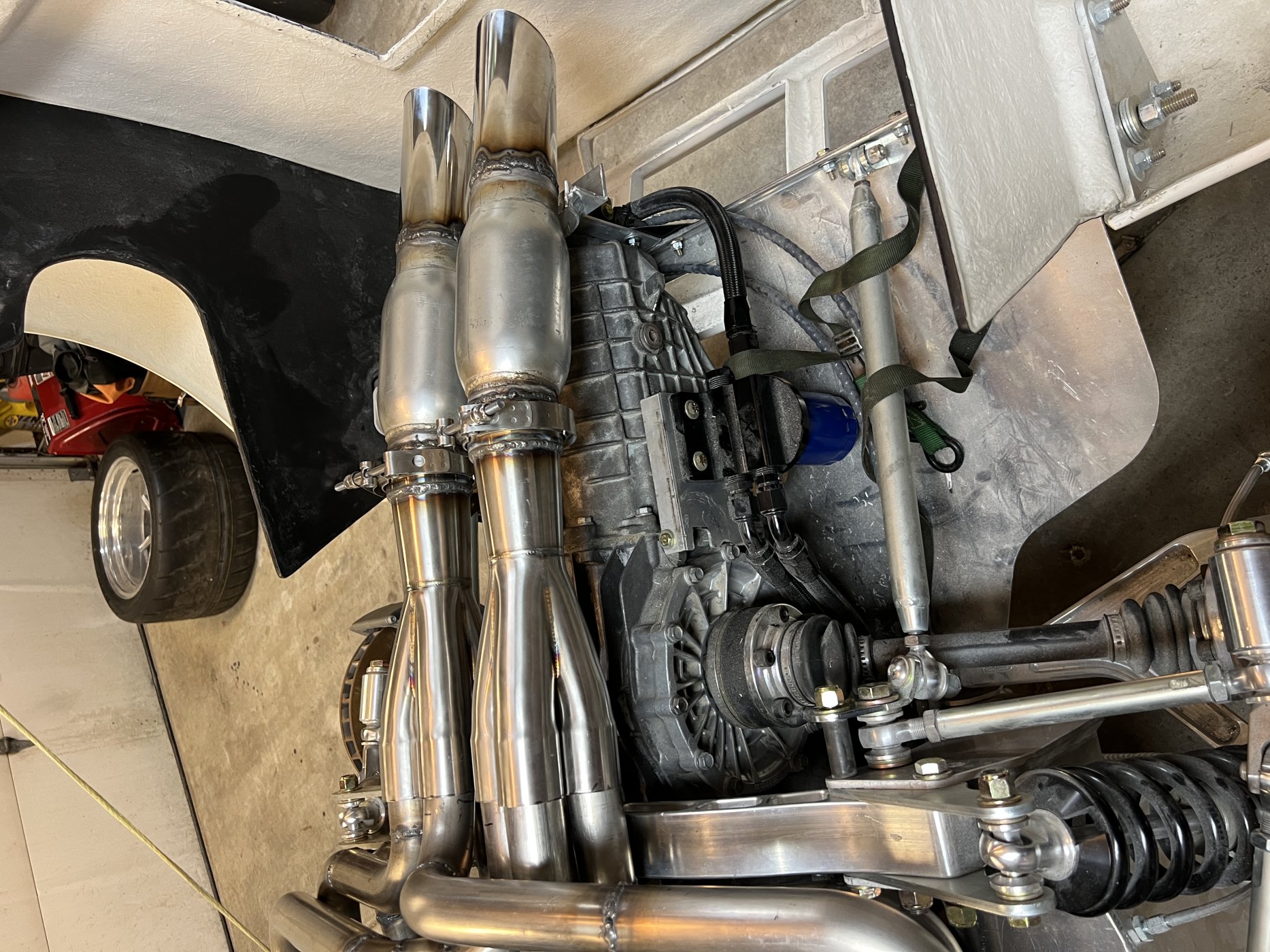

JK holy cow is TIG welding hard LOL. Turns out I had it in my head backwards on what part would be easiest/most difficult. I figured that welding the tubes together would be hard and welding each tube end to the exhaust flange would be easy... SO WRONG lol. Turns out that the large thickness of the flange compared to the tube gauge made welding much trickier and sure exposed my honestly 1st grade level of skills. Well after many days, several mistakes, and foul words... we finally prevailed.
We still need to put the finishing touches on the exhaust like welding on the mufflers/tips/v-bands and O2 sensor female bungs. But at this point it is quite the relief to see just the primary exhaust system fully welded in and installed. This self built exhaust may be one of the most difficult thing's we have ever completed lol.
For those considering your own self built exhaust, some tips:
1) when welding each tube into a thick header flange, be sure to clamp down each end of the flange to a flat surface. The heat from the welds will quickly try to warp and ruin the exhaust flange. We caught this just in time and it was quite alarming lol.
2) Whatever time you budget to complete this, double it lol.
Up next after finishing the exhaust will be figuring out how to coat them (maybe jet-hot ceramic?), and then wiring everything along side finishing up the body.
Looking good. I agree that tig welding these small pipes was a big challenge. Its hard to keep everything in line, feed the filler rod and move around the pipe keeping the angle of both hands correct. I cannot confirm nor deny that a few of my welds had been ground a little with a cutoff wheel and the tig torch ran back over them to make it all look pretty.

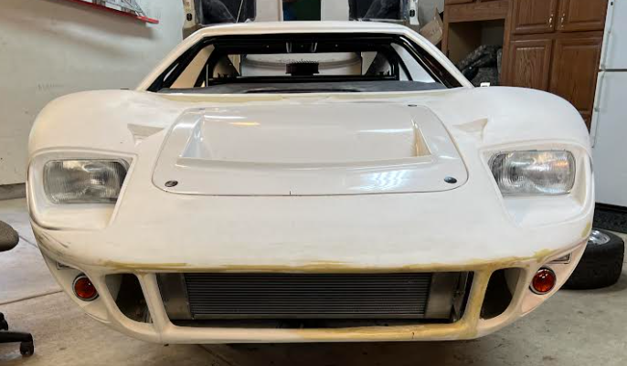

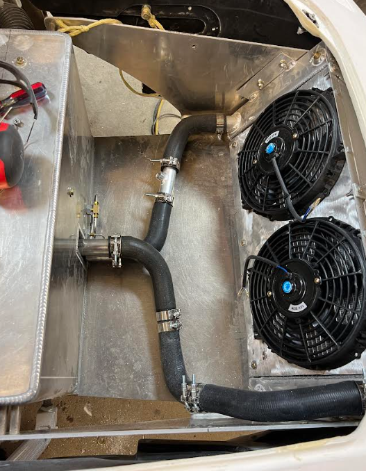

Finally finished the radiator hoses. We just went to the local autoparts store and looked around their in stock selection for radiator hose bends that seemed useful. It was a better deal than just buying 90 degree universal hose. I wanted a coolant temp sensor for after the radiator to monitor real-time cooling performance. I found a nifty prepaid tube that worked out perfect. It just clears the front nostril panel, so I think minimum modifications will be needed in that area.

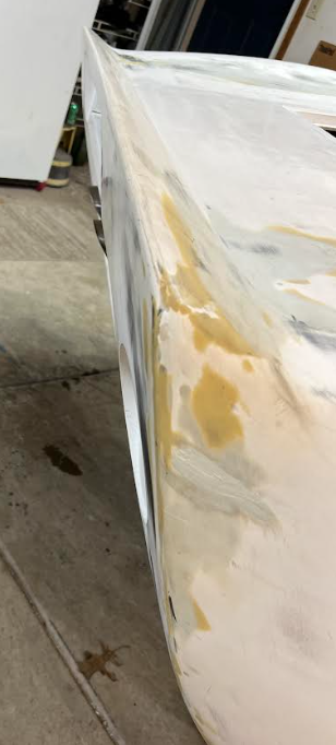

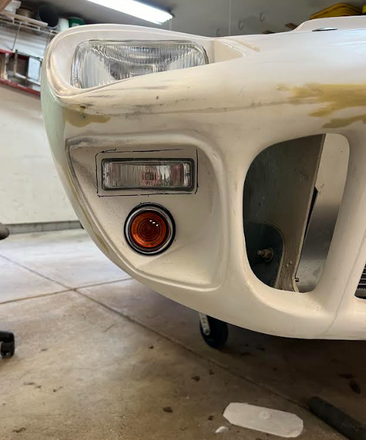

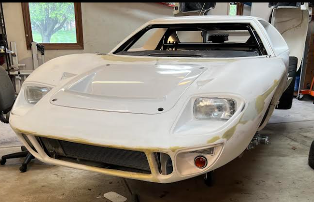

Holes are cut for the fog lights, turn signals, and head lights. Really happy with how they turned out.
Things are starting to look like a real car!!!

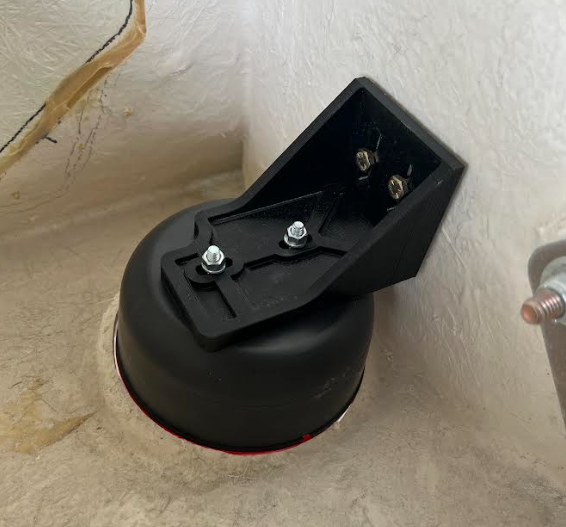

I ordered the amazon fog lights pointed out previously by Vinny (THANKS VINNY!). They worked out great, and I am excited that they aren't sealed beam units so the bulb is simply replaceable. I ended up taking off the rear covers though, as they were clearly not water proof anyways, and with them off the installation was 100 times easier as the glass lens had a lip that can cleanly butt up against the fiber glass. The old screw holes for the plastic cover could be re-purposed to mount the lens from the back side. For the money, I think these are awesome. They may be a bit dim though...
How did you mount the headlights on the backside?
I recommend Jet Hot coatings. They did a fantastic job on mine; the coating also helps to hide the welds a bit too.
I am talking with jet hot, might be a bit pricey though.... I really wish powder coating has improved further... Also we may just wrap them in header wrap for now to make sure they don't need adjusted after startup/break in tbh.
I plan to fiberglass in some aluminum tabs to the clamshell to accept bolts, and 3D print some brackets to securely hold the headlight. TBD exactly what shape they become though... that's on the to do list lol.

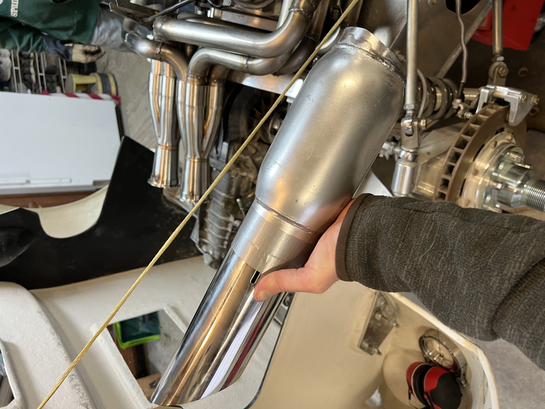

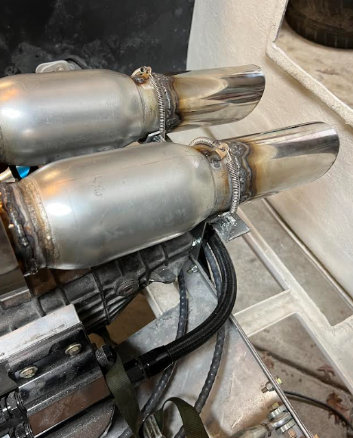

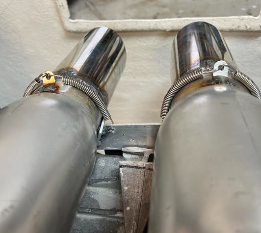

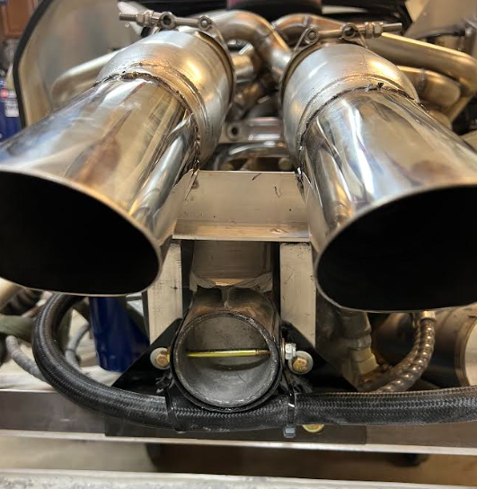

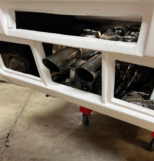

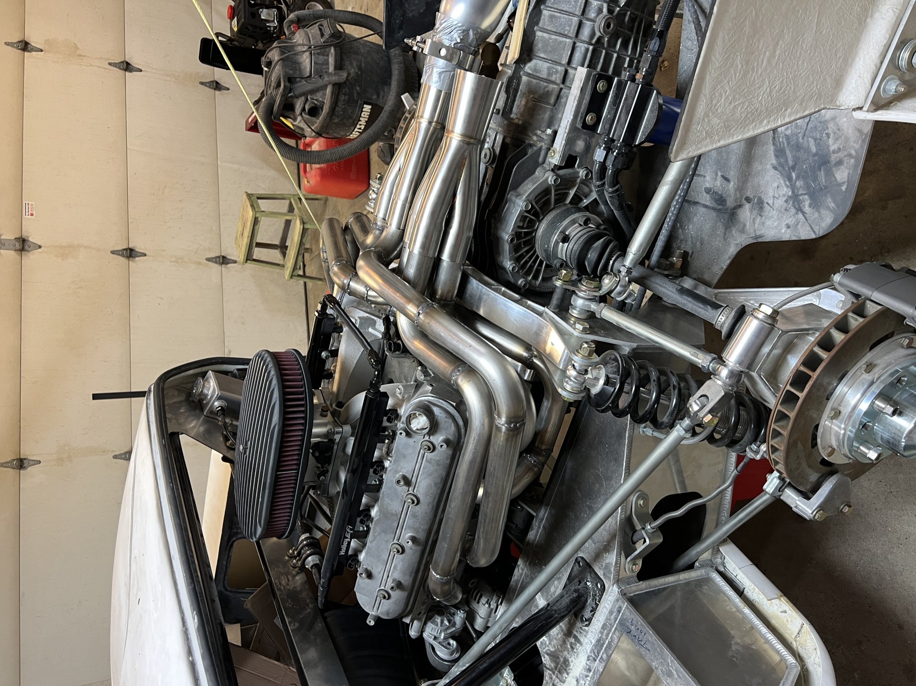

Okay so the first step was to weld in the mufflers, v-bands, and tips.
duct tape = TIG welds right?

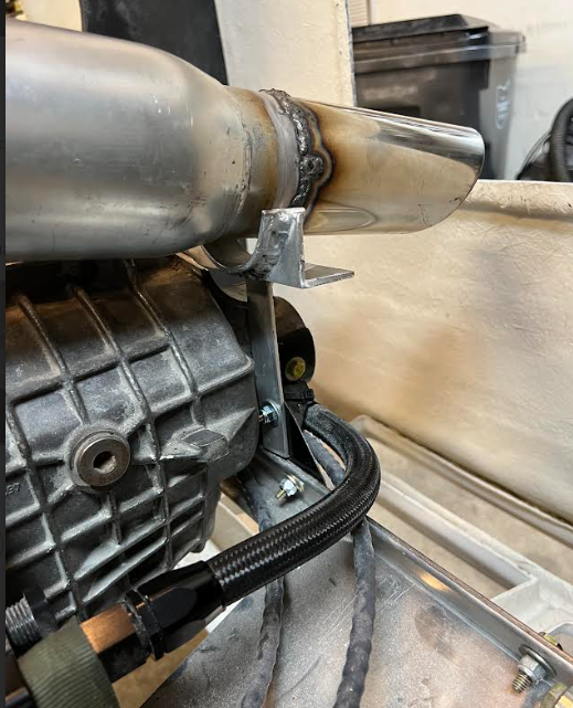

with the final parts welded in, it was time to finish up the mount system to securely hold the tips down.

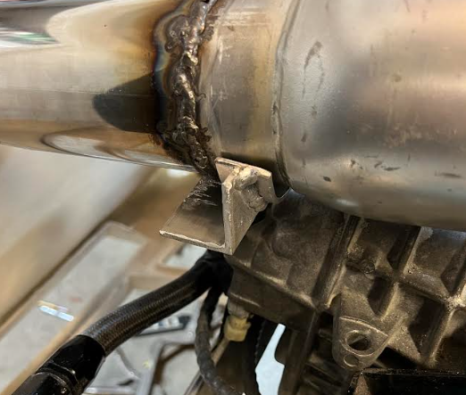

Above you can see the rough aluminum piece I welded up. Below as well.
on both sides of the transaxle we ran "arms" down to bolt to the same brace that ties the transaxle to the rear chassis.
rear view
then came the springs a mounting tab that came with them. just simple set from Jegs.
final images of the tip positioning for the time being:
It took some tweaking to get the tips to be about centered and out of the way of the rear clamshell so it may open and close.

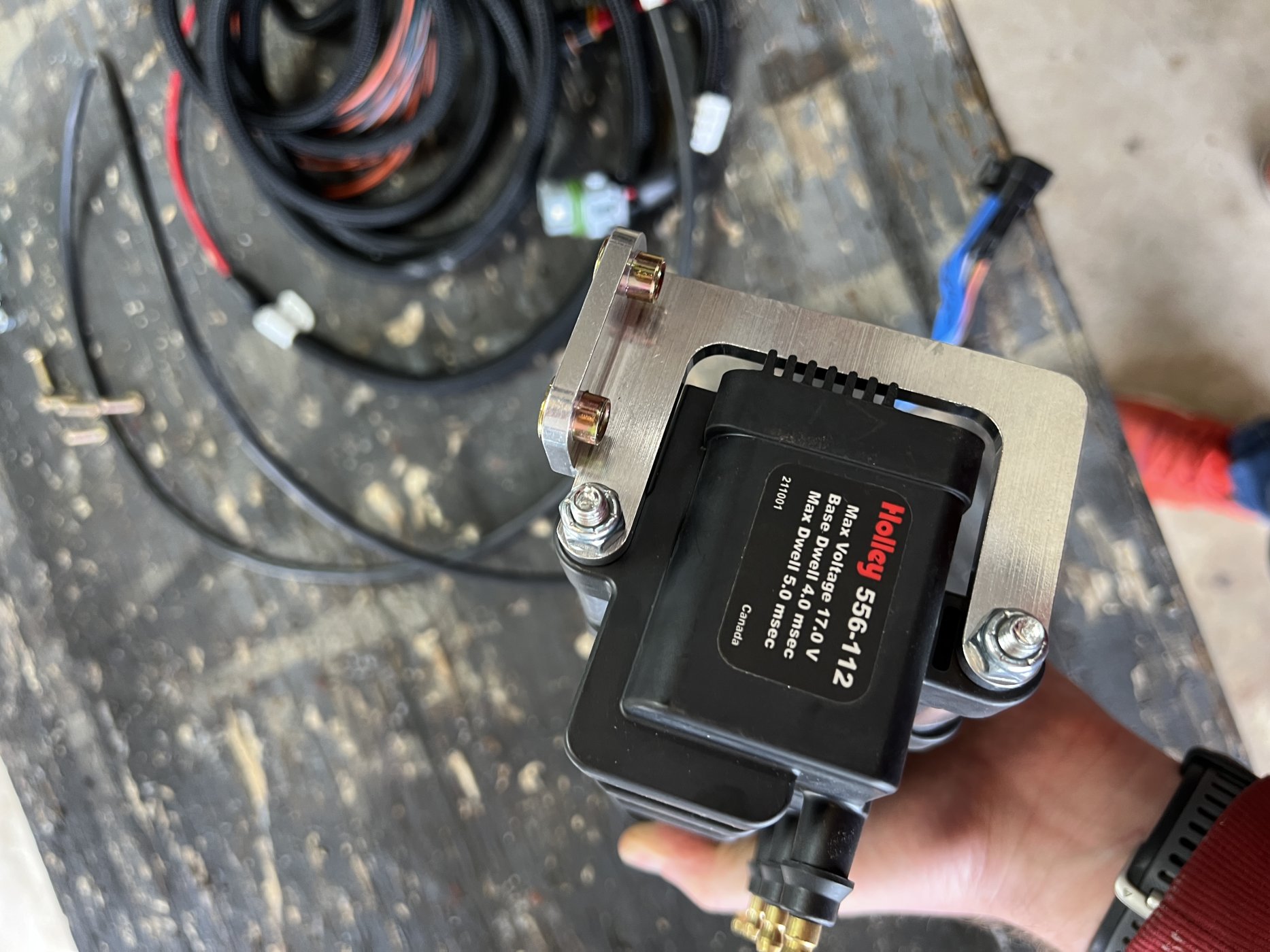

My objective is to "hard mount' all electrical devices prior to crimping or soldering a single harness. For example the headlight and taillights and coil packs should be bolted/taped into the car, I think.

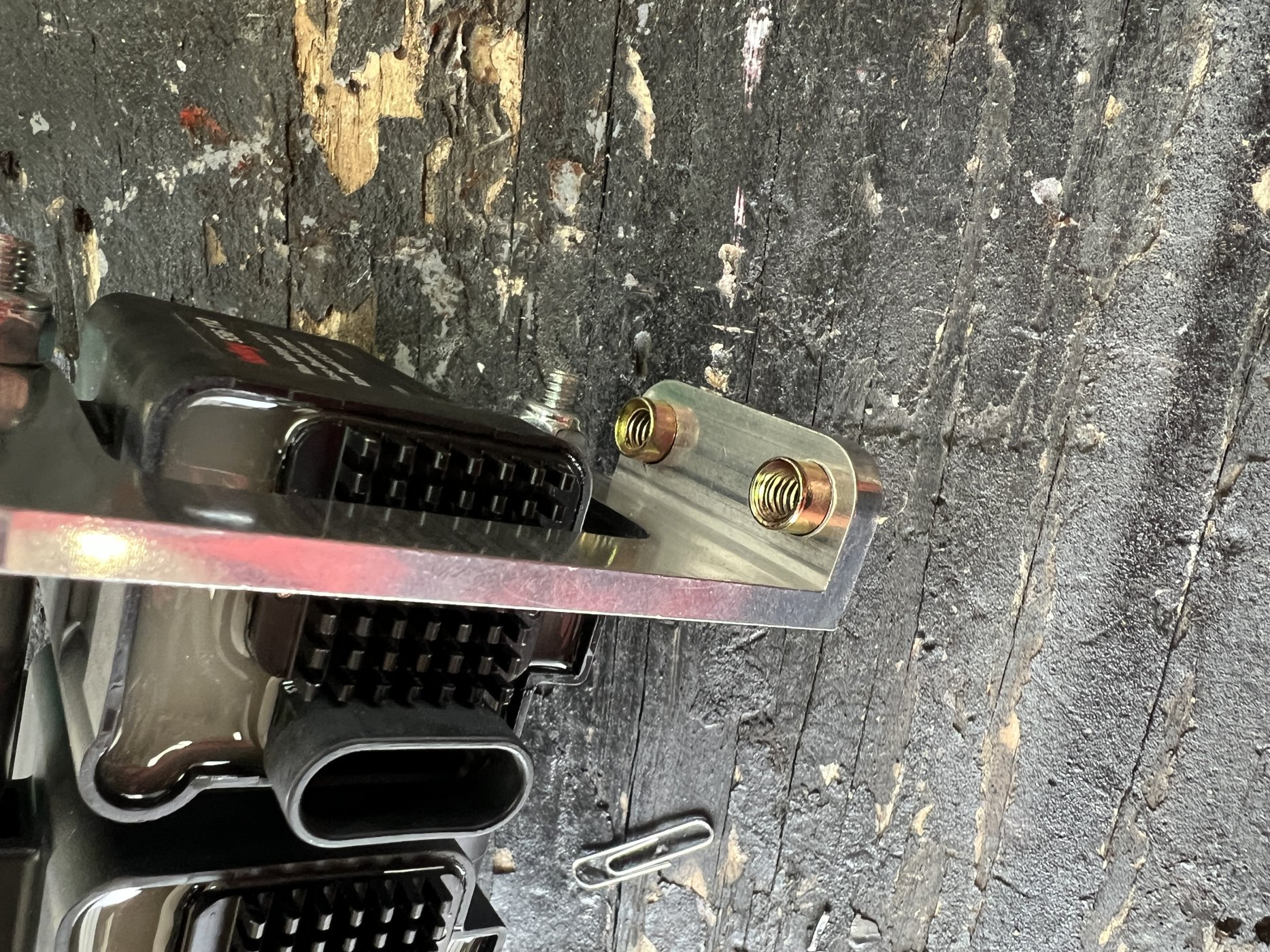

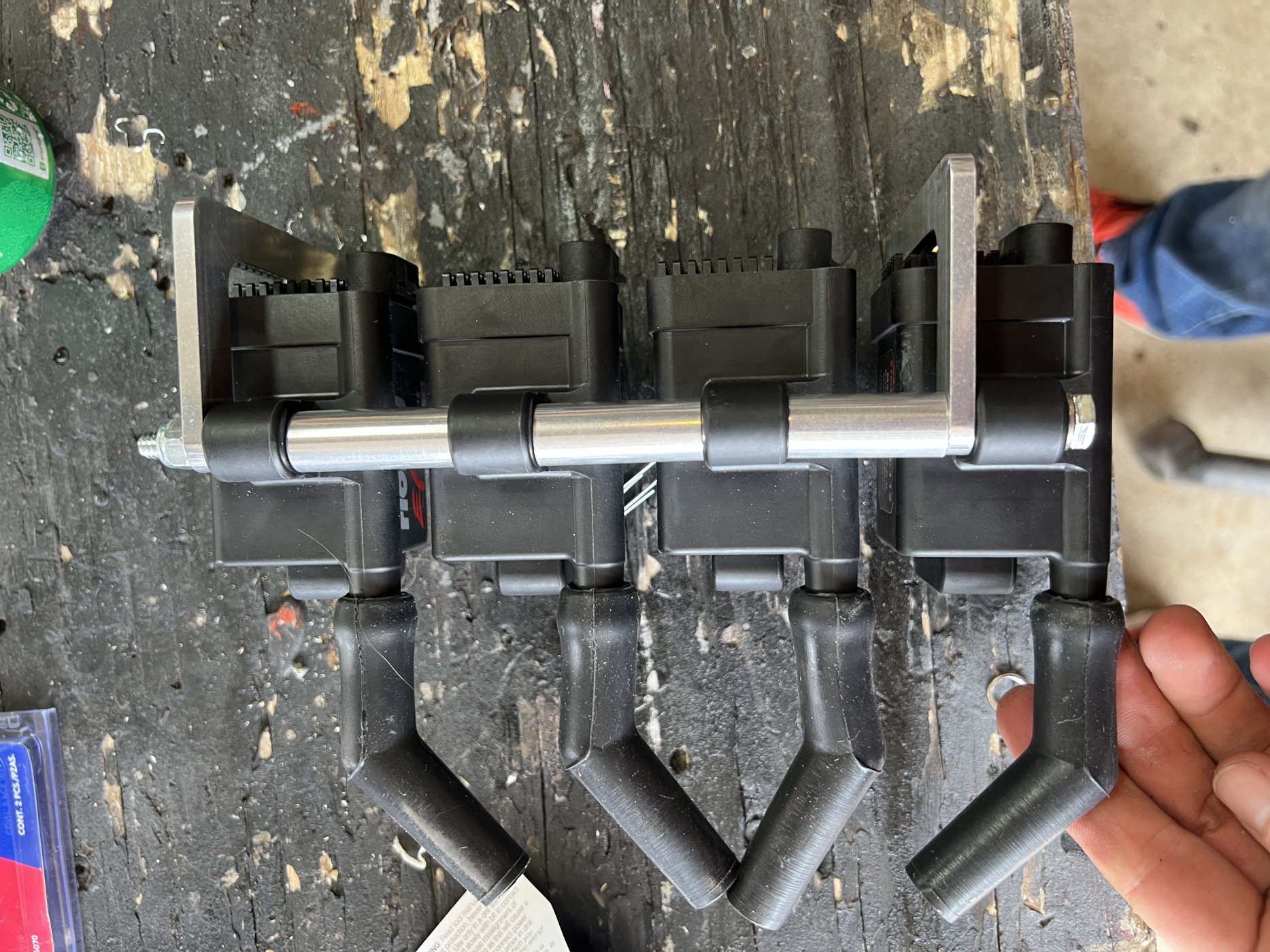

Shown below are the coil packs with an integrated bracket. The decision is to 'remote mount" the coil packs down in the chasses of the GT40 to protect them from heat and its a convenient way to keep the spark plug wires away from the insane heat I am sure the headers will radiate. The final bolt holes for this mounting bracket we ordered haven't been drilled as the engine unfortunately will need to be pulled. Good news is that was planned anyways soon as it will need the pilot bearing and clutch bolted on. A spark plug wire kit lets us crimp the wires with either 90, 45, or straight boots as well which is helpful.
A riv-nut tool is great for avoiding any annoying nuts when bolting this coil pack assembly in as well.

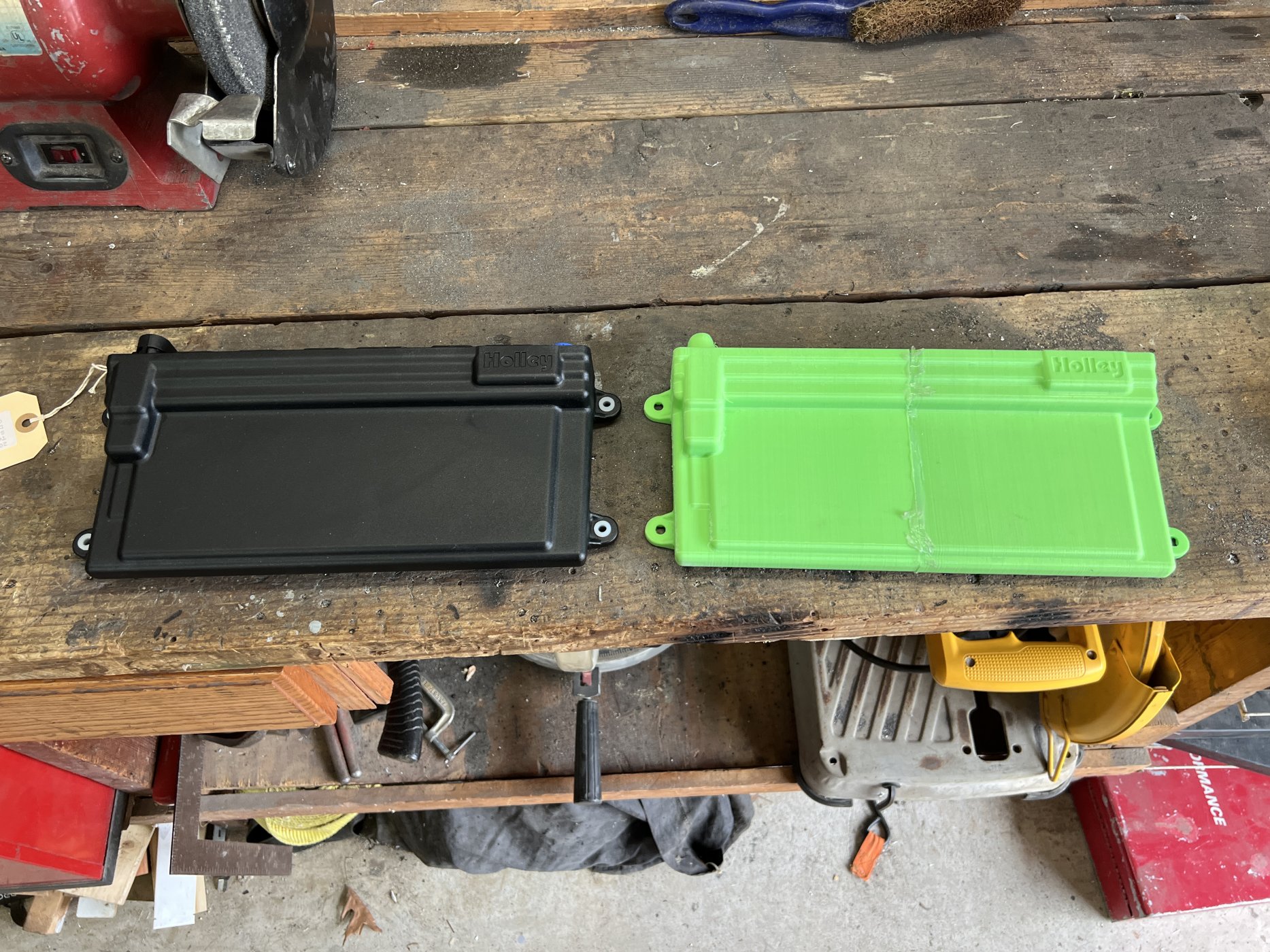

In the interest of figuring out where the ECU that will run the entire show is best mounted, I 3D printed a replica as banging around a $0.20 printed plastic chunk sounds much better than the real component lol. Holley posts .step files of the ECU case which made this simple to achieve and seems quite realistic. I really wish posting .step files online was a more common practice among more companies.

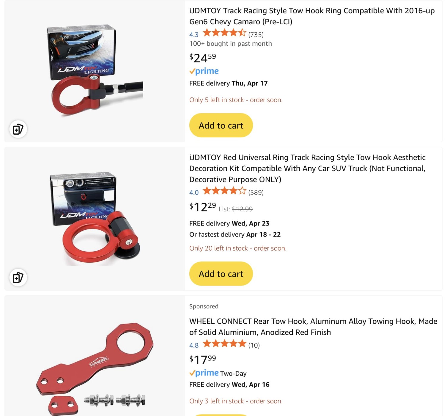

Also got side tracked by trying to decide on a FR and RR tow hook for the vehicle. Hoping others can share input on what you decided to do as well. Below are a few examples that I am considering for FR tow hooks I've found. If you like your own setup it would be super helpful if you share images of how it is designed and mounted to the chasses. I can't really find much on RR tow hooks so hoping to have some input there for sure.

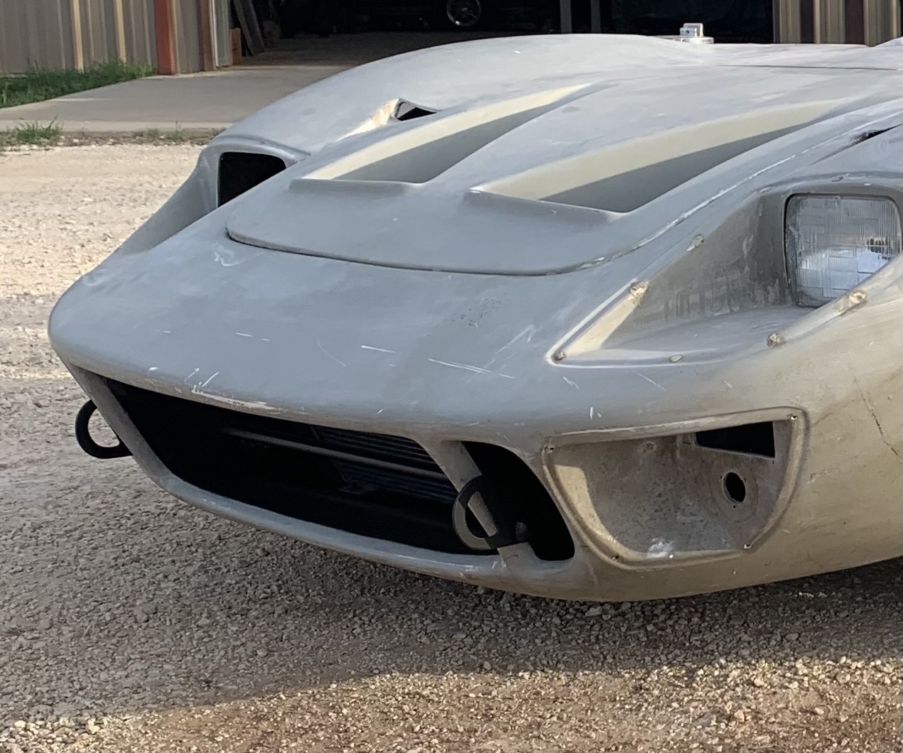

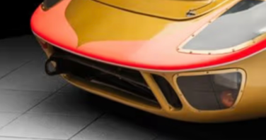

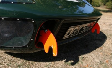

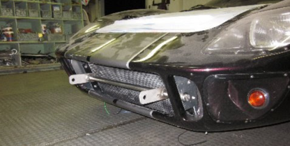

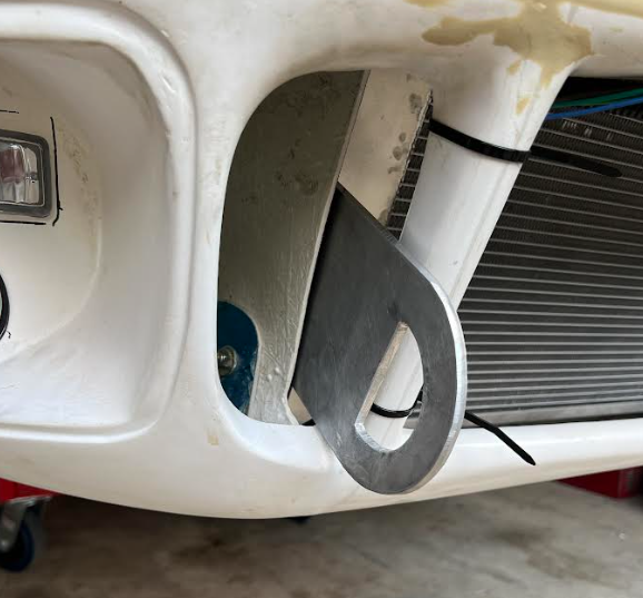

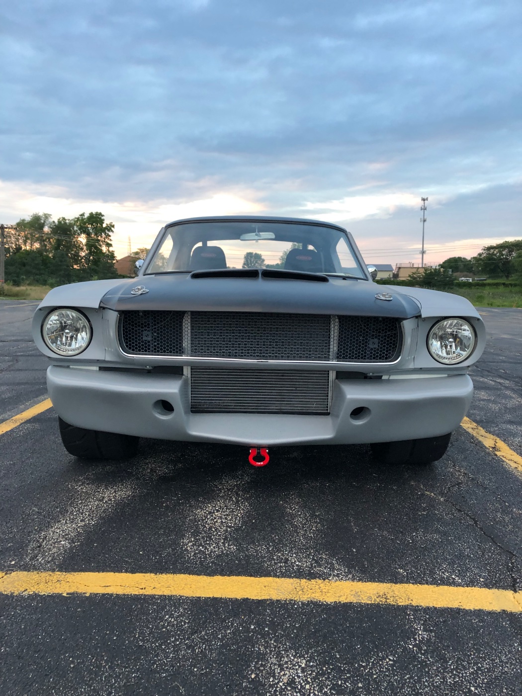

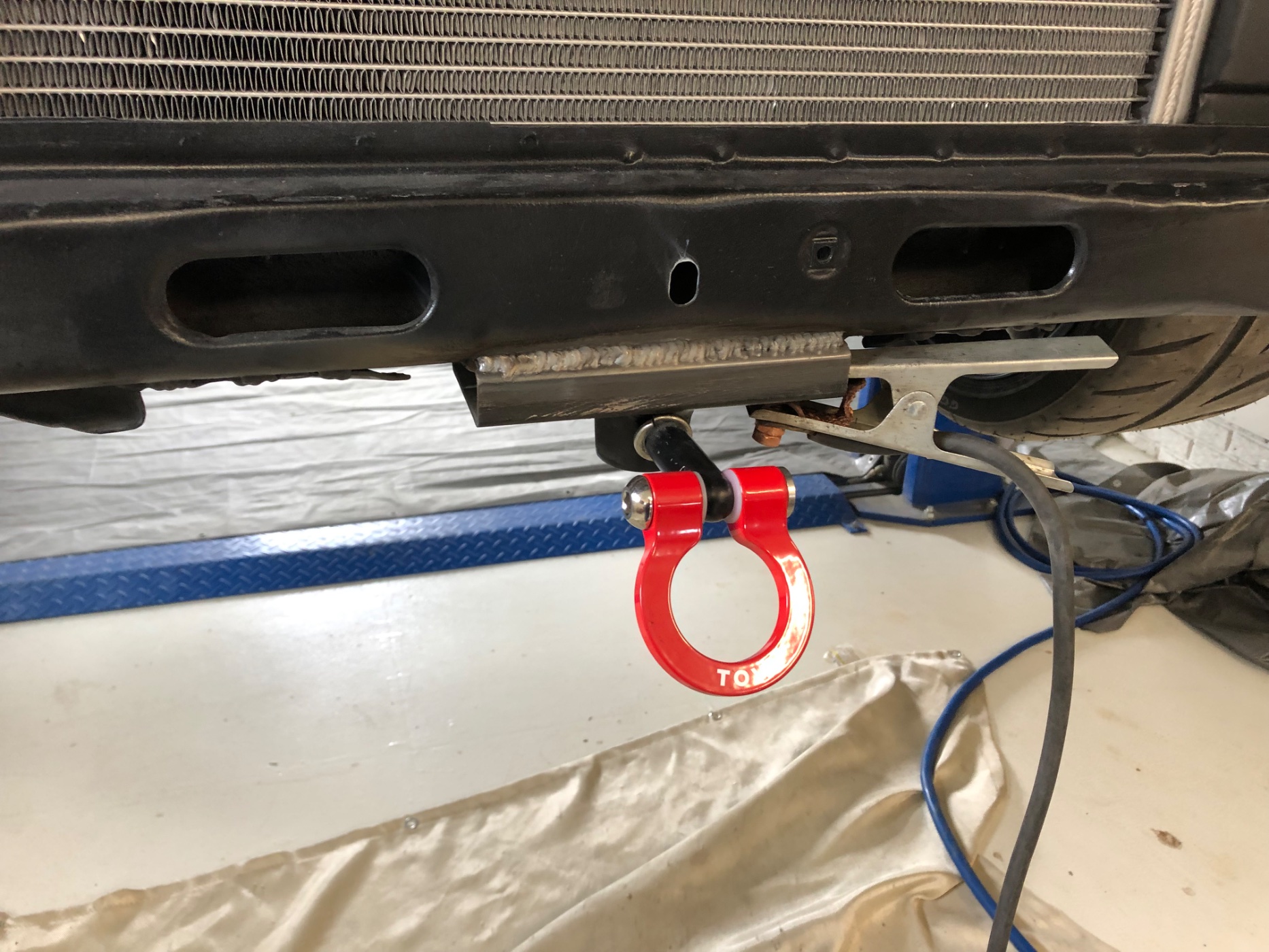

Here’s my version after going through your same struggle. I will use these for towing and transport tiedowns for the front. As far as a jacking point, the front two corners of my front subframe (also where these connect) are reinforced to support & accommodate lifting. As far as the rear I plan on using 1 or 2 (depends on how it looks) of the following types of hooks. Obviously not the middle one…
Thanks for the reply! Can you please share info/images of how the FR hooks are mounted to the chassis? Also have you planned out how the RR hooks will mount to the chassis? Transportation tie-down points are also my main goal here, forgot to mention that originally.
I’ve got a little different construction than your RCR but you can see how I did it in my build thread.
Post in thread 'Classic HorsePower Scratch GT40'
https://www.gt40s.com/threads/classic-horsepower-scratch-gt40.56682/post-590028
The rear on my frame has a couple good options for 1-2 hooks…you may have to fabricate a plate or bracket that bolts to the rear of your transaxle or where your clamshell is supported & pivots.

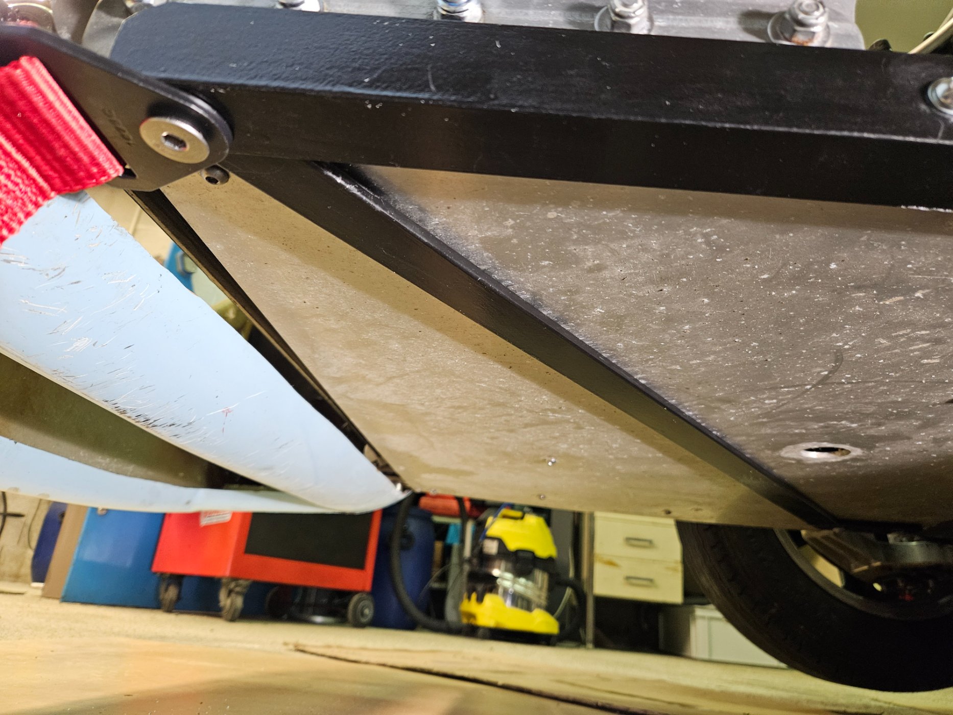

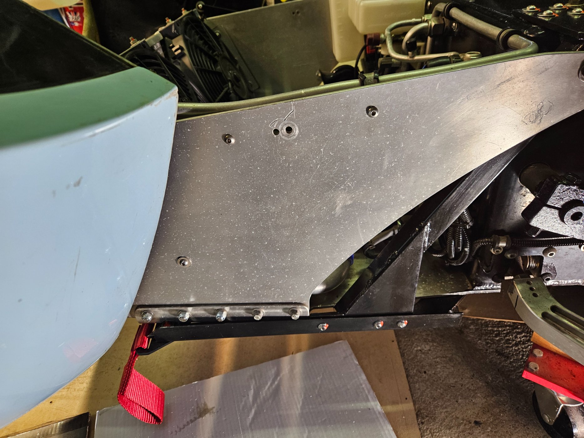

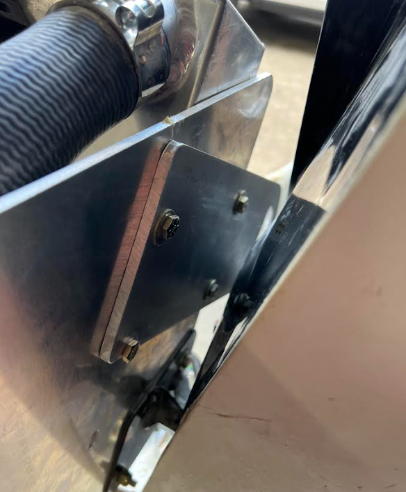

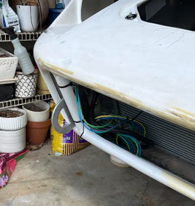

Nick, to adapt a tow hook on front, I considered that the RCR front frame made of aluminum panels will be unable to sustand the tracking effort to extract the car out of the sand box on track side.
To support the effort I added and extra frame in steel located under the front aluminum panels that I bolted on the aluminum main cell.
2 photos, one from the side, and one from outside. The steel frame is attached to bothside of the aluminum cell close to the base of the front supsension to carry the effort from the front to the aluminum cell. And the side steel bar has the function to give rigidity in the vertical direction.
I cannot make other phot now because my car is at the paint shop.

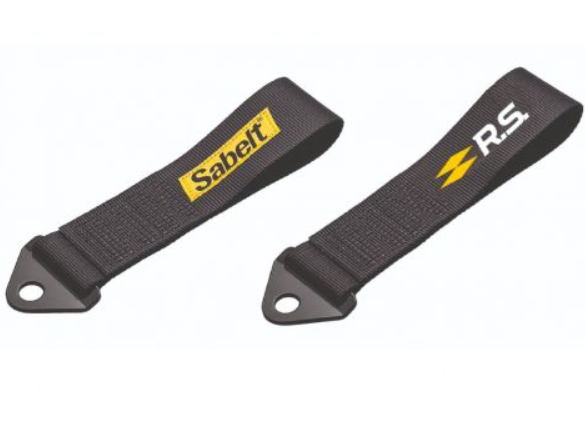

Buyer beware with cheap tow hooks. I think it was Grassroots Motorsports that tested some of the cheap tuner Amazon tow hooks. To make a long story short…for looks only.
ZL1addons makes some good ones. I think I could hang my 66 from the ceiling with this setup.
