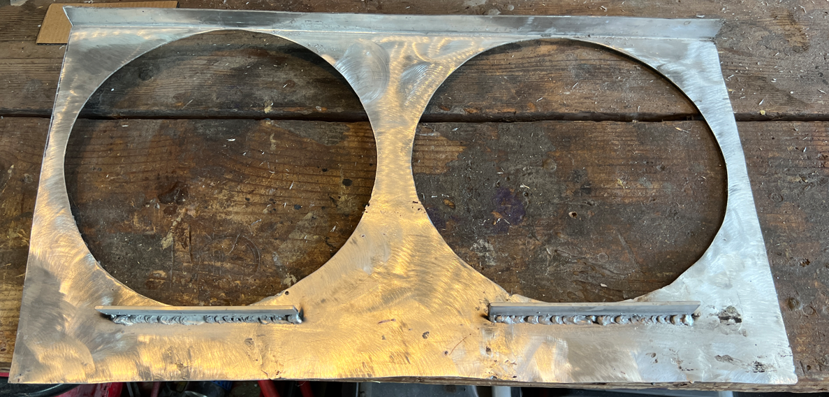

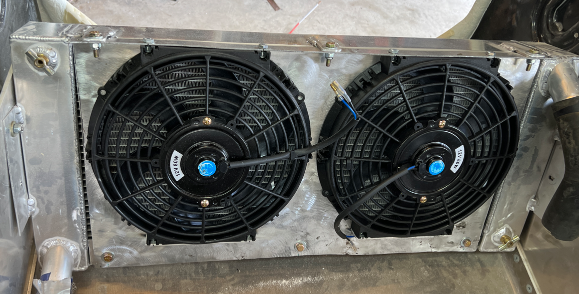

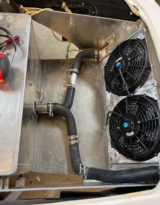

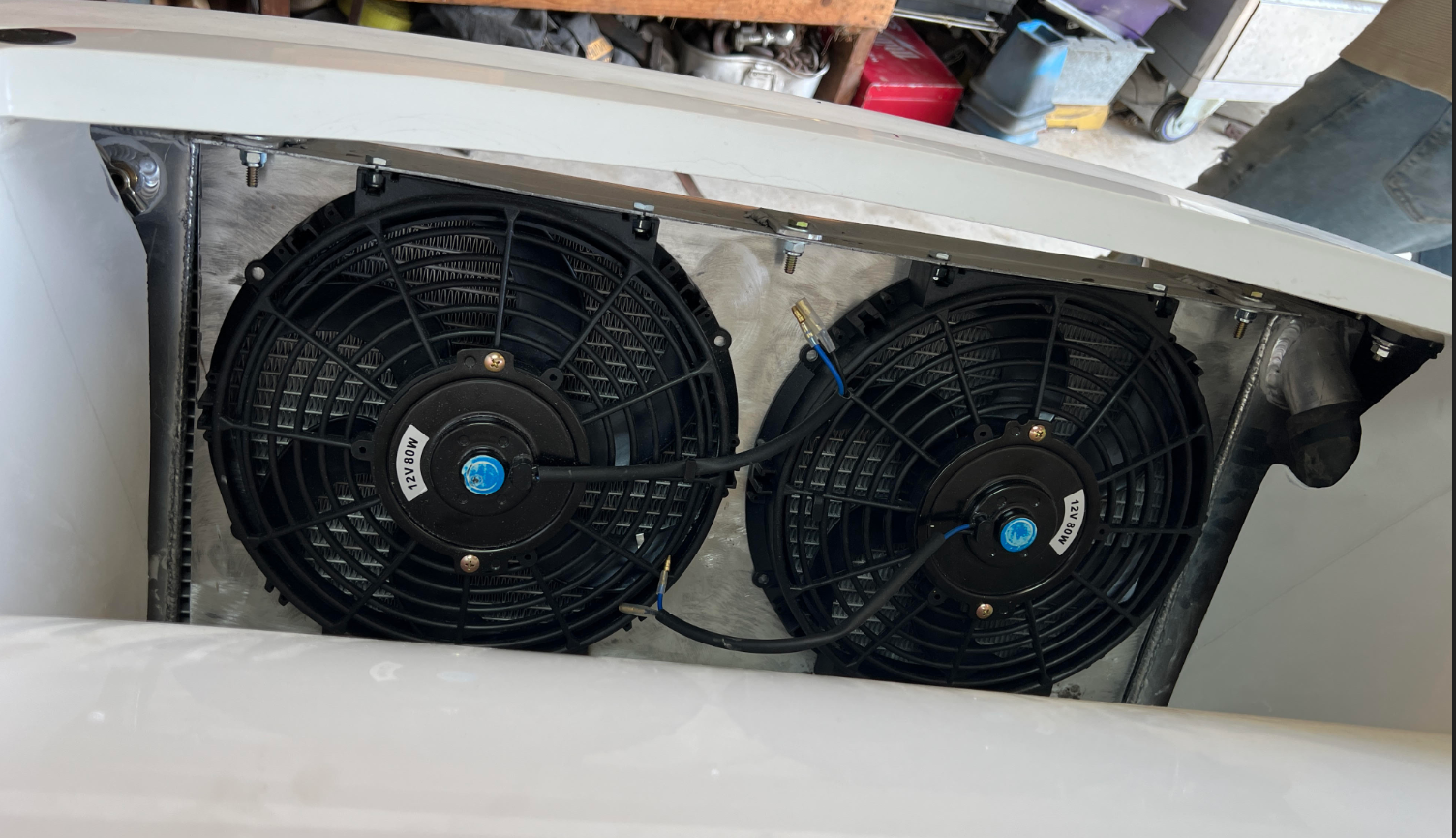

We finished mounting the radiator fans which is exciting. We mounted them using a fan shroud we built with some scrap aluminum sheeting we had in inventory.

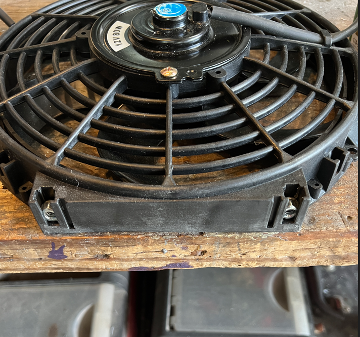

There isn't room to offset the fan shroud due to the front nostril panel, so there isn't room to bolt the fans simply through the shroud using the convenient holes in the fans themselves. Instead we decided to bolt them using captive nuts in the channels on the top and bottom of the fans. We found that 1/4" bolts fit great just slightly shaving down two sides.
I welded tabs onto the top of the radiator to bolt the top of the shroud, and then the bottom of the shroud can simply bolt through rivnuts in the empty space on the bottom of the radiator.
Really happy with the finished product. Some buffing and powder coat will clean it up nicely as well.

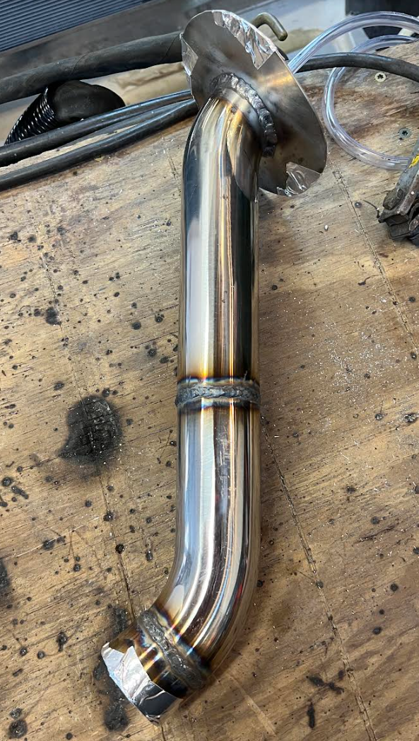

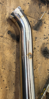

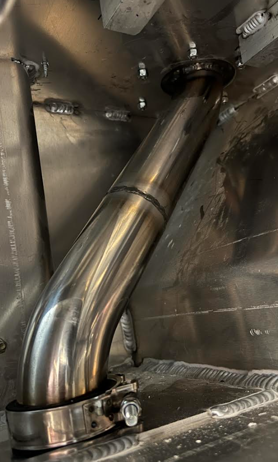

Next up was the fuel filler tubes and caps! We took heavy inspiration here from Sean's build and used 2" stainless. (aluminum is out bc well..... you all have seen my aluminum welds)
First I mocked it up using the 3D printed modeling blocks I posted about previously that were intended to be used for the exhaust. Luckily I had bends already printed that were 3" CLR so they worked great. Sadly I completely neglected to take a photo of the mock up. It made it really easy to cut out the exact bends we needed and tack weld the pieces together.

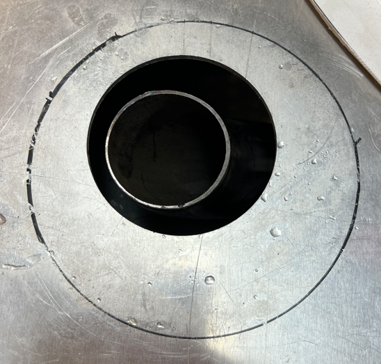

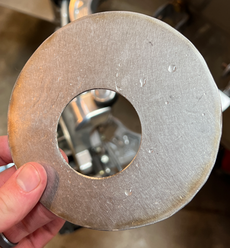

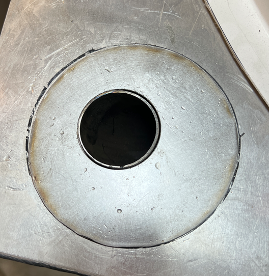

We mounted the tack welded pipe to the tank and then drew a circle around the filler cap with it positioned exactly how we wanted it with respect to the fiberglass body. This made it easy to fabricate a perfect flange to position the filler pipe where we wanted it.
It was a blast TIG welding these, and the purge system we cobbled together worked great. Definitely a confidence booster we can pull off welding the exhaust up as well.

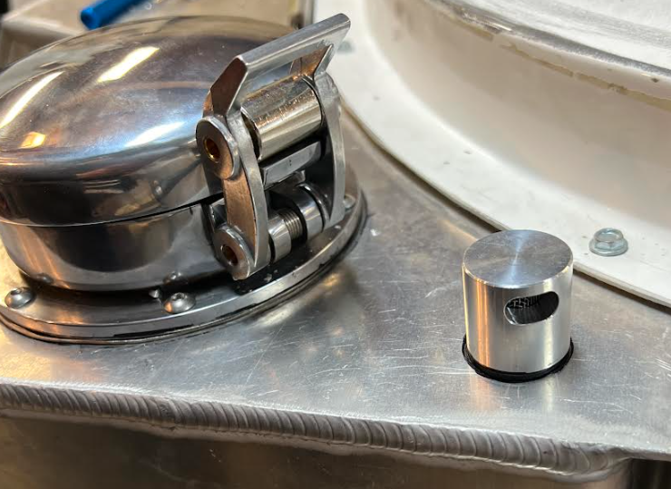

We also went ahead and installed some tank vents.
In the future we will install a seal between the filler neck flange and the filler cap so that there can't be any leaks in the event of a disaster...

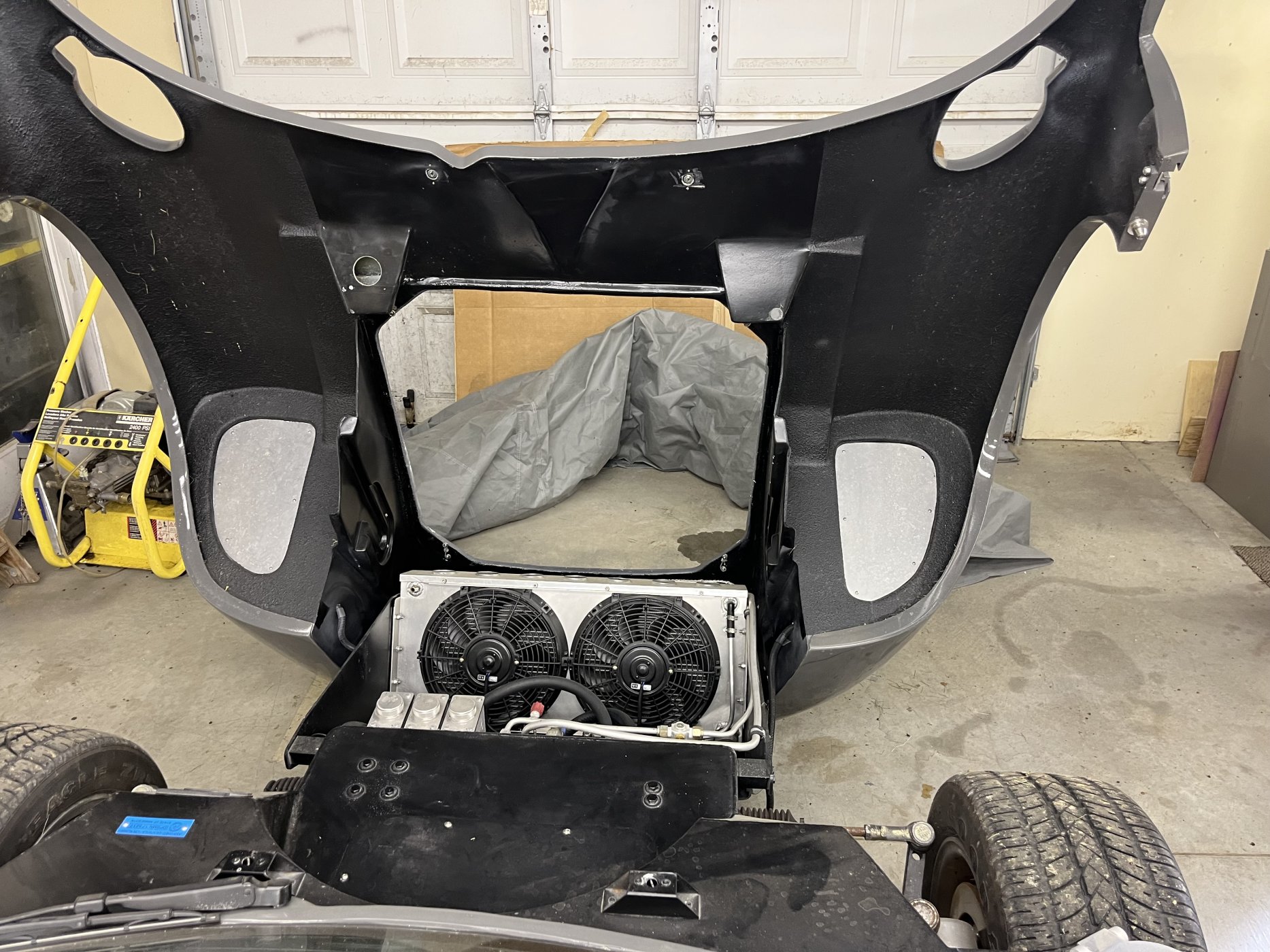

It might be just fine as long as you aren’t running it on the track. More important is to close off all the gaps with shrouds around the nose inlet so all the incoming air has to go through the radiator. Also on the back side ensure all the air has to go out via the nostril(s) so as to create low pressure.
Finally finished the radiator hoses. We just went to the local autoparts store and looked around their in stock selection for radiator hose bends that seemed useful. It was a better deal than just buying 90 degree universal hose. I wanted a coolant temp sensor for after the radiator to monitor real-time cooling performance. I found a nifty prepaid tube that worked out perfect. It just clears the front nostril panel, so I think minimum modifications will be needed in that area.

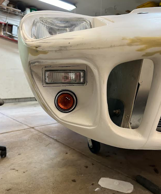

Holes are cut for the fog lights, turn signals, and head lights. Really happy with how they turned out.

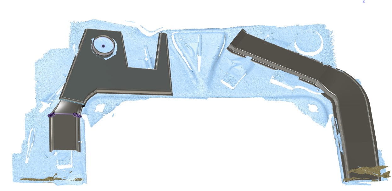

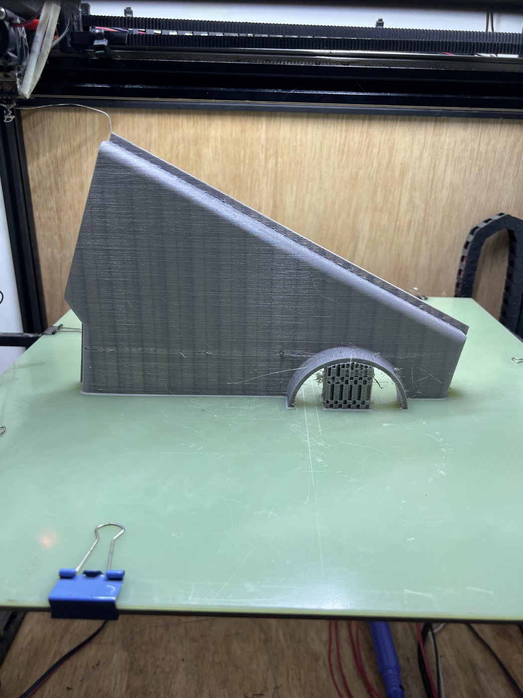

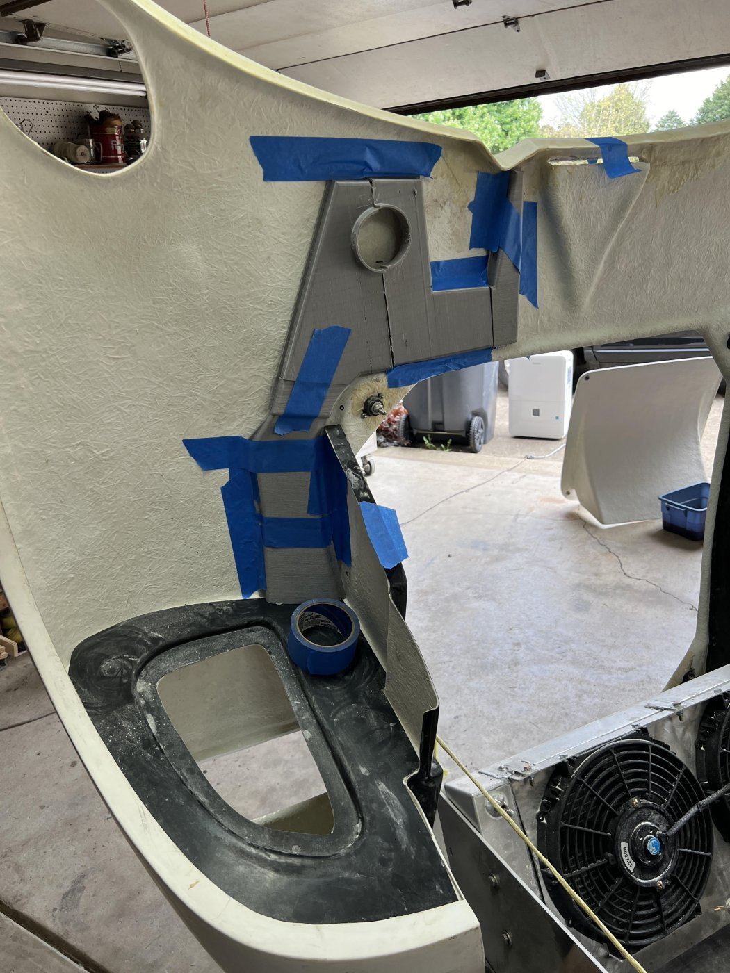

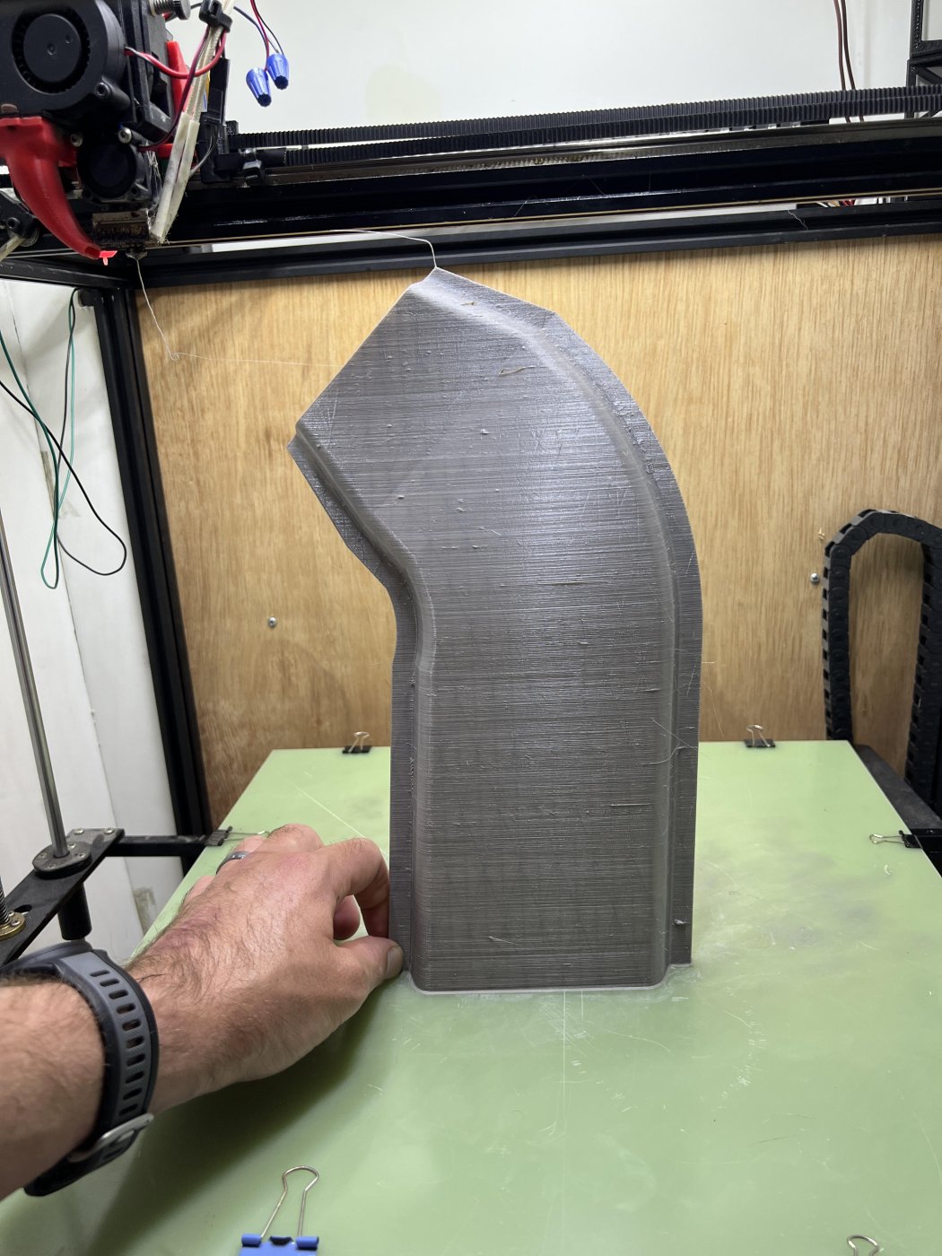

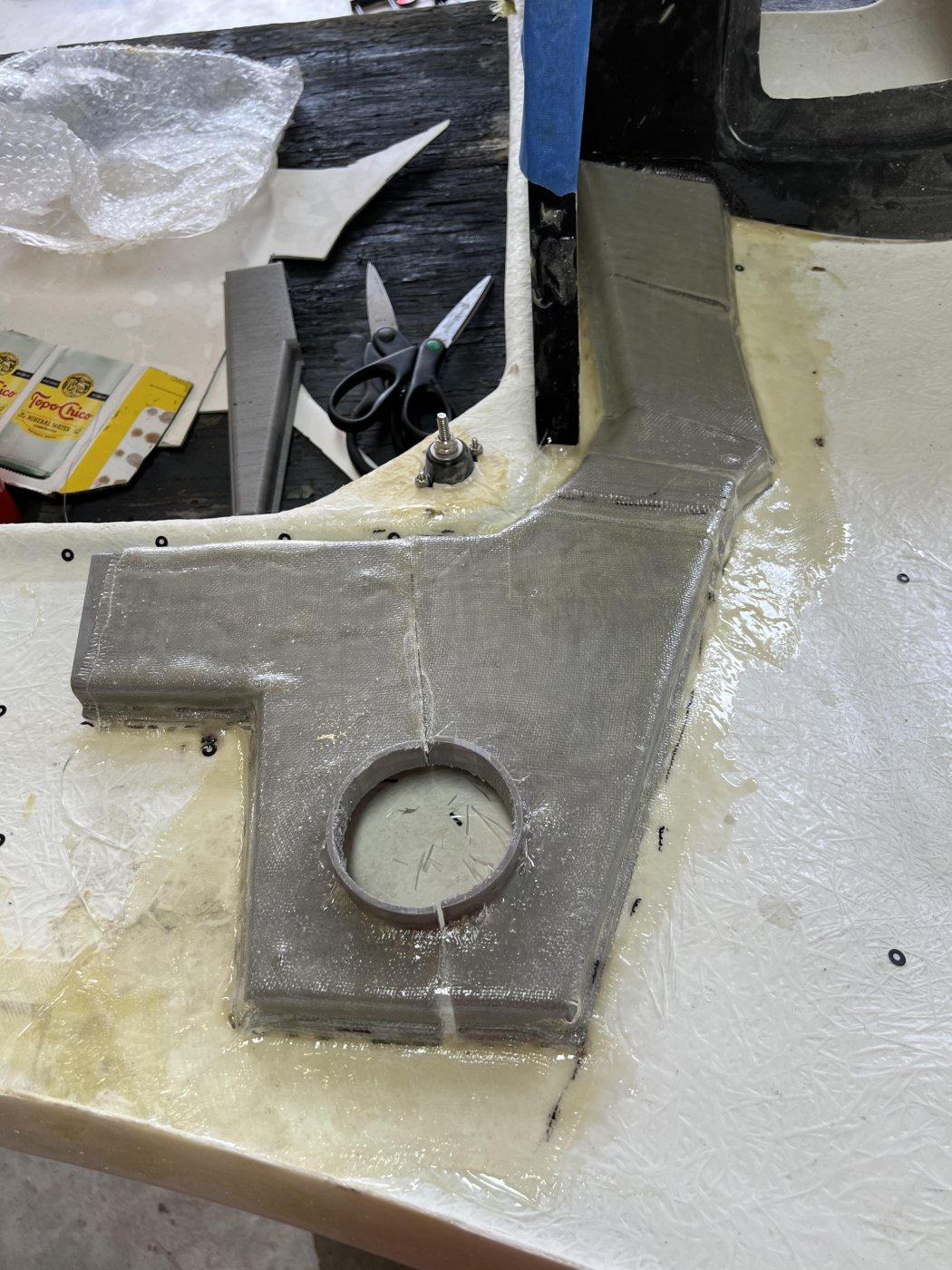

I decided to work on the interior air system a bit and add ducting to supply cool outside air from the three main exterior NACA ducts on the front clip. The method I am trying out is using 3d prints to fiberglass onto the front clip. Eventually I will 3d print ducting for inside the cabin too that will supplement some aluminum flexible ducting. My current plan is to allow the ducting to pass through the chassis at one point to feed one 4" in line electric fan blower rated for 285 cfm. I plan on having some sort of rubber boot at the chassis passthrough so the front clip can still easily be opened. I modeled some 3d prints with a 3d scanner I have which was quite helpful. Some quick fiberglass work will install the prints more permanently. My dad and I picked out some pretty nice looking chrome outlet bezels to install into the dash at some point. The 4" fan will be supplied by a 4" line and will push air through 2.5" hosing to some bezels. These seems to just barely fit the pre-molded positions in the dash: https://www.speedwaymotors.com/Vint...es-Tri-Bar-Louver-2-5-Inch-Chrome,420318.html

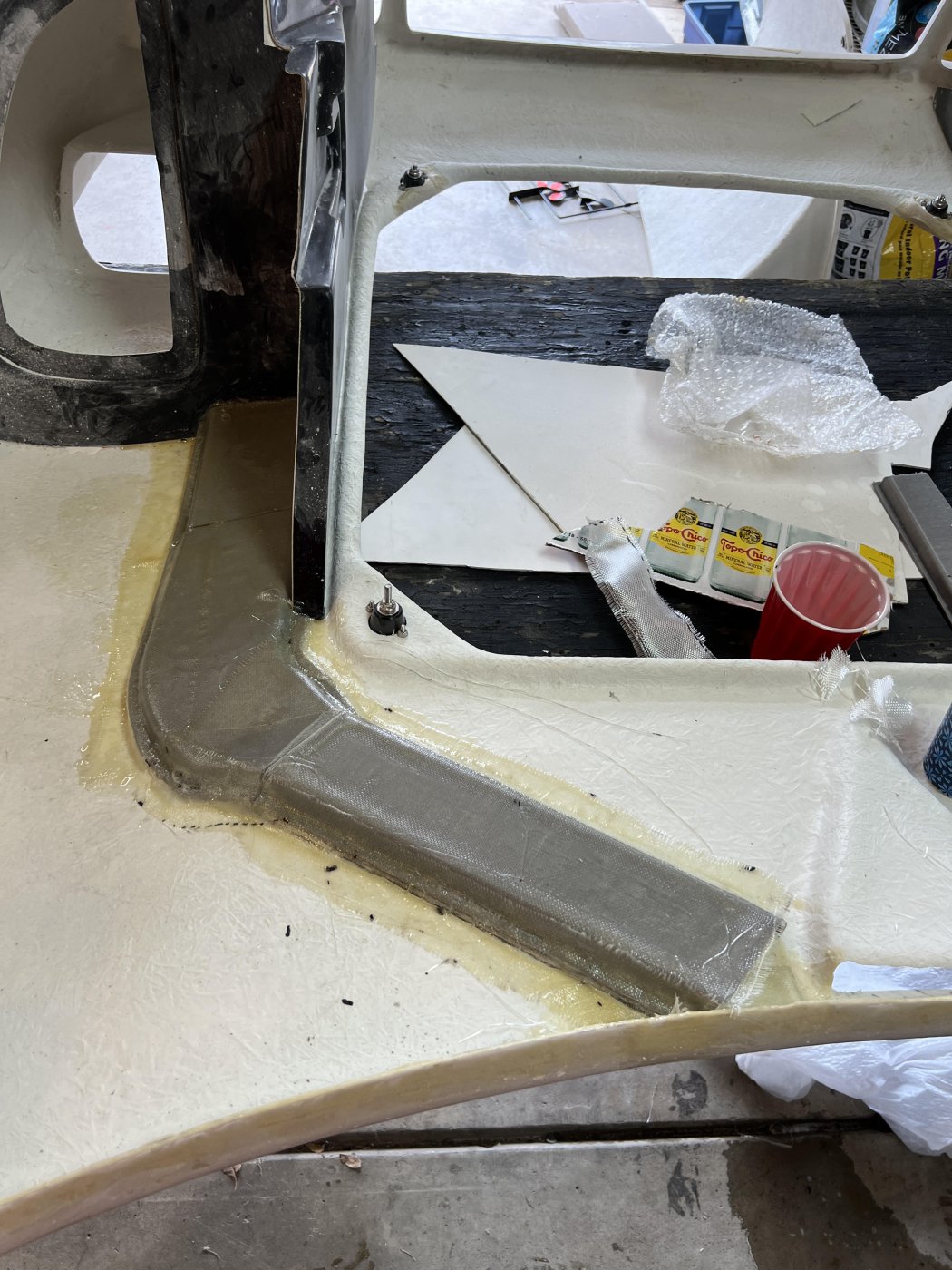

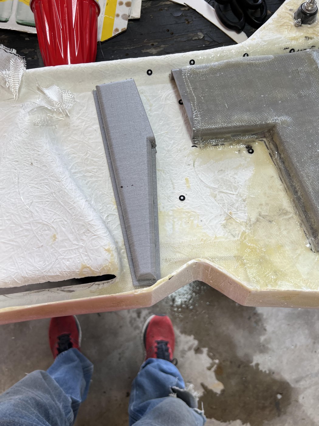

So my dad and I decided the 3d prints will work great and made the move to fiberglass/glue them in. I'm happy with how the ducts turned out I think they should work well. We can't imagine the effort involved in making these ducts without a 3D printer!

I need to re-design and re-print one part that connects the DS ducting to the center naca duct and ultimately the PS ducting. We decided I initially modeled it to be too narrow.

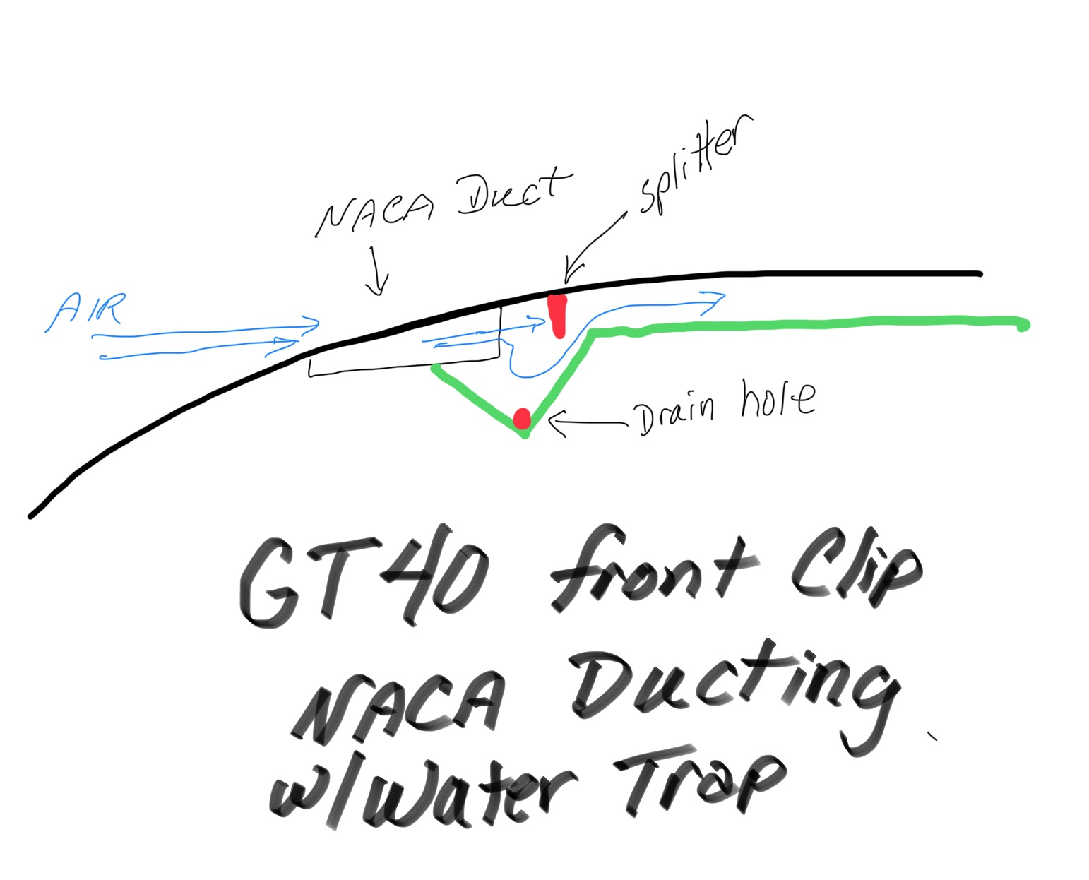

I made my ducts from flat-stock fiberglass, hot glue, epoxy resin and kitty-hair. The interesting part was designing the water traps so I wouldn’t be pushing water into the interior.

Looks good! I agree water traps are tricky. I am thinking about how to handle that now. I want the trap(s) to be easily accessible to be drained if needed. I may put traps under the dash in the interior of the car just before little air filter mounts, tbd on that though.
Rough drawing of my water trap using a splitter.
Yes, this will cut down the volume and force of the air coming through, but it’s probably not that substantial anyway.
Just have to make sure that you clear the front tires.
