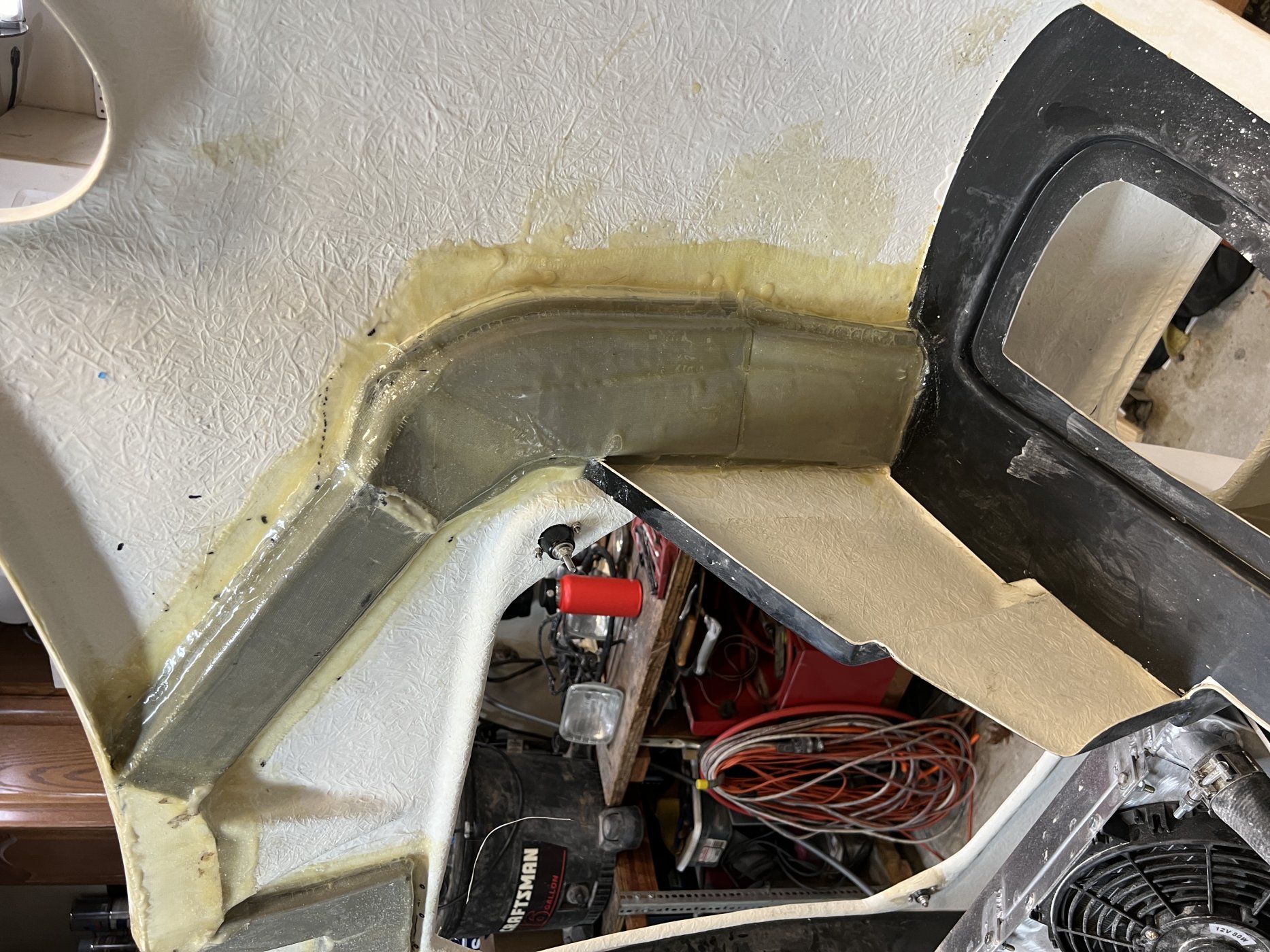

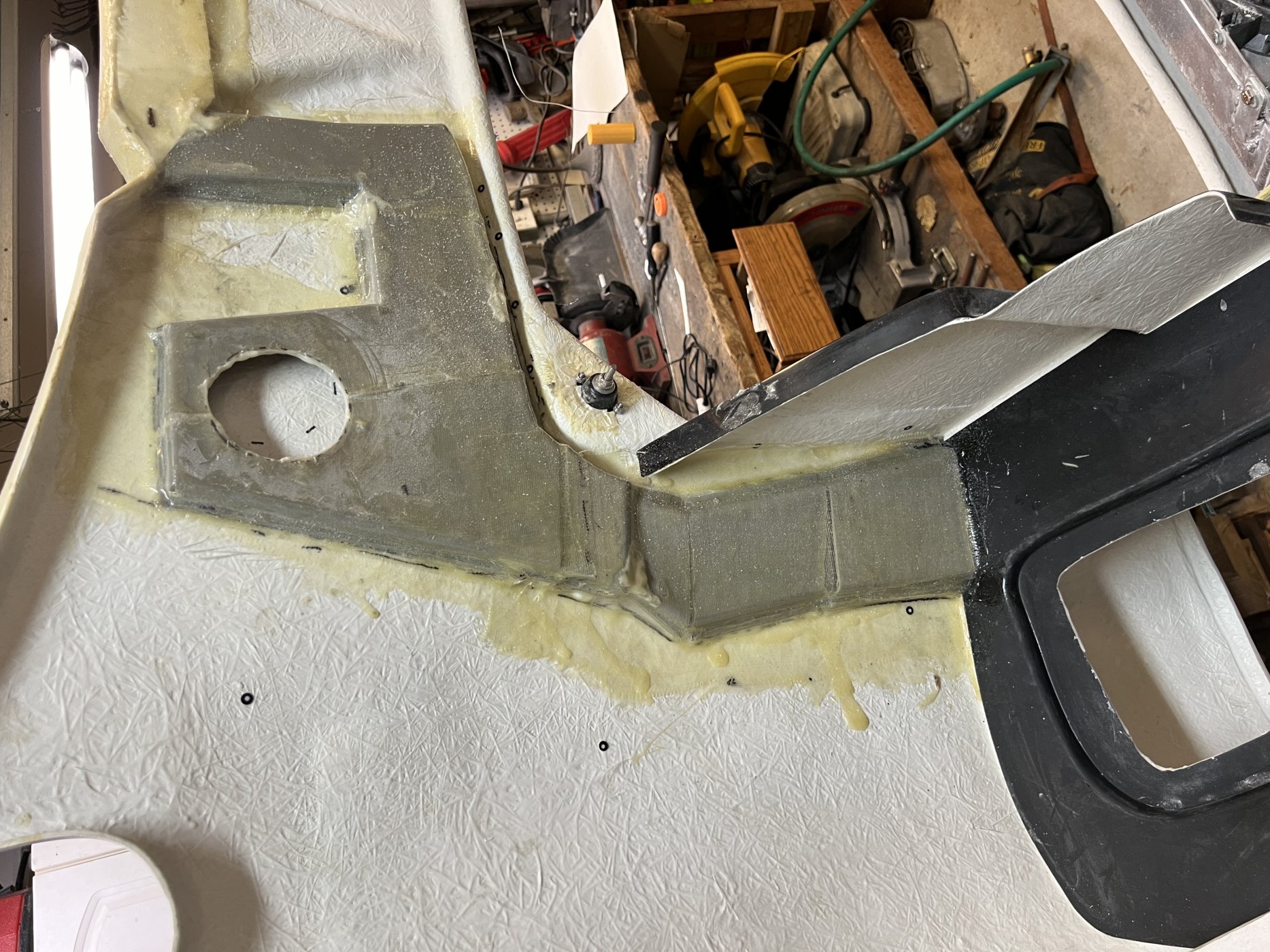

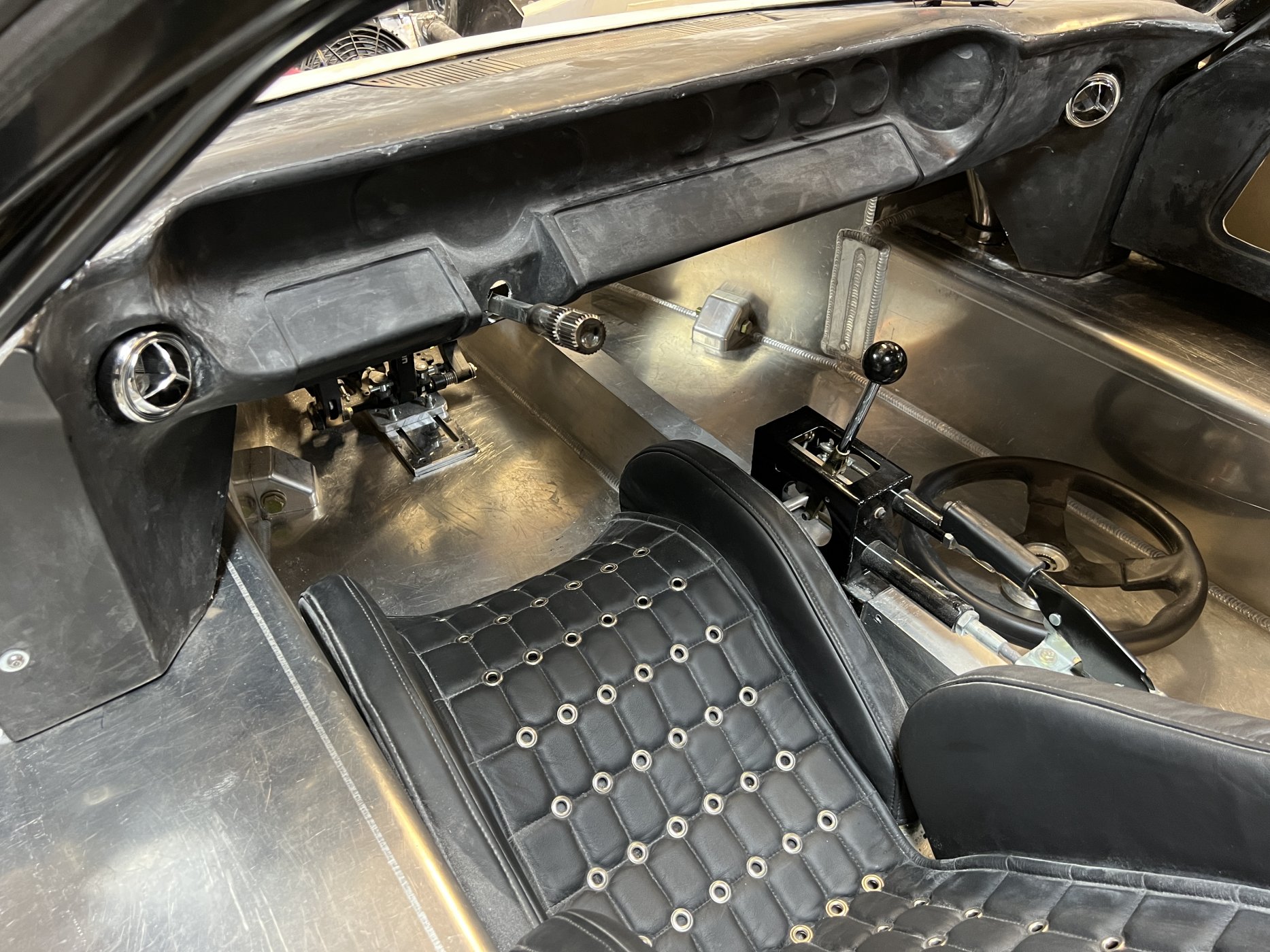

Well we seem to finally about be done with setting up air ducts to feed cool outside air through a fan and vents in the dash. The idea is to supply air to two "normal" vents mounted in the dash and the defroster vent for the windshield. Right now there is no way to select a defrost mode vs a "normal" vent mode, but we decided to try not adding some sort of device to "switch" the air direction. Maybe this is a mistake, but I think we will try it without a valve first. The three NACA ducts just combine into one port through the chassis.
Right now they look ugly, but function well. Eventually when its time to prime/paint we will be able to paint over the bottom of the front panel to clean this up a bit. Also this is tbd, but we might install some baffles to help fight unwanted water ingress, but the concern level right now with water is low because honestly hopefully the car is rarely driven in the rain.

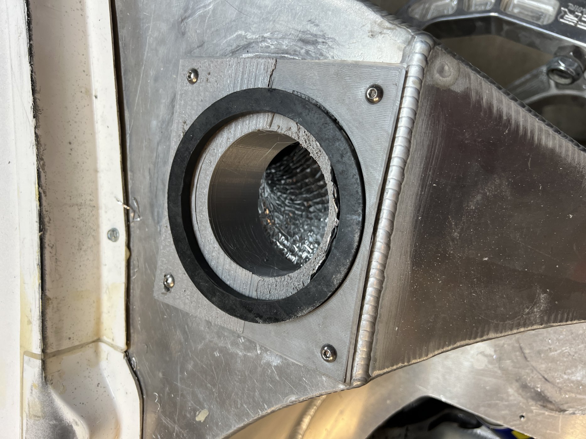

The three NACA ducts on the front panel will feed a port on the front of the chassis what will also feed an air fan. Unfortunately there isn't quite enough room to "sandwich" an air filter element in the port panel. The gasket we chose needs to be at a significant enough angle to eliminate any useful two part design for the sandwich idea to work out. Right now our idea is to simply wrap filter material around the exit of the port panel. As a result eventually I will re-design this part and re-print it with one piece as a two piece design is not needed.

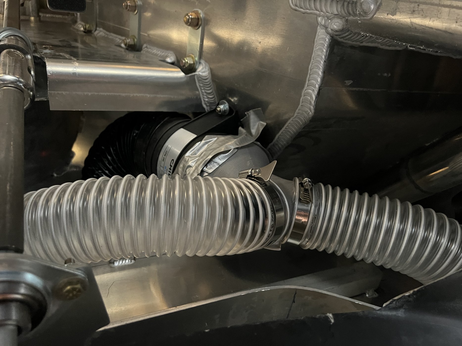

Here is the chillout fan bolted to the chassis. I printed a "Y" divider for the output to divide the air up.
We installed two pipe "T" sections to feed the defroster vent and maintain passenger vent airflow which worked out great.
These are the two ducts installed in the dash also. They fit well. My dad and I took turns sitting in the car with the fan turned on to test it out. The output seems to be plenty strong even split 3 ways currently.

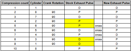

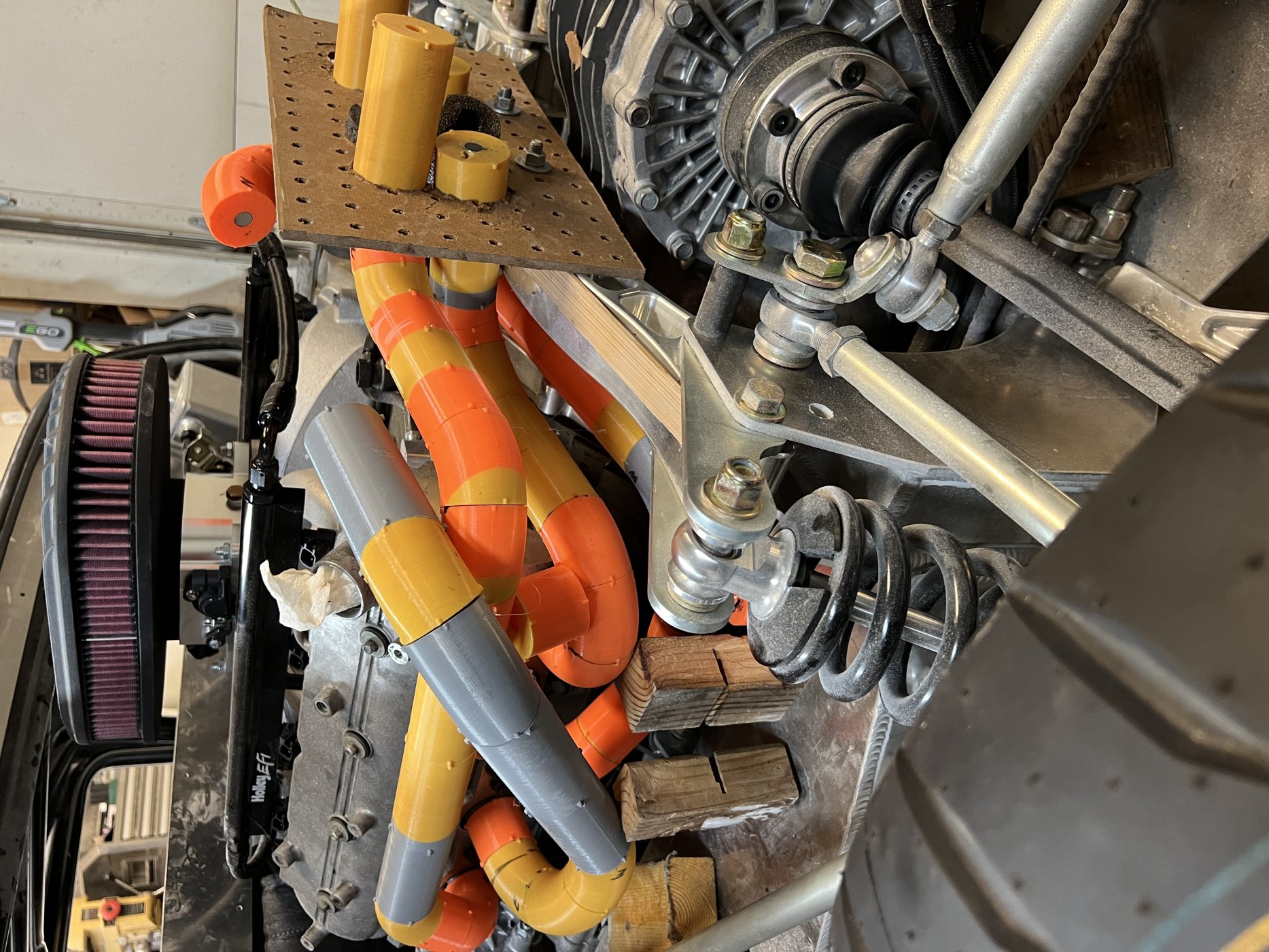

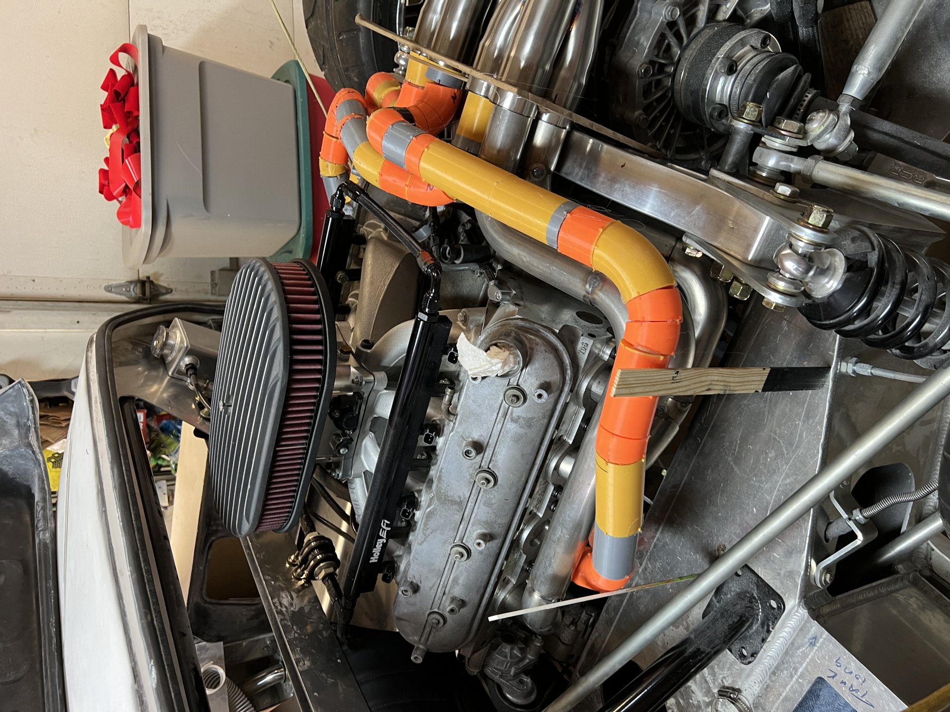

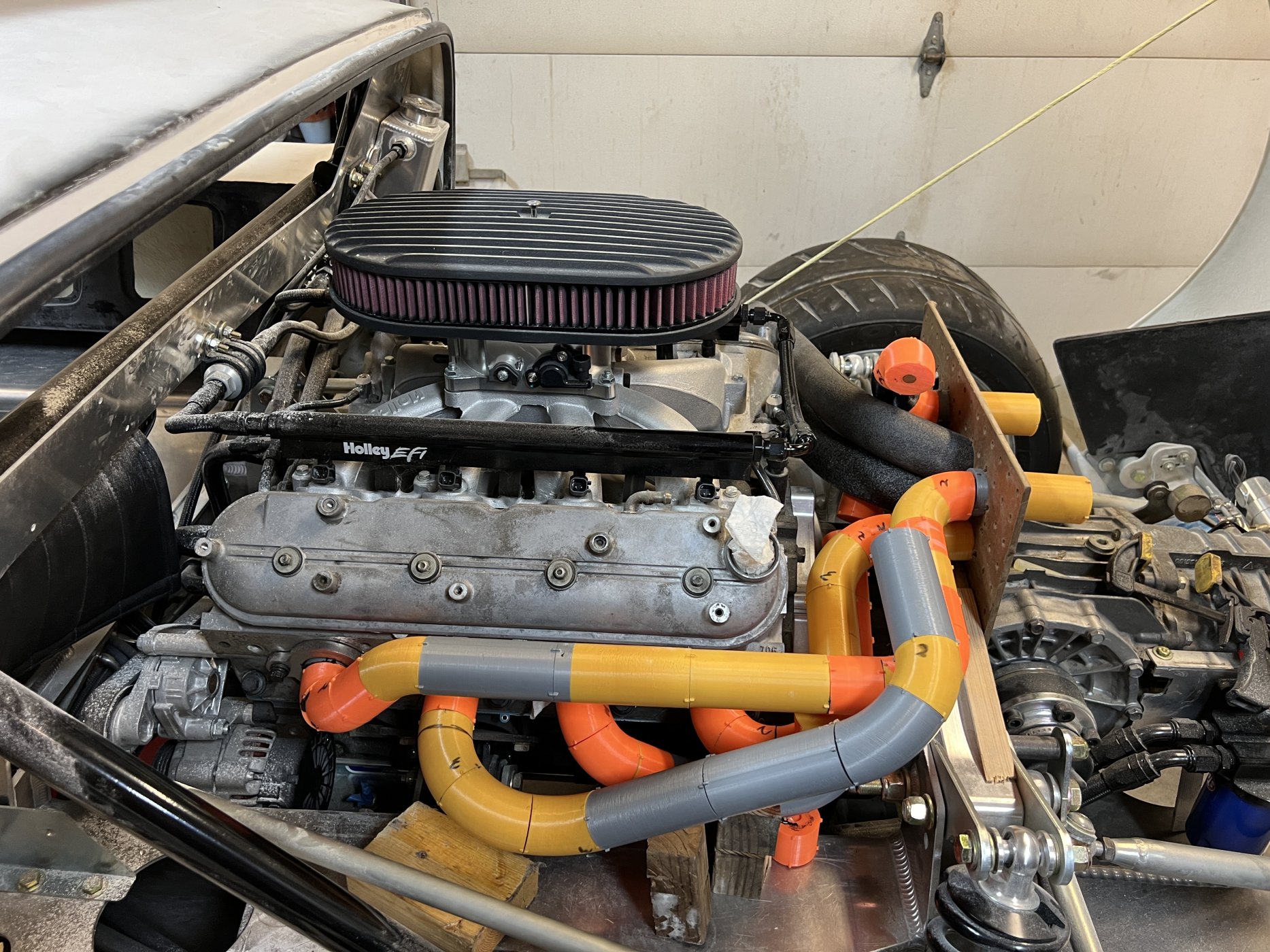

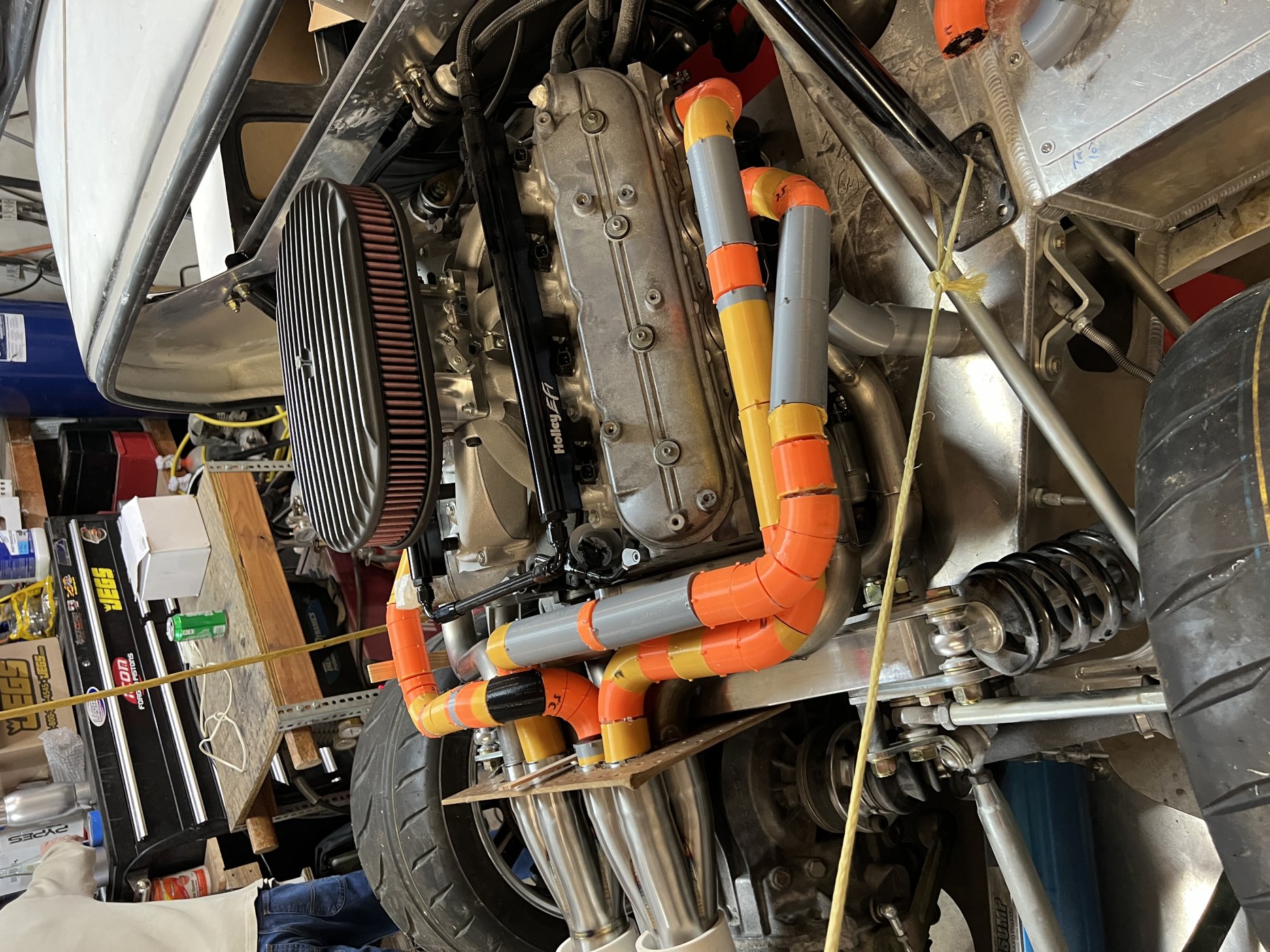

The next project on the car is to try and tackle the exhaust... my 3d printed parts are working great to mockup a pipe layout... but it sure isn't easy to arrange the exhaust in a manner that obeys the cross over idea I discussed in this thread a while ago. It seems the middle two cylinders from each bank need to exit out the opposite bank's collector. This is at least my current understanding of how to best design the exhaust.
Here are two images of where we are at with the mockup:
Right now I think we can get away with only 2" and a 3" CLR bends and obviously an assortment of straight sections. I am currently making some additional parts to finalize the cross over pipes, and then it will be time to place an order for stainless tubing. Currently our solution is sending one of the two middle pipes below the other tubes to cross over and one tube above the bundle to cross. We are still struggling to find a local source in Columbus Ohio for pre-bent stainless steel 1.75" diameter tubing but we will keep looking... otherwise we have to pay shipping which is fine. It's safe to say that "bundle of snakes" is a great name for this mess LOL.
Hi: Page 2 of my build log shows how the manifold looks on my car (RCR+LS7+ZFQ). It's a tight fit- including plug wires. It is entangled and both sides must be fitted/removed together.

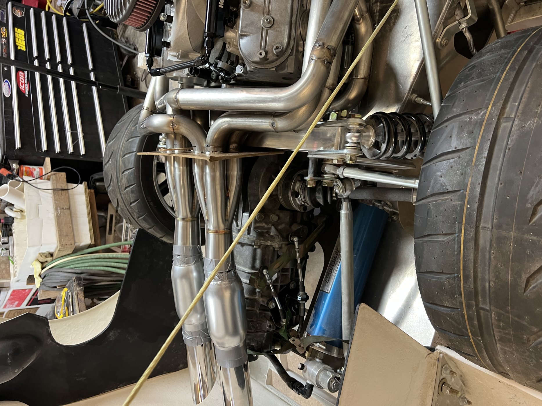

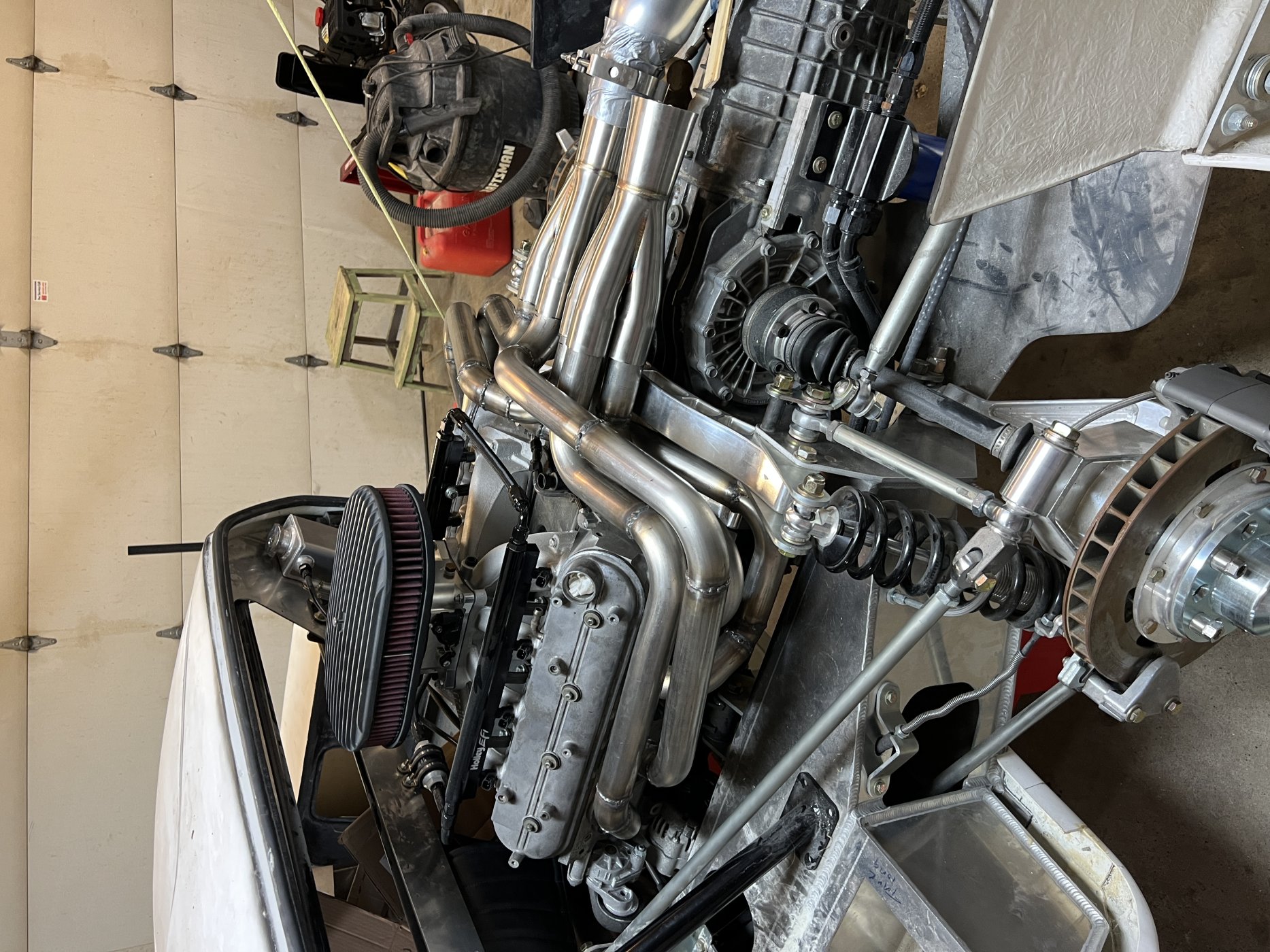

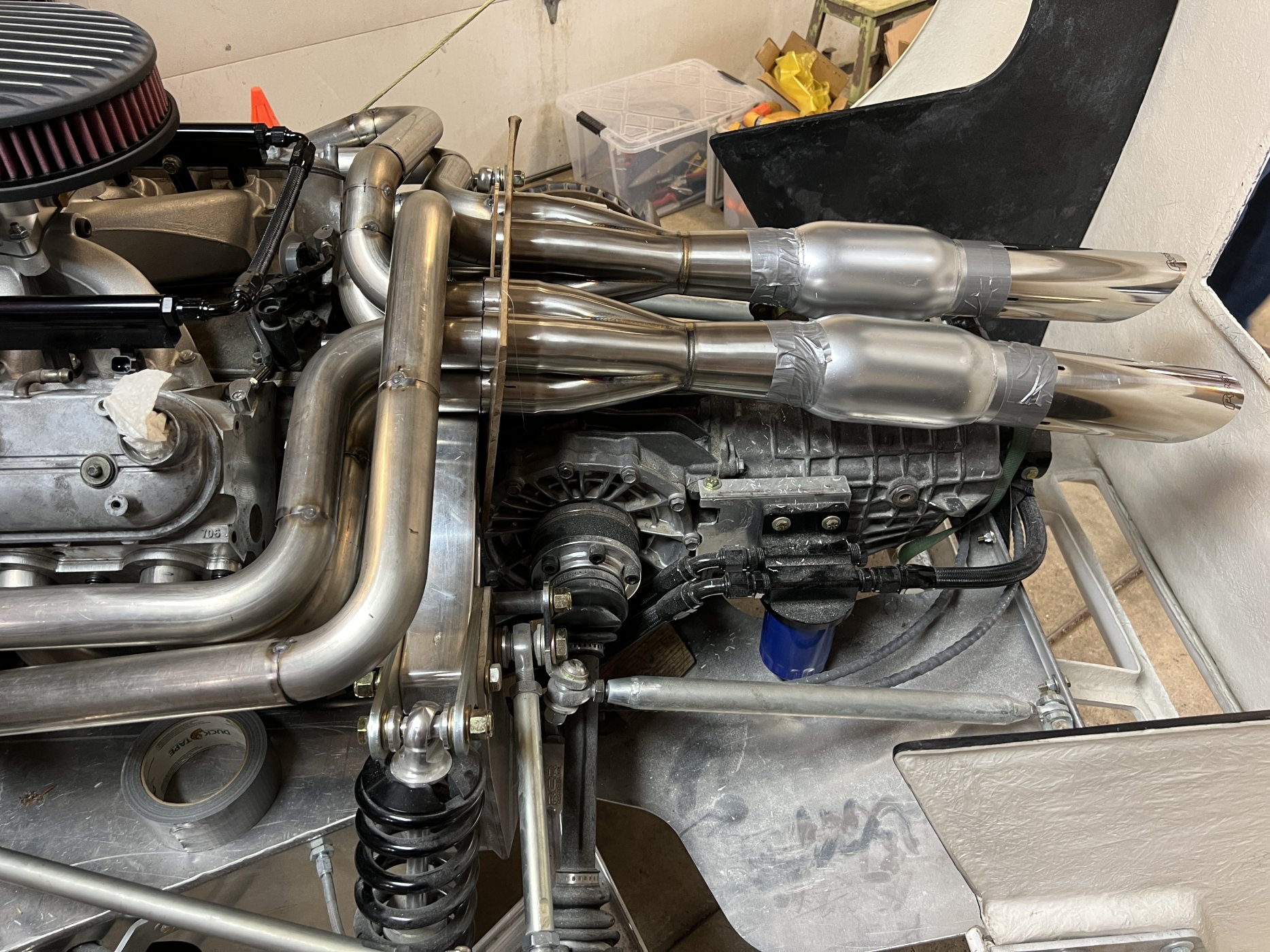

Well we finally made some progress on the exhaust. One set back was we couldn't easily source 2" or 3" CLR mandrel bends in stainless tubing. We have a Jegs in Columbus that offers free shipping but we were frustrated that they don't really offer 2" or 3" CLR mandrel bends in stainless tubing. Luckily they do offer lots of 2.5" CLR mandrel bends in stainless tubing. I printed enough 2.5" CLR bends to make something work. In all fairness the pieces worked great at first, but they didn't reliably hold their shape enough to justify welding steel up. We solved this issue with a tiny bit of hot glue lol.
I also seriously regretted not designing any text into the pieces indicating what CLR each piece what. I ended up having to print a "template" to confirm the CLR of each piece and just write on each one what was what lol.
See below for the finest stainless TIG welding spot welds you have all EVER seen. I've been TIG welding for 105+ years so I'm clearly an expert by now. JK I am not very good, but hopefully finishing these pipes up will help that LOL. We still need to weld on springs to hold the collectors up and weld in V bands on both sides of the mufflers. The V bands are important so we can still get the pipes coated as coating the inside of the mufflers would ruin them. Things seems to fit well so far, soon we will final weld them once spark plugs and wires come in to confirm they fit ok.

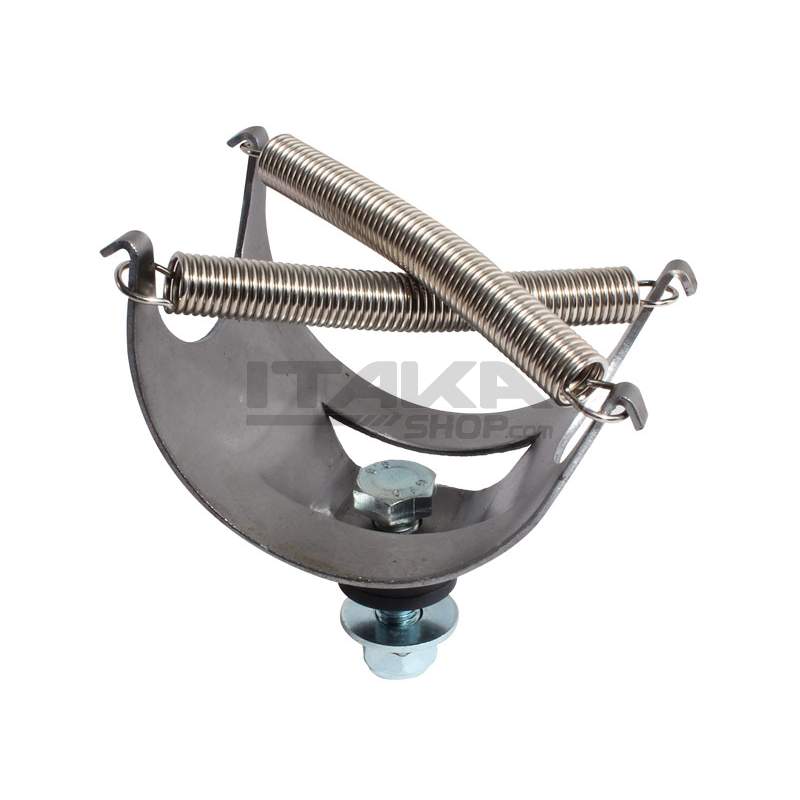

One element to go still is a "hold down spring" bracket for the ends of the pipes or mufflers. We will have to get clever with mounting it to the transaxle too.
We may end up doing some sort of "remote coil mount" set up so we have options for how to run the wires.
Pipes are 304SS and the mufflers are 409SS. The local welding shop had suggestions for the best way to weld these together.
The pipes collect down to 2.5" I believe and expand to 3". The theory there is it will aid in gas extraction if you believe anything Bernoulli says but I never found any definitive proof or papers on the concept... we made the cross over theory work despite it being quite a pain. It will be worth it for that sweet GT40 sound though.
I went in 1.75" diameter tubing as from what I read it was advantageous on an NA LS motor.
P.S. for the price of a store bought mock up kit, you're better off buying and small 3D printer and downloading CAD. The parts sure did the trick!
Regarding the exhaust support bracket and springs, do you have any Karting activity near you? Karts use brackets and springs that are perfect for the task and can be bought off the shelf from karting equipment / parts suppliers

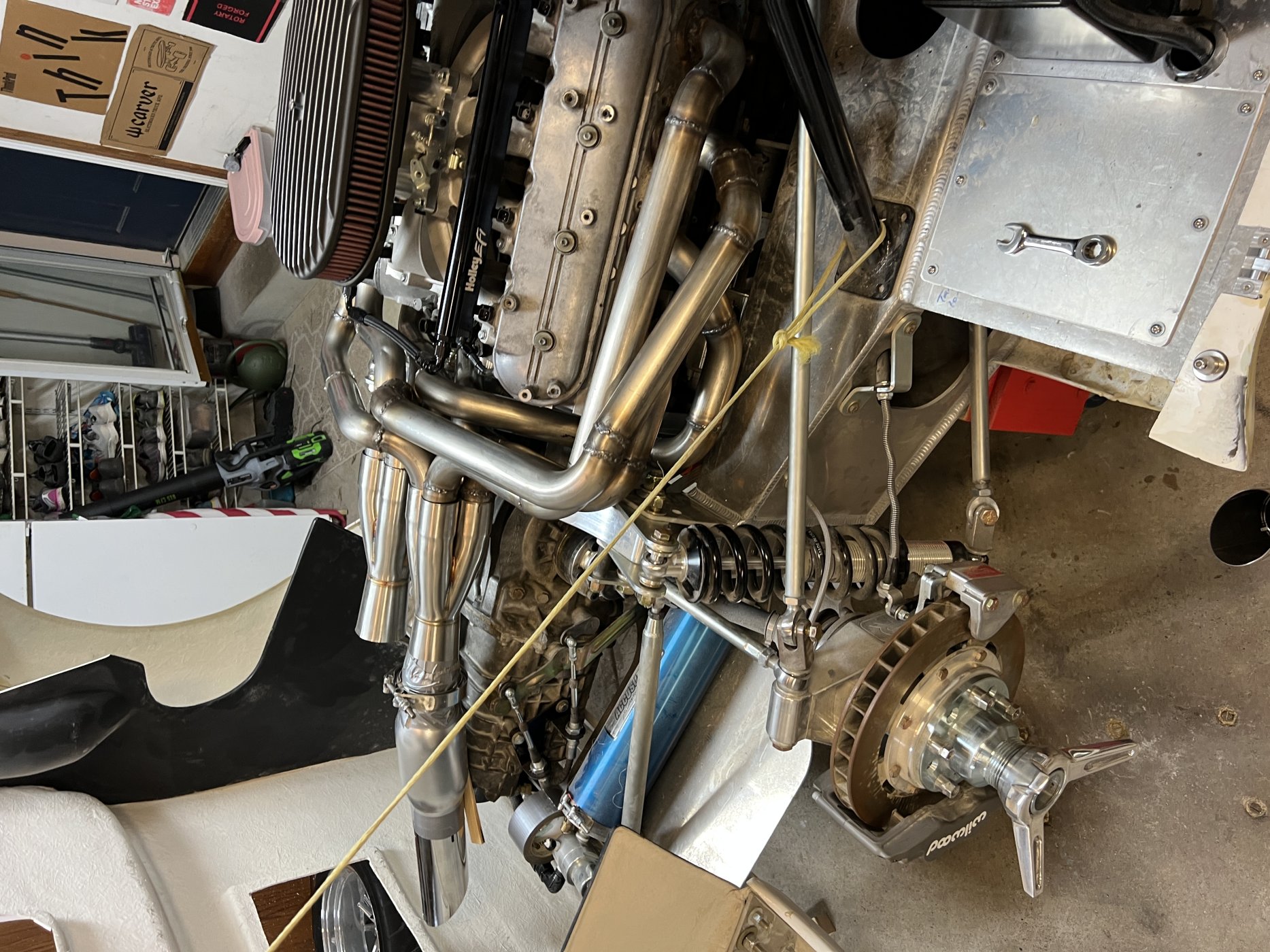

FEAST YOUR EYES ON THE FINIEST TIG WELDING TO EVER BE COMPLTETED IN THE NATION!!! I'll weld your exhaust as well for the measly sum of $1,000,000 a minute, (travel time is charged still). I just need to find time between the many trips I promised to SpaceX this year already to put my TIG welds on their rockets as well.
JK holy cow is TIG welding hard LOL. Turns out I had it in my head backwards on what part would be easiest/most difficult. I figured that welding the tubes together would be hard and welding each tube end to the exhaust flange would be easy... SO WRONG lol. Turns out that the large thickness of the flange compared to the tube gauge made welding much trickier and sure exposed my honestly 1st grade level of skills. Well after many days, several mistakes, and foul words... we finally prevailed.
We still need to put the finishing touches on the exhaust like welding on the mufflers/tips/v-bands and O2 sensor female bungs. But at this point it is quite the relief to see just the primary exhaust system fully welded in and installed. This self built exhaust may be one of the most difficult thing's we have ever completed lol.
For those considering your own self built exhaust, some tips:
1) when welding each tube into a thick header flange, be sure to clamp down each end of the flange to a flat surface. The heat from the welds will quickly try to warp and ruin the exhaust flange. We caught this just in time and it was quite alarming lol.
2) Whatever time you budget to complete this, double it lol.
Up next after finishing the exhaust will be figuring out how to coat them (maybe jet-hot ceramic?), and then wiring everything along side finishing up the body.
