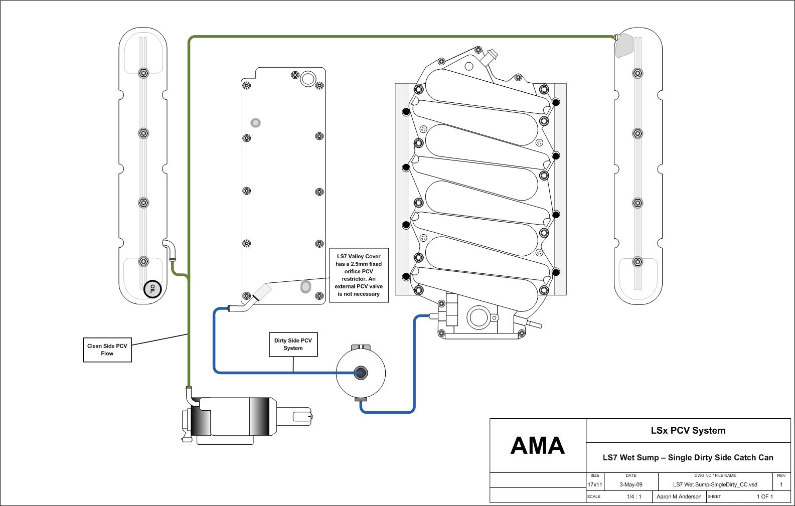

The first place to install one is shown in the following picture. This is the most important place to install it. It's called the "dirty side". 90 to 95% of the oil found in the intake manifold comes from the "dirty side".

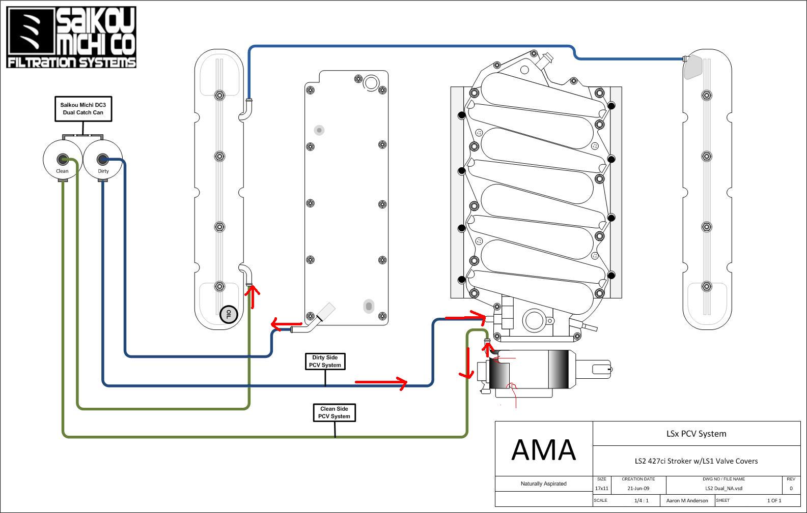

You can take it a step farther and also install one on the "clean side" as shown in the following picture. Most people that install one on the clean side report that not much oil is caught in the can. Only 5 to 10% of the oil found in the intake manifold comes from the "clean side". You can just buy two Elite Engineering cans or one like shown in this post that has dual cans on one bracket. (Ignore the LS1 valve covers with the second port hooked up to the other valve cover)
The Mighty Mouse system is currently the cream of the crop on Corvette Forum. If you want to save a couple of bucks, they come up used on Corvette Forum occasionally. I personally just recommend a Elite Engineering can on the dirty side as shown in the first diagram if you have a fairly mild engine. If yours is boosted or very high horsepower than the Mighty Mouse Solution might work better due to the higher blow by from the cylinders.
