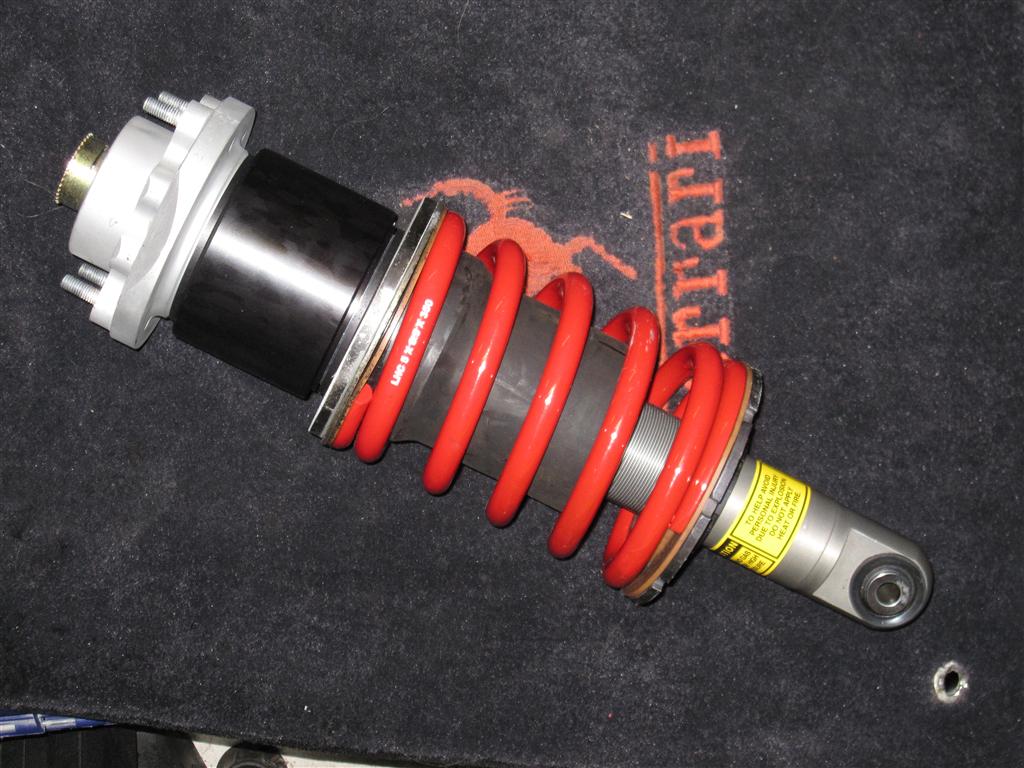

Back on topic, can the ram be fitted upside down on the upper perch above the spring so it's sprung weight instead of being below as unsprung weight?

Ben, I had to mount mine below, because I had clearance issues with the upper sway bar blade that I'm using. Otherwise, I would prefer to have it on top as well.

As you can see, the blade runs very close to the upper shock/spring. The RamLift is a bit wider than the spring & perch, so I needed to move it down. I believe that the SLC offers plenty of room for you to mount as you see fit.

I was initially going to mount mine with the rams on top, and I think RamLift Pro actually prefer it like that with the pistons pointing down, as there's less chance of debris getting into the system.
The final iteration will probably have the rams on the bottom, only because of the application and trying to gain as much suspension travel back as possible. The pic below is of the not-so-pretty prototype that I built. Since then we've reduced the number of adapters and perches and machined down the top shock mount, and hopefully have "found" at least 1 1/2" more travel.
This wouldn't have had any effect on the sprung vs unsprung issue, however.

My rams are on top of the springs with the bleeding port at the top. Works great this way makes it much easier to bleed.
Hey Stig, did you try mounting the shock assy inverted? I was shooting for that as a possibility putting your package together. I think the ram may clear the sway bar arm. We can get you some modified arms too to make it work. Might flip one side over to try it.

Hi Ted,
I assembled the shocks (inverted) with the Ramlift at the top. It cleared with about 1/16". Any movement would have the arms and the springs in contact. I have the connector rods extended about as far as I feel comfortable with. Still tight. Modified Arms may be the ticket. I'll take a couple of overhead pictures to give you a better view.
