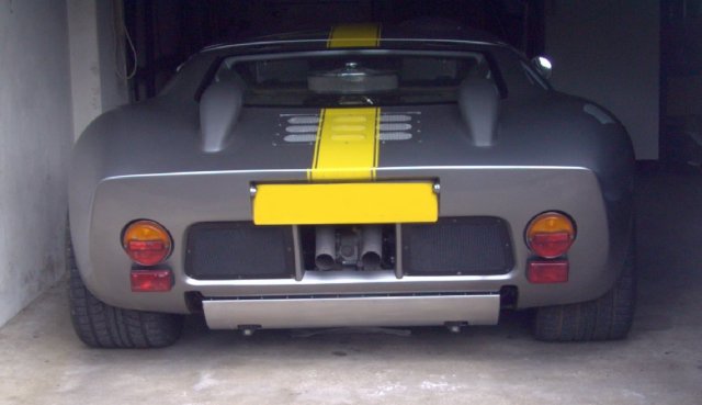

My RCR uses an aluminum panel
Re: Any ideas GT40 lovers!!!

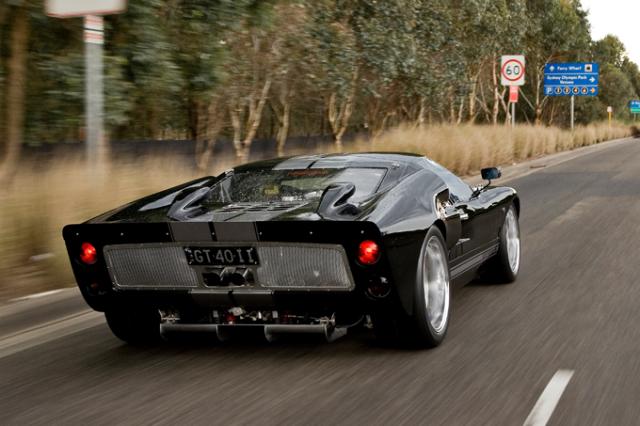

Bernie, hopefully Bobski may be reading this I had a good look at his RF at the Cobra Nationals the other week, he has a nice rear defuser on his car maybe he will post a pick. I ment to take my camera but I left it safely at home as usual.

I found more pics for you Bernie;

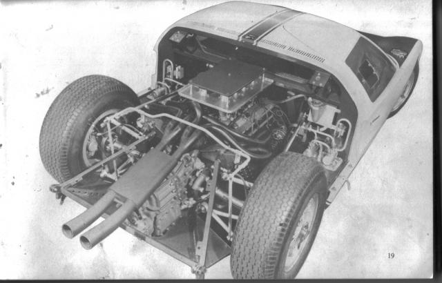

You should look over Eglitom's build thread. He made a really nice framework for his in the rear..

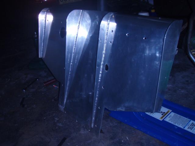

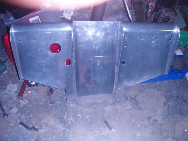

Hey Bernie,
Here's a photo of the rear of the car, (that's all I can find at the moment) it's not the best shot and I'll take some shots tomorrow during the day.
The diffuser was designed using a program (?) that helps design airflow around the car and undercarrige. My mechanic got one of his mates to design it and we made it fit. The two outer trays are angled at 8.5 degrees I think and the middle one is angled at 14 degrees. It dresses the rear of the car nicely and going by the program possibly provide some downforce.
I'll post some more pics tomorrow.
Bob

Hey Bernie,
I have received your PM and I can still email you some more info or photos if you require.
I needed to take the rear panel off to get to the gearbox as I was left stranded on the weekend because some lazy bum decided to install a pin in the selector shaft which was too short and it snaped. Luckely it wasn't too deep inside the gearbox and was fixed without removing the box from the car. The good thing is, it's all fixed and gave me a good oportunity to take some shots of the rear diffuser.
