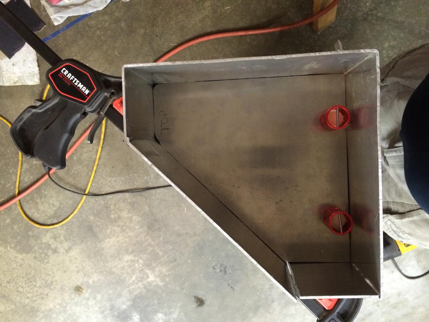

I'm currently installing an in-tank system in my SL-C. The fuel pump assembly is from tanks.com. This fuel pump setup is nice because you can use the fuel tank as is and simply cut the required mounting pattern in the top surface of the tank. I've cut my tank apart though and I'm installing fuel safe check balls in a new baffle wall.
I'm using the GM style filter/regulator which I will mount above the fuel tank.
