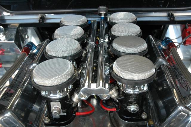

I ended up putting air filters on my cobra's motor.

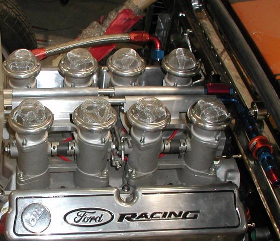

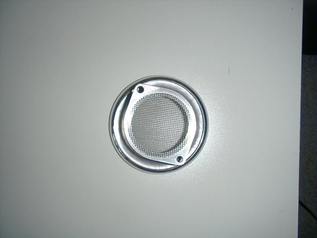

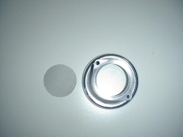

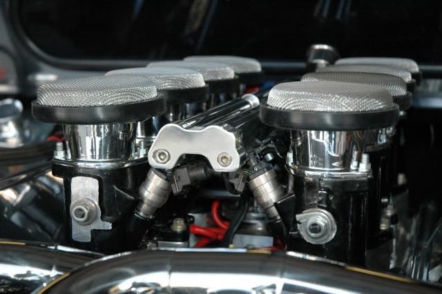

We have filter screens we sell for our injection (TWM). The weber type with the 2 screens and a layer of foam were to restrictive. When we ran them on a dyno there was a 80 to 100 hp drop with the weber screens. The ones shown in the attachment are 2 layers of screen that keep out most things we come across while driving. I don't drive my car in dusty environments anyway, and they are easy to clean. The hp loss on a dyno is almost nothing. On the TWM airhorns we have machined a 40 thousanths deep, 1/8 inch wide groove in the mounting flange of the airhorn. We put a piece of round #14 304 stainless mesh in the groove and bolt the airhorn on. We can put another round piece of mesh inside the airhorn on top of the secured mesh. This filters and does not detract from the looks of the airhorn. More ideas, hope this helps. Al

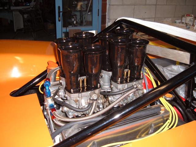

Looks pretty nice, but those screens could be OK for IDF, not IDA, which I believe back fire type of trouble needs to be considered??? Any feed back can be appreciated.

Here are the pics of the machined airhorn.

Yuji, Are the horns too close together on IDA webers? If so the screen maker said that he could make a one piece retainer to retain 2 screens if there was less than 3/8" between the horn tops.

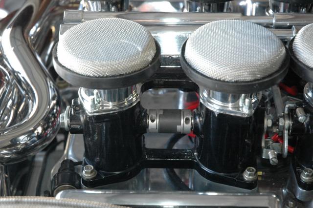

I'm in the process of ordering parts to copy Rob's (Vintage Venom) screens using 2.5" Tea Infusers and rubber rings cut from a steering rack boot...

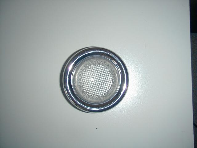

Here are the generic tea strainers. Just Googled the word and order the ones that fit the opening. they come in different sizes. You will have to grind off the handle or the locking mechanism that hold the two sides together. Then you have several methods of attachment. I drilled a hole and used small pop rivits to hold it on. The ones that Al showed were not available when I did mine. There is a thread here somewhere on the tea strainers or filters. I plan to add a filter(black scruffy) along with SS mesh in 1/4" vacumn hose to the side vent entrance to the rear clip, and I don't plan to do any off roading either. Guess when I get the time(read money) I will go for the TWM filters

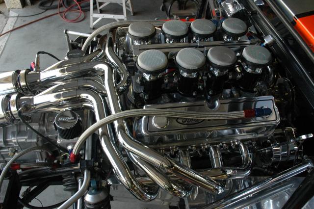

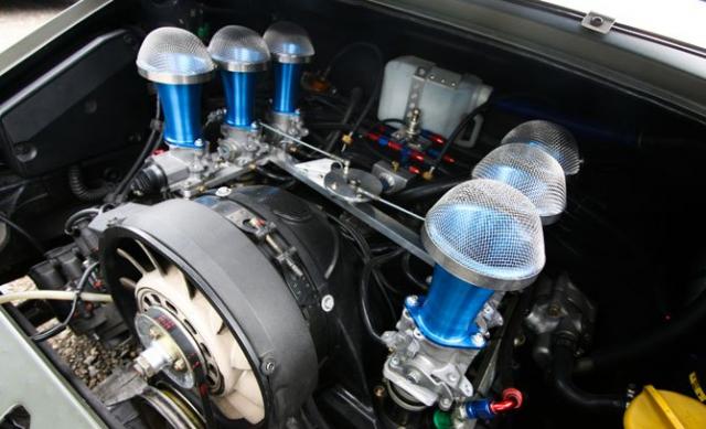

Tea Strainers are the go. I bought 8 small glass infusion tea pots from the local bulk retail`warehouse` for $6.00 each. These have a removable formed round fine mesh cylinder approx 65 mm in dia and about 75mm tall which gives a very large surface area. I moulded a tapered cone flaring out to these filters then out to a larger trumpet, fully protecting and hiding them from view.

I' was reading to this interesting tread and did contact Mc Trumpet regarding the screens. Bildergalerie
Unfortunately he does only sale screens with a diameter of 74mm.
As you all know the standard diameter for 48IDA stacks is 70mm they would not fit.
The solution would be to buy new stacks with the screen already attached (74mm). :thumbsdown:
