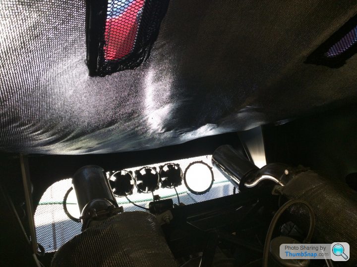

Not in an SCL, but an idea:
This is a solution for under bonnet temps, but I don't know how well it would work for an SLC. These are three small SPAL 4 inch fans ( 30103009) mounted inside the rear grill. They are controlled by a Flexlite Variable speed controller (31165) and a temp probe. The small box just below the fans is a backup camera and not part of the fans. Note the thermal barrier lining the bonnet that protects the paint of the overlying body. This seems like it would be very beneficial if you got off the freeway and got caught in slow-moving traffic.

Wayne has two 5" SPAL fans located on the under tray in proximity to the exhaust
manifolds, blowing straight down. It works extremely well.
