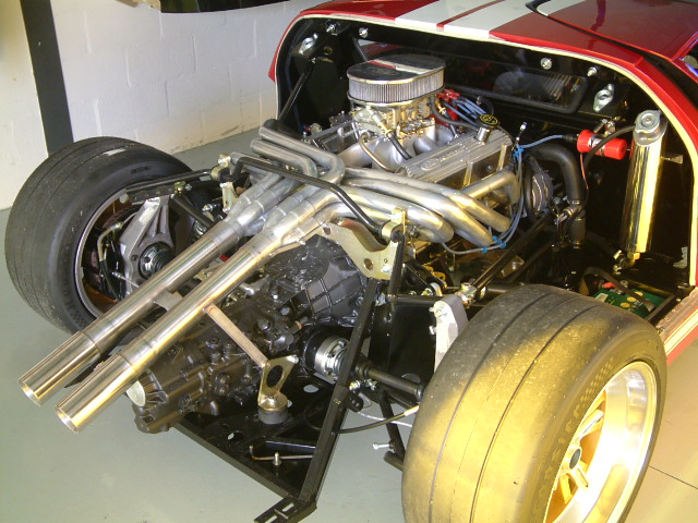

What 4 barrel intake manifold fit the best on the CAVs?
I'll be using a Ford 289 with a Getrag 016 trans.

Hi Rich,
I'd lean towards a low rise dual plane intake in that combination. Lots of bottom end torque, good clearance to the glass as well.
The engine sits higher in the car (any brand GT40) when setup with the Getrag transmision as the input shaft goes in above the diff rather than below as in the ZF application.
Edelbrock RPM works just fine...see attachment.
