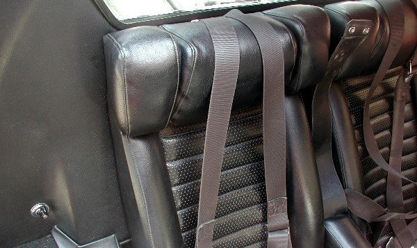

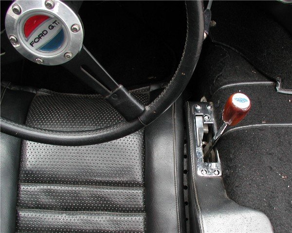

Pedro
That’s for the race-cars, right? I’m looking for the material used on the road cars. Pictures of road car interiors all look like black leather, but Rick indicated the inserts were a type of embossed vinyl.

I appreciate the input and pictures. Still looking into this, but I’ve read that the Europa used as basketweave vinyl insert (although I haven’t confirmed).
Pedro and Rick, do yall know what pattern was used on the 40s? The pictures look more like they’re just perforated, but I’ve never seen in person. Also, was just the insert vinyl and the rest leather, or was everything vinyl?

I don’t have much information about the seat material just the pictures I posted, these pictures are from Barry Simmons original car that were posted on this forum a while back, I believe that Barry is a member and may be able to answer a few questions.
Hope this helps
Pedro
