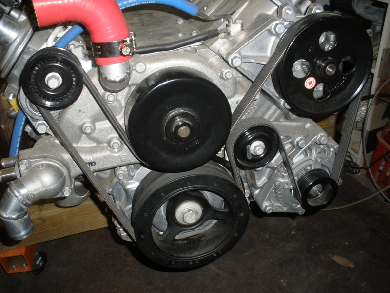

Doug, the LS water pump inlet/outlet can be modified too. Simply pull/cut the tubes, reposition and TIG them back together. Saves a few $$. I believe that RCR has the
air con compressor bracket available (check with Fran). I used a Katech tensioner, an idler, modified alternator bracket (needed a small spacer) and did my own LS 3 waterpump (on my LS1) mod for under $200.

Do you have a picture of your accessory drive setup?
Molleur,
Sounds like you did a nice job!
Do you have a picture of your modified water pump? How about of your accessory setup before the install?
thank you,
Doug

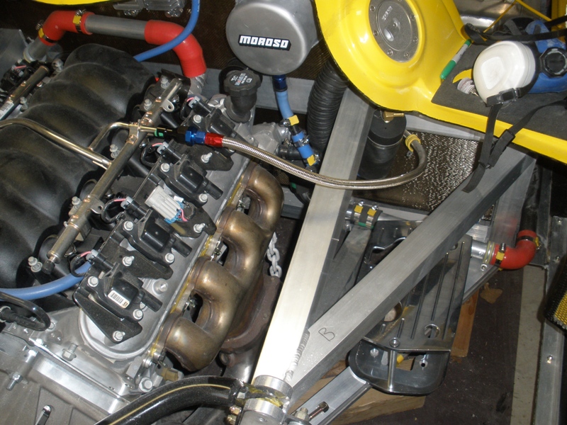

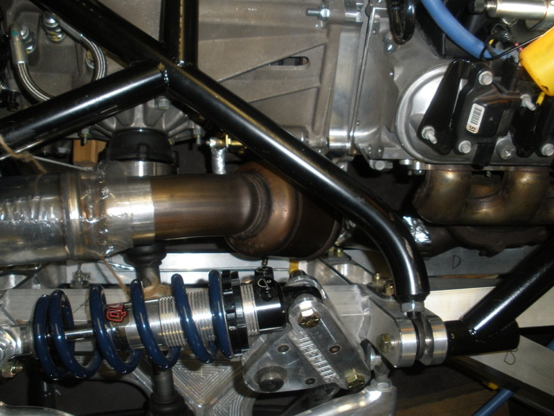

Hi Cam,
Appreciate the pictures!
Are you using an accusump or dry sump? Or not doing many track days?
Which idler is the katech?
Is that a CAT behind the LS9 manifold in the third picture?
Doug
