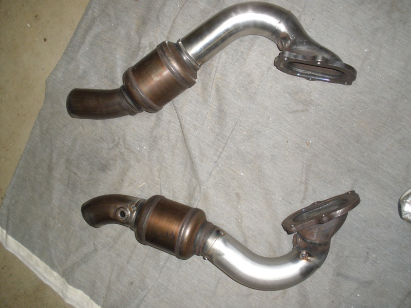

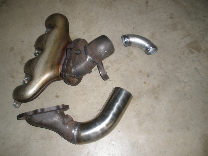

Are you using an accusump or dry sump? Or not doing many track days?
Which idler is the katech?
Is that a CAT behind the LS9 manifold in the third picture?
No accu sump, stock ls376 oil pan. I run it 1/2 quart high +zddp. i've done 5 or 6 track days with it.
No idler, thats the stock chevy power steering pump from the accy kit with the impeller fins removed. Then you can use the stock belt.
those are standard z06 take of manifolds, collectors, cats. I turned the collectors up with a few parts from 2 j-bends into magnaflow glass packs.
The sound is awesome even with cats an no x-pipe.
