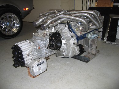

Having just completed the inversion process for a /2 box, I may be able to help. I found a lot of information about the inversion process and Lloyd at RBT was very helpful. I also purchased the ERA assembly manual for their GT40, as it explains the entire process of inverting the ZF and also explains the differences between the various types. ERA can help with the slave cylinder and mount as well as the throw-out bearing kit which includes the throw-out bearing, bearing carrier, and pilot bushing. You can view the ERA manual for free on their web site but the pictures are deleted. By purchasing the manual you can view the pictures as well. Hope this helps.
