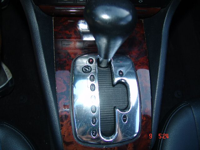

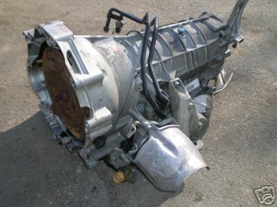

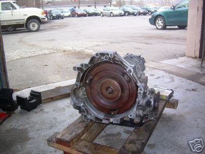

That doesn't matter to you guys, the 5HP19 would be best. It has the same bolt pattern as the Audi manual transmissions, so you could probably use a Kennedy type engine adapter, but still might need the crank spacer to fit the Audi flexplate. Mine basically just looks like a short thread spool (bobbin?) with the Ford crank holes drilled in one flange and the Audi holes drilled in the other flange. Don't have a picture of the flange, but I do have a trans pic from the Ebay auction. Also a shifter pic from an 00 01 Audi A4.
